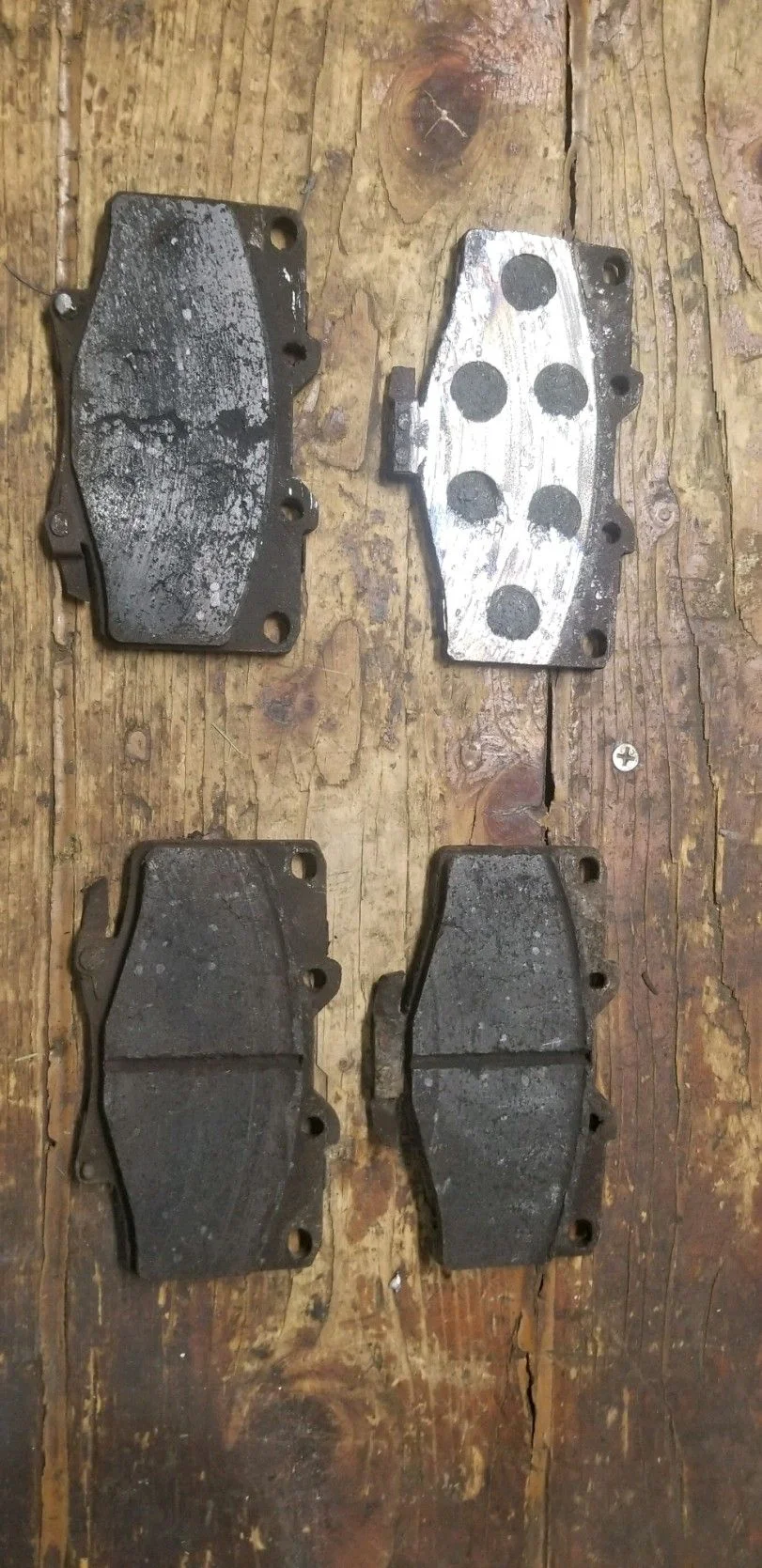

Here's a pic of the pads. Top are drivers, bottom pass
Pads getting worn down like that would be indicitive of at least one sticky piston on the caliper.
Follow the rear brake line off the axle to see the proportioning (load sensing) valve. It is close to center in front of the rear axle on an FJ62. When you lift the truck without making an adjustment (such as a spacer the same height of your lift from the axle bracket to the arm), the brake system "thinks" you're in a hard stop without much weight over the rear axle, and reduces rear braking pressure accordingly. It's like mechanical ABS for the rear axle. Did you also bleed the proportioning valve?
FJ60’s don’t have an LSPV on the rear axle. They have a proportioning valve under the brake master cylinder. It is non adjustable.
With only one pad wearing like that I’d take a good look at the caliper. Replace it if it has an issue. While you’re doing that do the other side too. Brake work goes in pairs. I’d also inspect your brake lines to make sure something is not damaged and restricting one of the front calipers. Don’t limit the possibility of a collapsed hose either. If the rubber brake lines are old, replace those too.
