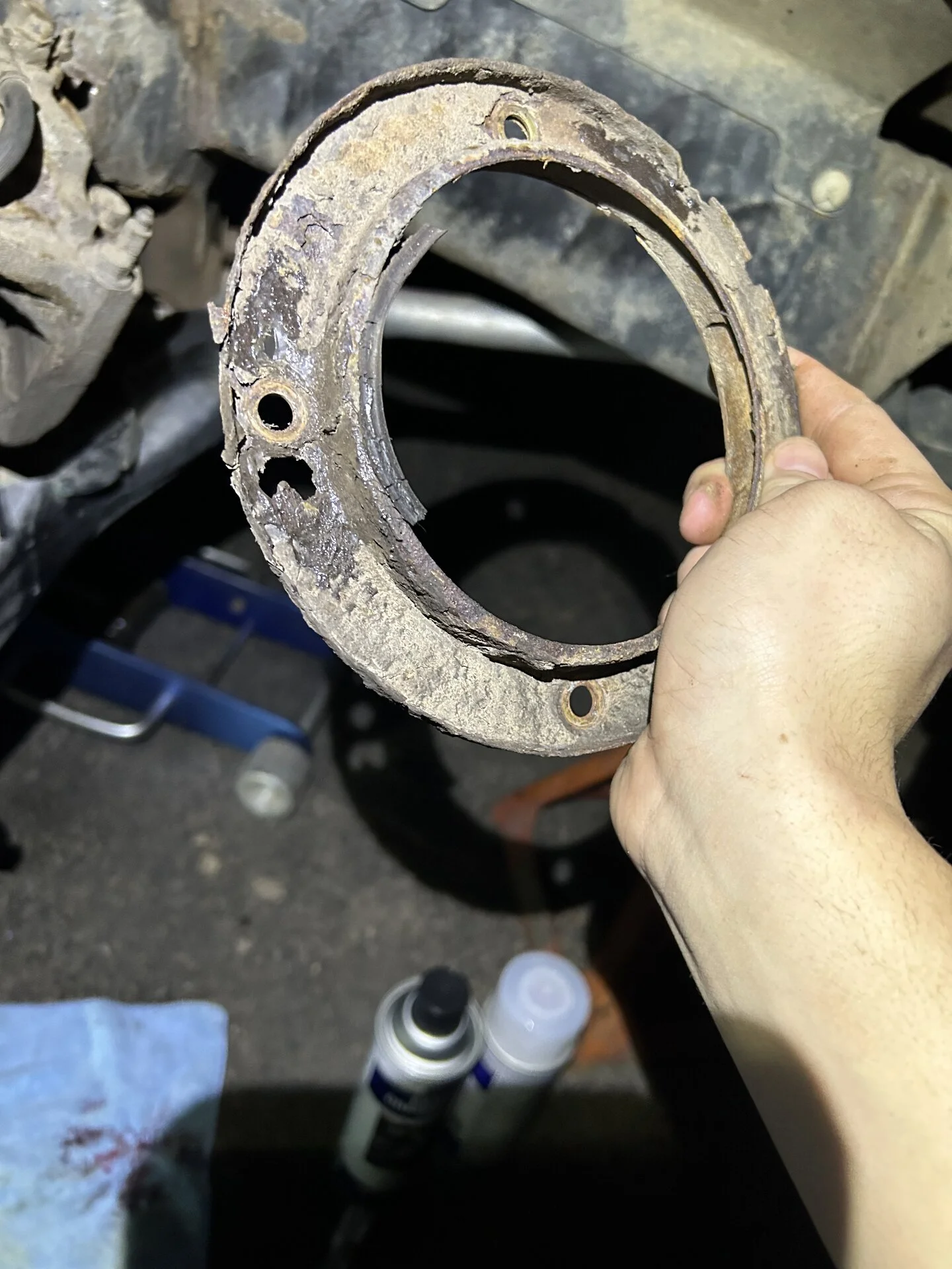

Was changing my wheel bearing out the other day and came across a couple rust holes in the inner spindle dust seal. I originally thought this was the dust cover (part #s below). Turns out the part I actually needed was separate and is the inner dust seal. Had a hard time finding all the part numbers needed so here is a list of everything.

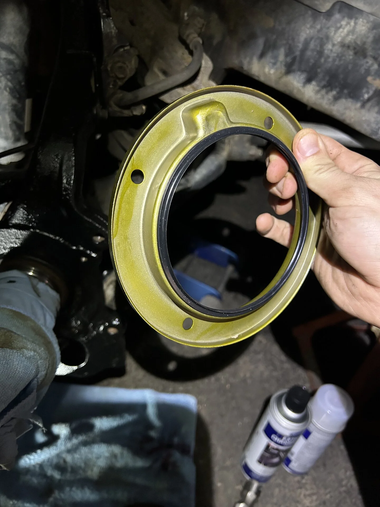

9031399001- Inner Dust Seal (on the outside of the larger dust cover and seals the gap between the spindle/hub)
4343660020 - Knuckle Spindle Dust Cover Gasket (this goes in between the larger dust cover and inner seal)

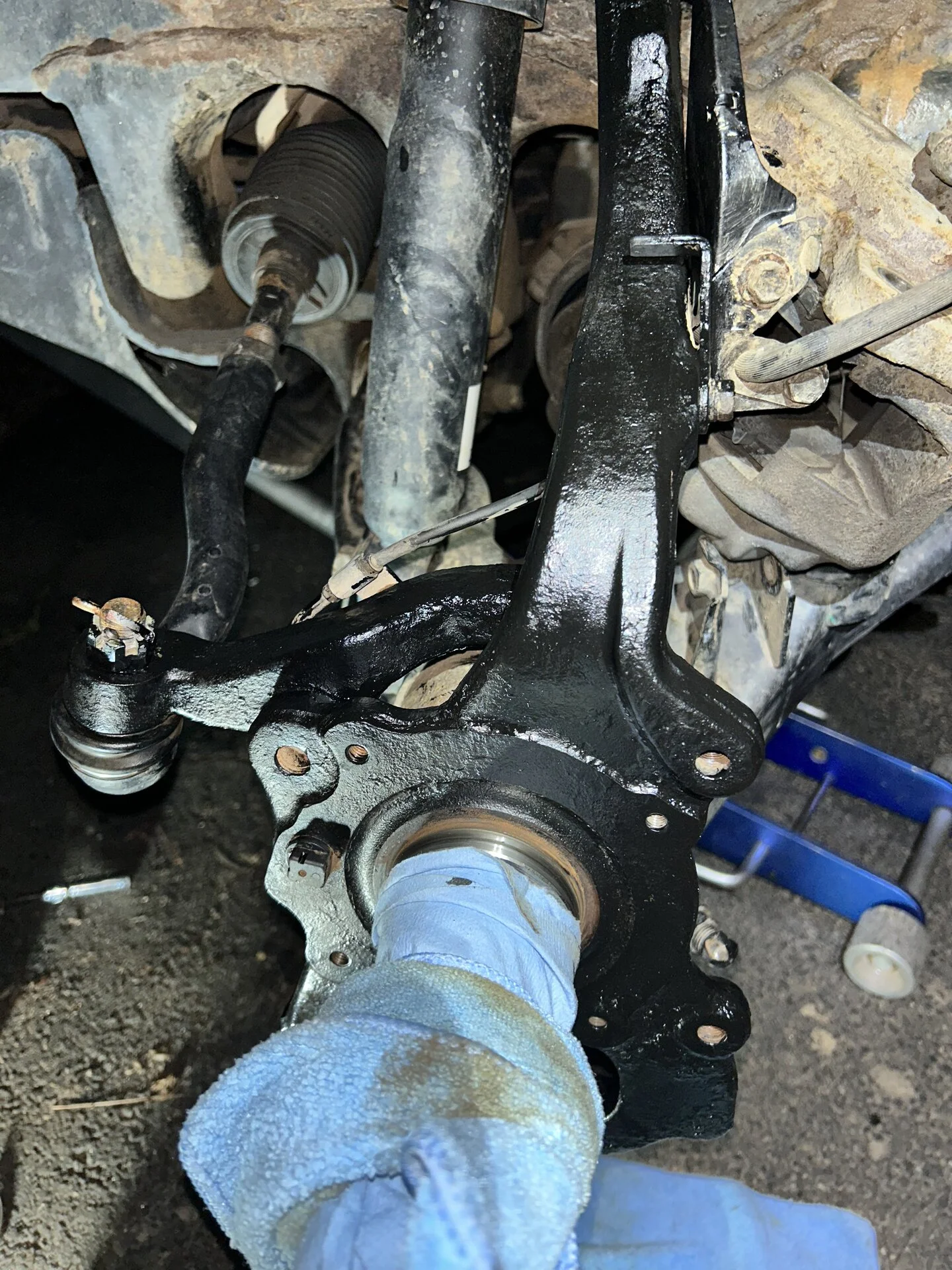

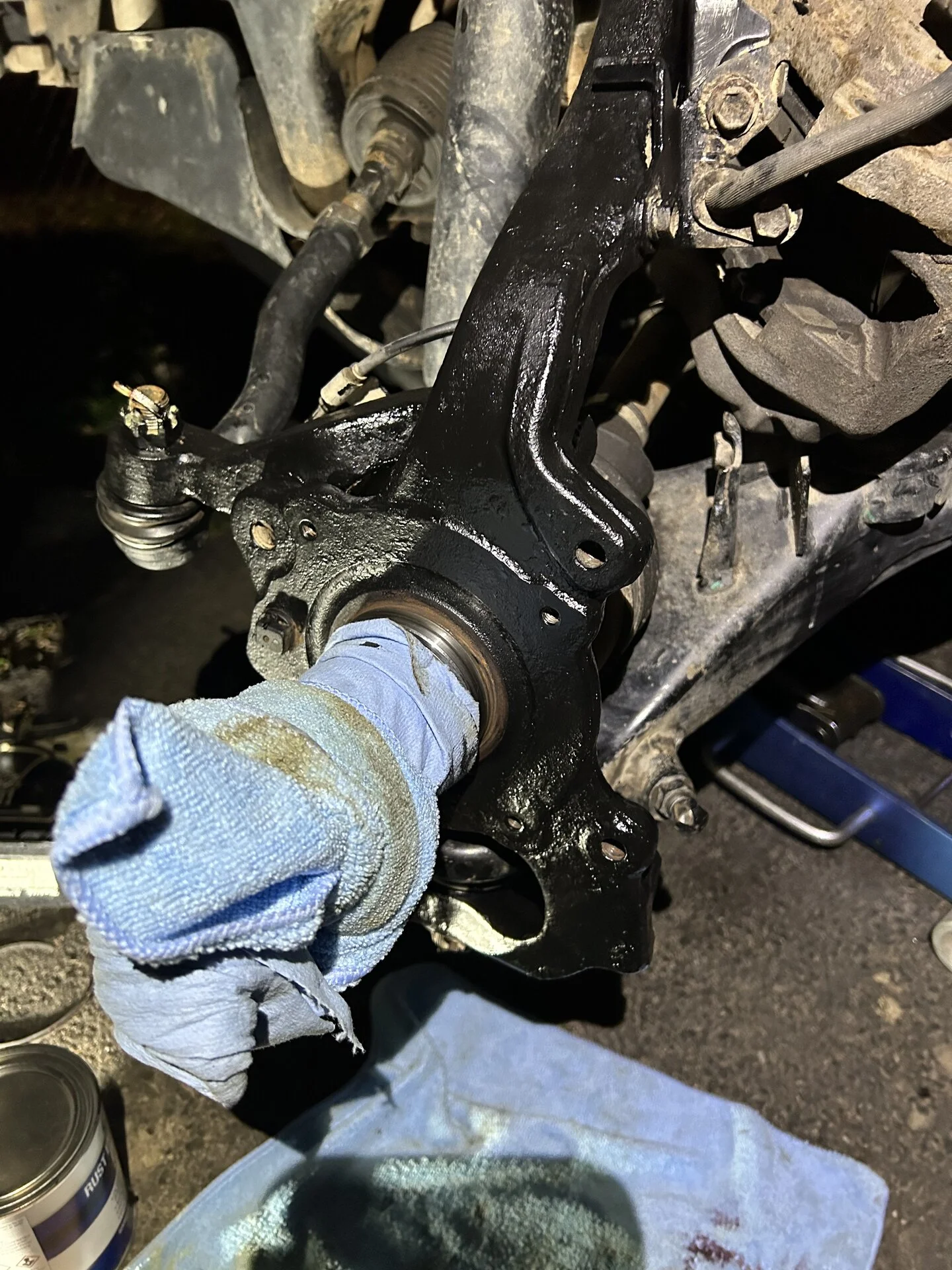

update - this what what my dust seal looked liked and I painted my knuckle with Eastwood rust encapsulator while I was doing the job. Very happy with the outcome.
