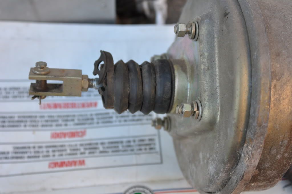

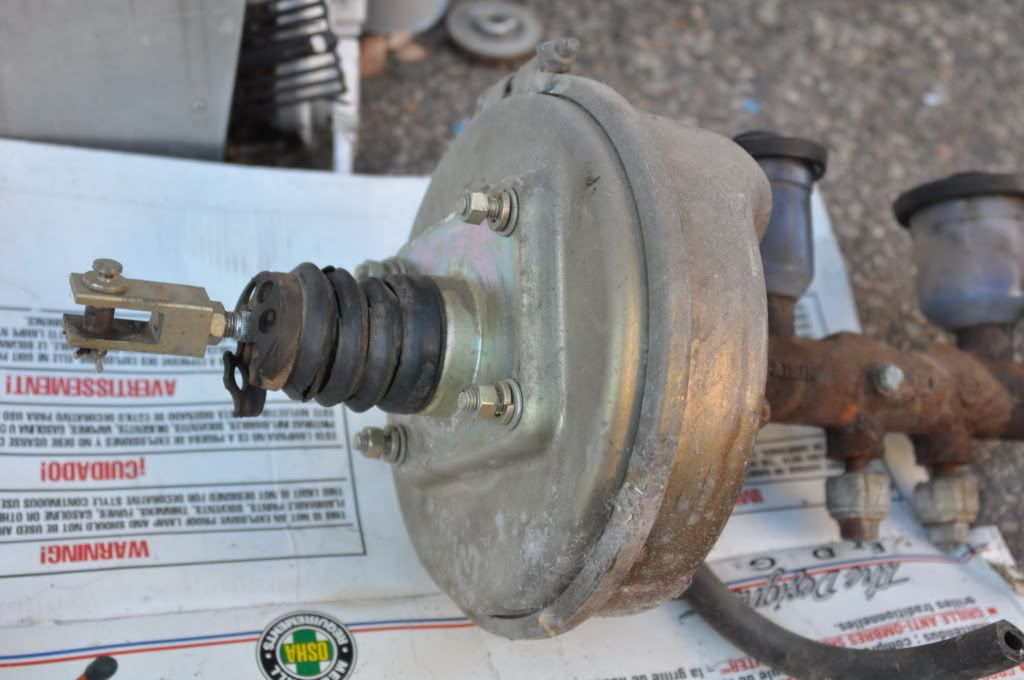

Just in case anyone trips over this old thread like I did - JohnnyC clued me in to a good alternative.
I bought an "accordion style" shift boot for a 67-72 Chevy brake booster. It's about $10-12 from a couple sources online.
On the left is my worn out Toyota boot. On the right is the Chevy boot:
I transferred the little filter element in the Toyota boot to the Chevy boot:
Installed, the fit is pretty close, it's a little loose where it meets the booster, but it seems like it would hold under normal use. It doesn't move when actuating the pushrod by hand:
