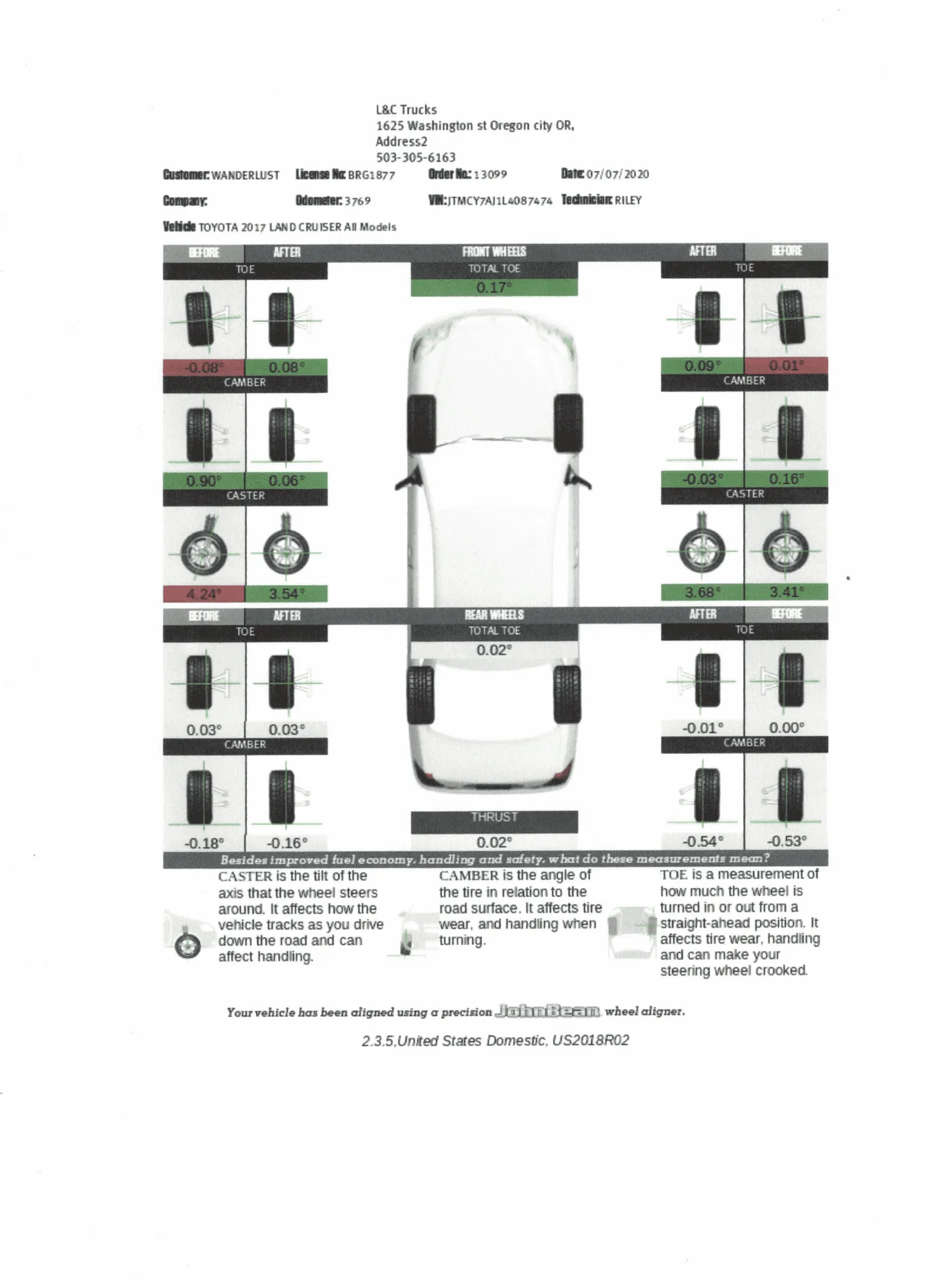

Here are the numbers. Based on what I’ve learned speaking with SPC, Slee, and another reputable shop in Portland, the adjustable balls / control arms are not installed properly. Thoughts?
