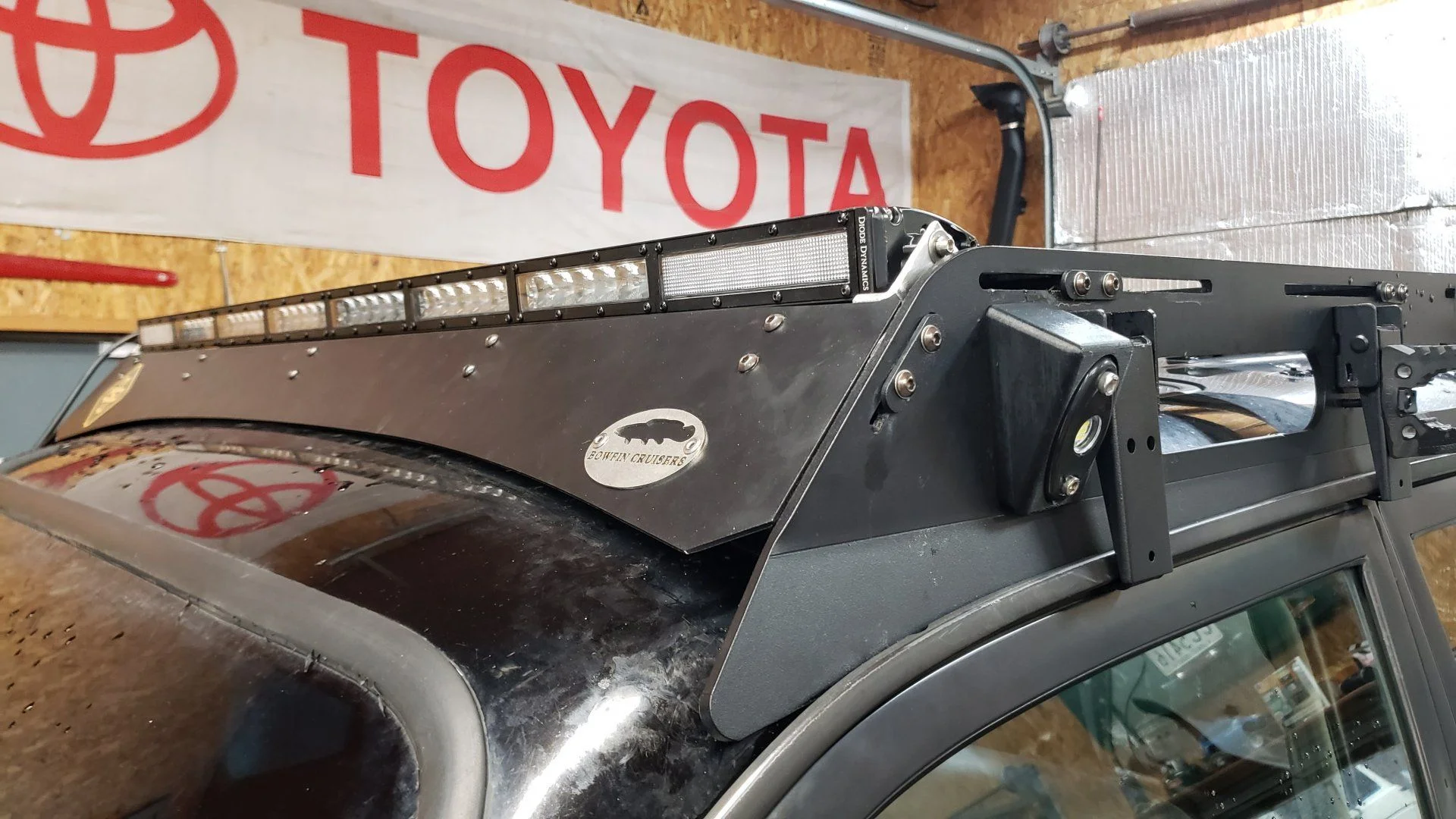

The Bowfin rack with light cut out is only setup to do like a 42 inch light. As seen below on @Voodoocruisers awesome white 80.
The crossbars on an 80 rack are 50 inches wide and we really wanted to see a fullsize bar across the top. This probably works with other bowfin racks as long as you have atleast 50 inches of crossbar width, you'll have to measure yourself and let me know.
So just cut the fairing flat at the top and all will be well. Remount the fairing to the crossbar, unpackage your light, spend some time trying to get the factory bracket to work then give up.

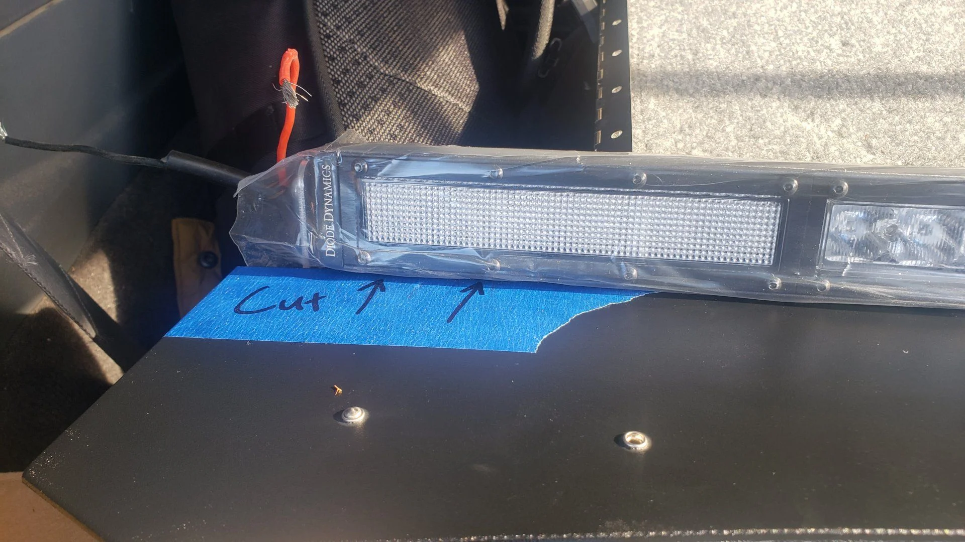

Next, figure out your light placement. It's a tight fit as the 80 crossbars are 50 inches and the lightbar comes in at just under that without it's brackets.
Make a simple 90 degree bend and get some holes in them to mount to the crossbar and then to the light.
@Builtbybudski seen below measuring out the horizontal holes before drilling and trimming down the bracket.

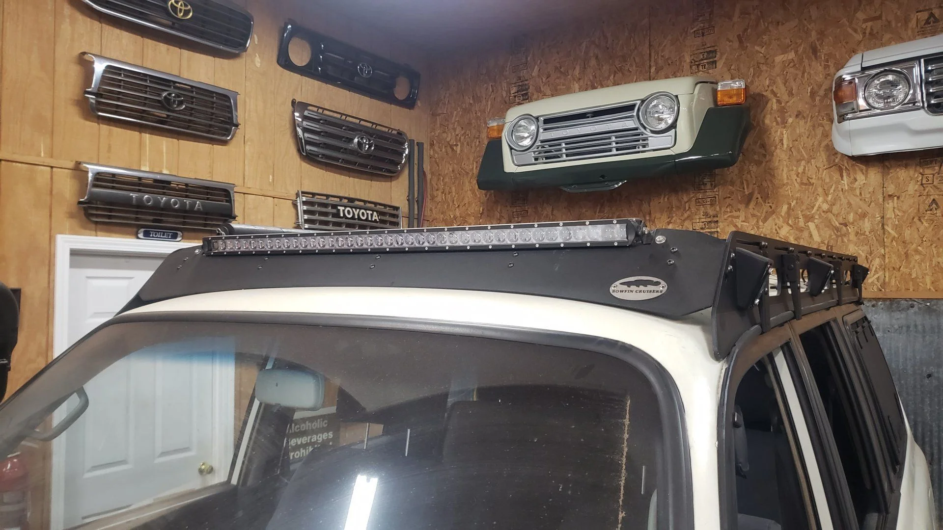

Next trim down the tabs, we haven't painted or powdercoated them black yet but it will be happening. Only so many hours in a day and we wanted to get to wiring.
We could have a conversation about wiring but everyone wants to to do a different way so you do you, if you have any questions on how @Builtbybudski did it, he or I will be happy to answer.

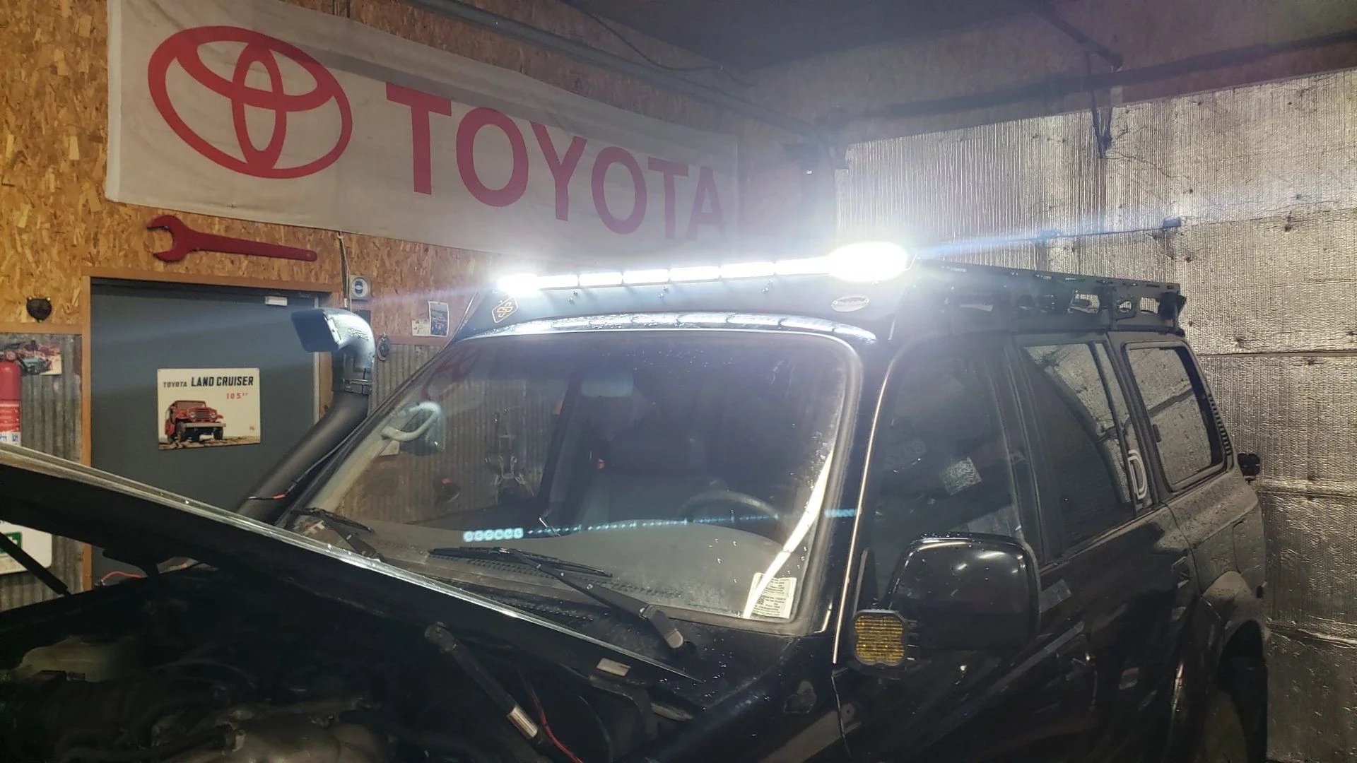

the next step involves turning the light on then staring directly into temporarily blinding yourself and saying, "yep, that's bright".
Next, you'll want to take it outside and play with it sometime after you stop seeing purple dots.
