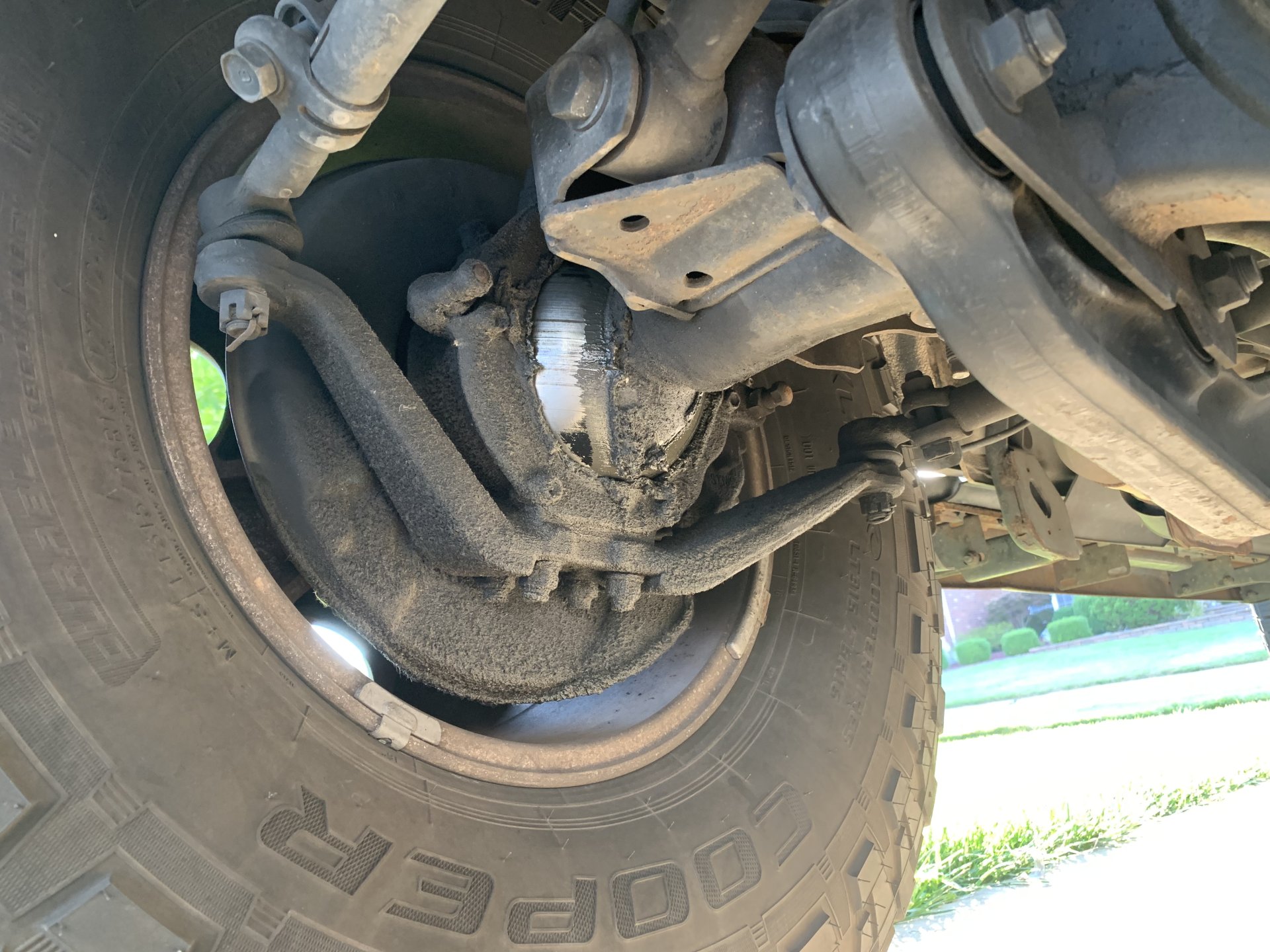

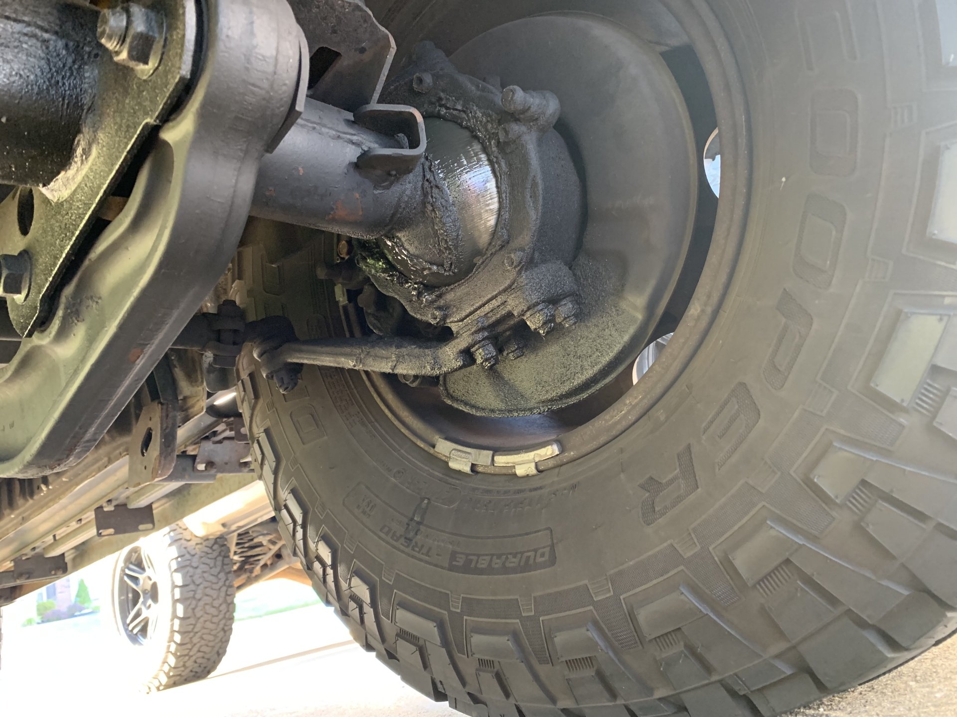

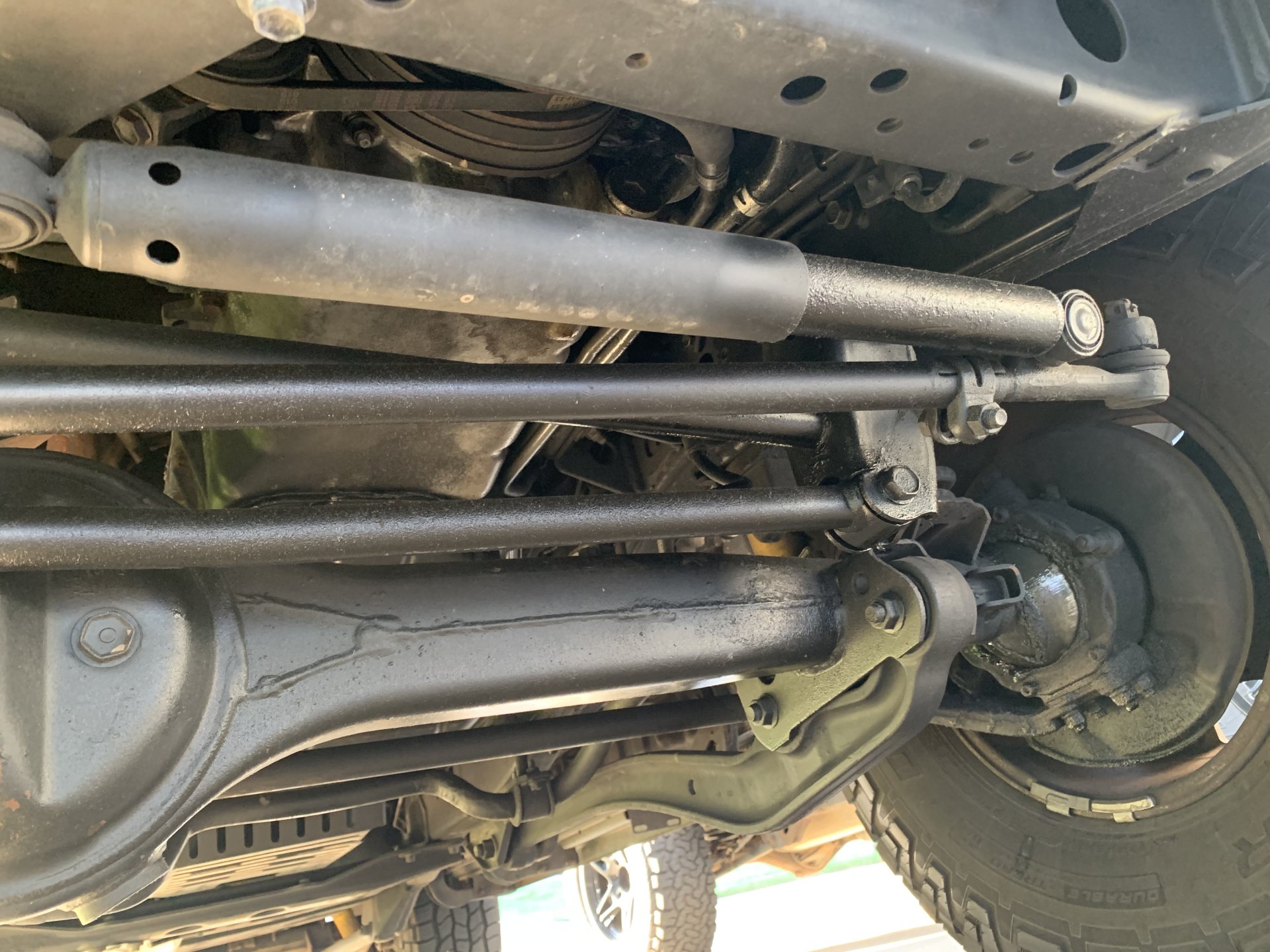

Pics of the Birf situation. Thoughts?View attachment 3065534View attachment 3065535View attachment 3065536View attachment 3065536
No, that's normal. The balls should have a coating of grease and it will ball up a bit.
Yes, they're a little coated in a tiny bit.

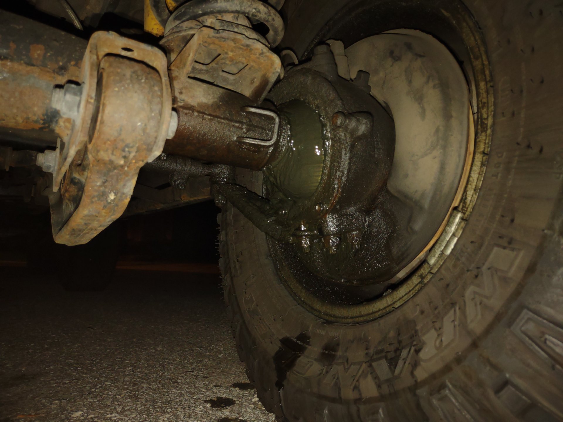

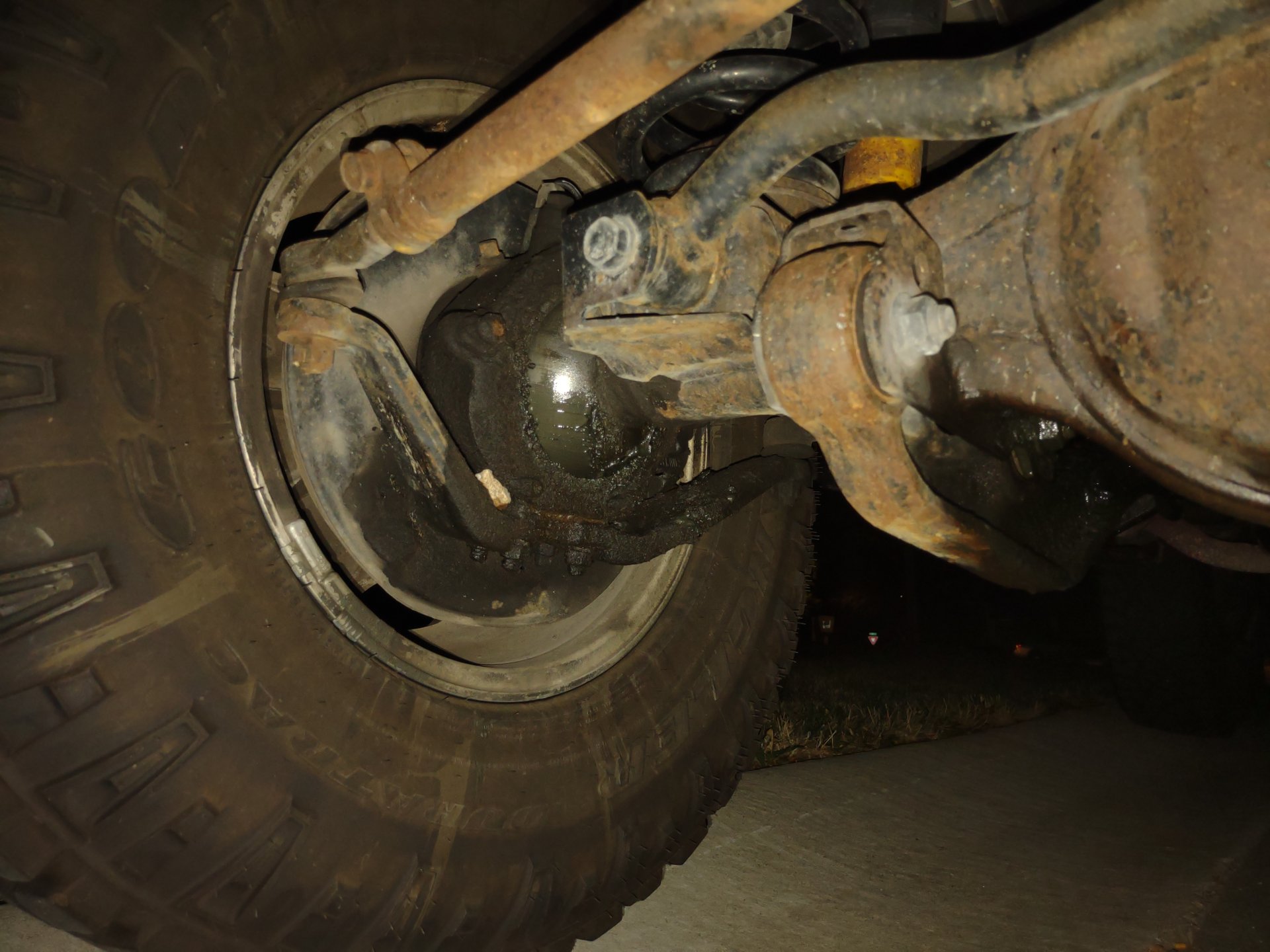

I'll take a pic of mine right now and show you what a leaking birf looks like. I have 120k miles on the axle rebuild and it's overdue.

Looks not too bad, but plan on a knuckle rebuild at some point.
Also, with oil all of the front axle housing, I'd guess you have a leak or two around the front of the engine.

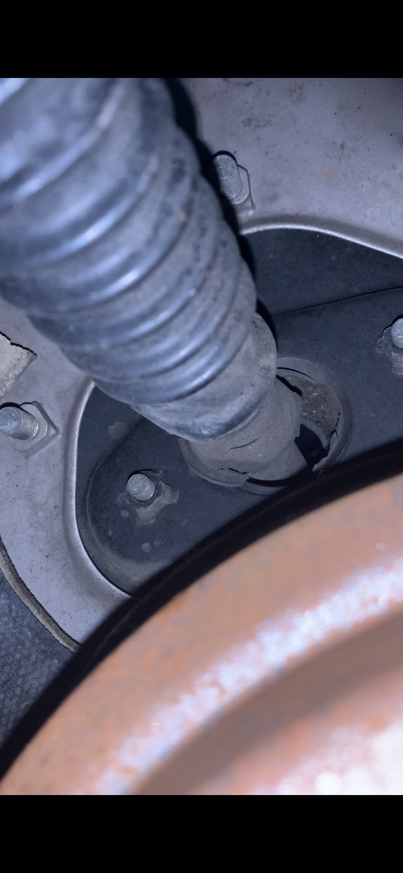

Yes, that's the steering shaft seal. Common replacement.Okay, so I opened the glove box and found what was definitely a mouse nest in my glove box. It was made in the last two weeks. My new registration paper was chewed along with some of the insulation material on the inside of the firewall. My question for the 80 series veterans is where could a mouse find it’s way in? Edit; I looked under the brake booster at the steering column and there is a gap. Anyone else has this problem?View attachment 3069189
