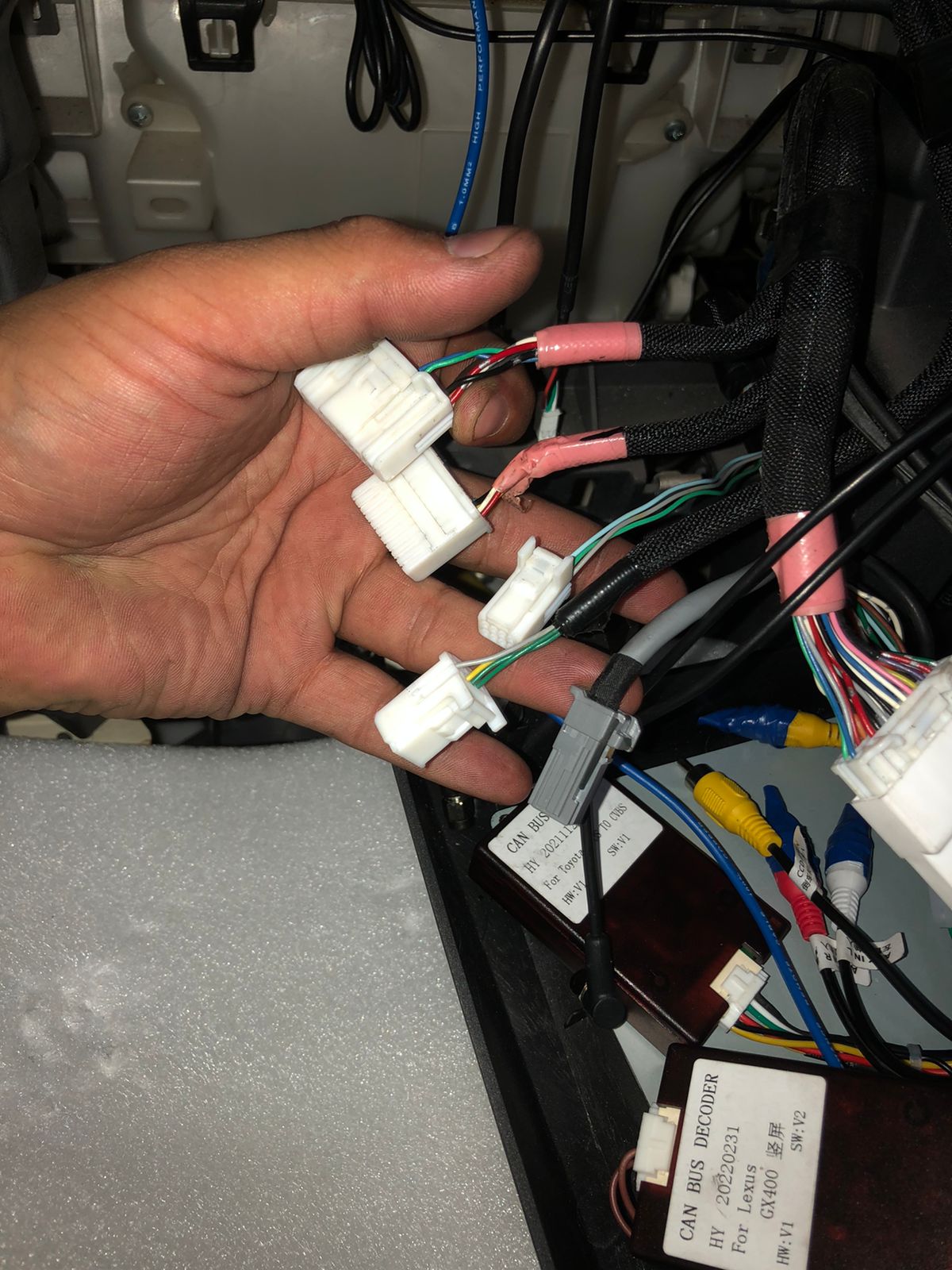

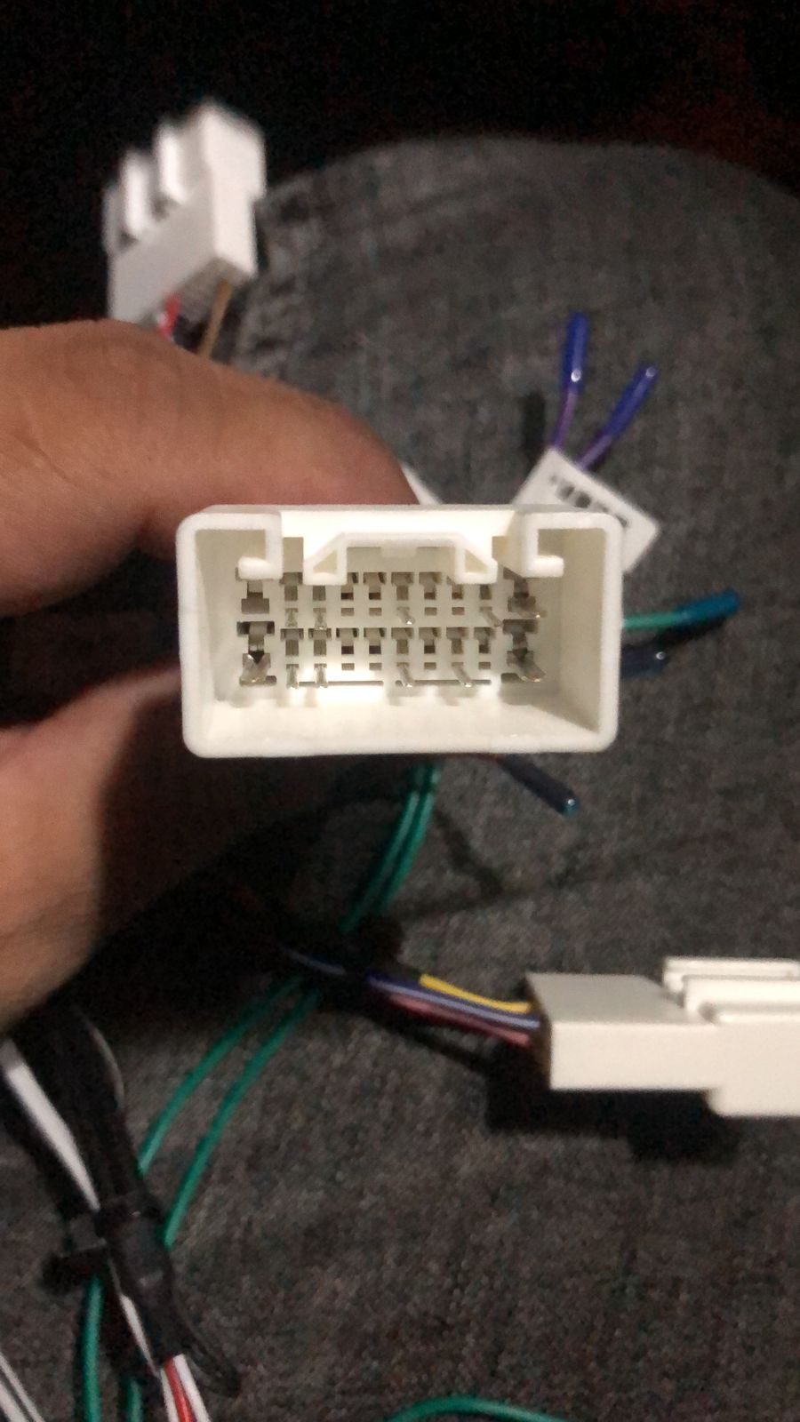

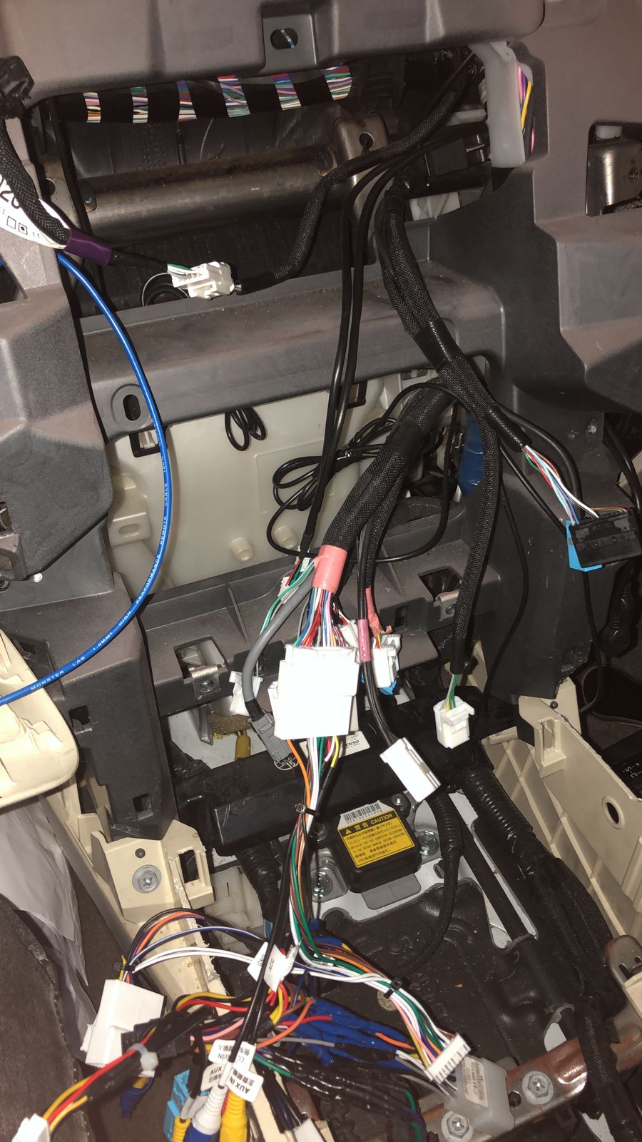

ANdroid 11, with 6Gb and 128Gb, with all the bells and whistles.
I have spent about 4 hrs fitzing around here with an installer and we are hitting a dead end. THe unit came with two harnesses, one labeled lexus and the other toyota. Logically we connected all the lexus plugs and everything plugged into except the main large power plug. Doesnt power up....THe installer did some magic with the toyota harness which the main plug does plug in and now the unit powers on and the speakers work! Except none of the car's AC and Canbus plug in to the toyota harness.....
Can someone give me a little help please.

I got nothing, other than at the top of the forum, under the sticky threads, there a "GX 460 Manuals" thread that I think has the electrical wiring diagram, which should be your go-to for troubleshooting installations like these.
  • Like
Reactions: r2m
You need the proper Lexus harness. I’m willing to bet you were sent the wrong harness for the wrong year. Contact the company who made the unit to verify the harness.
