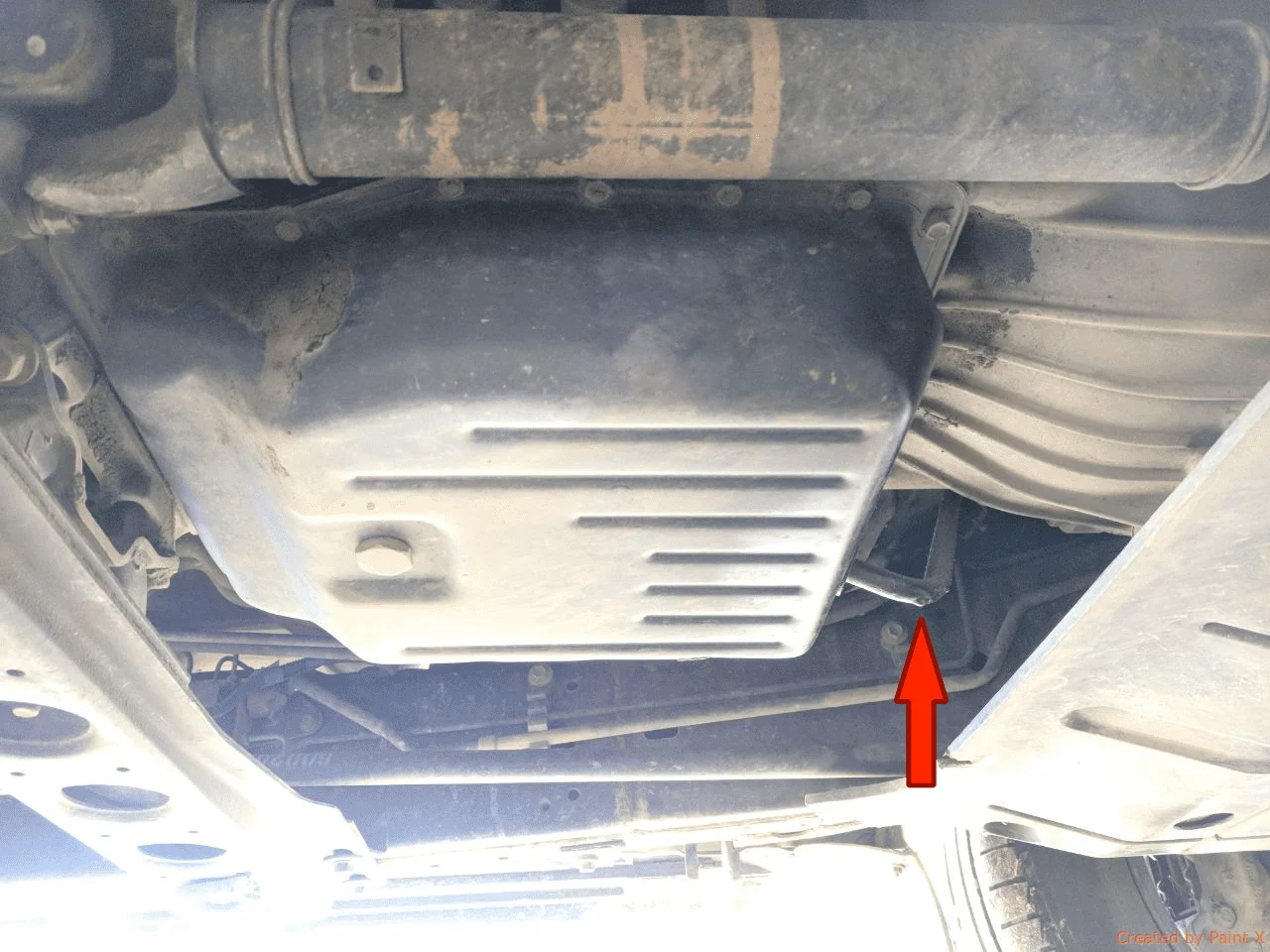

2 - There is an oil leak under the car

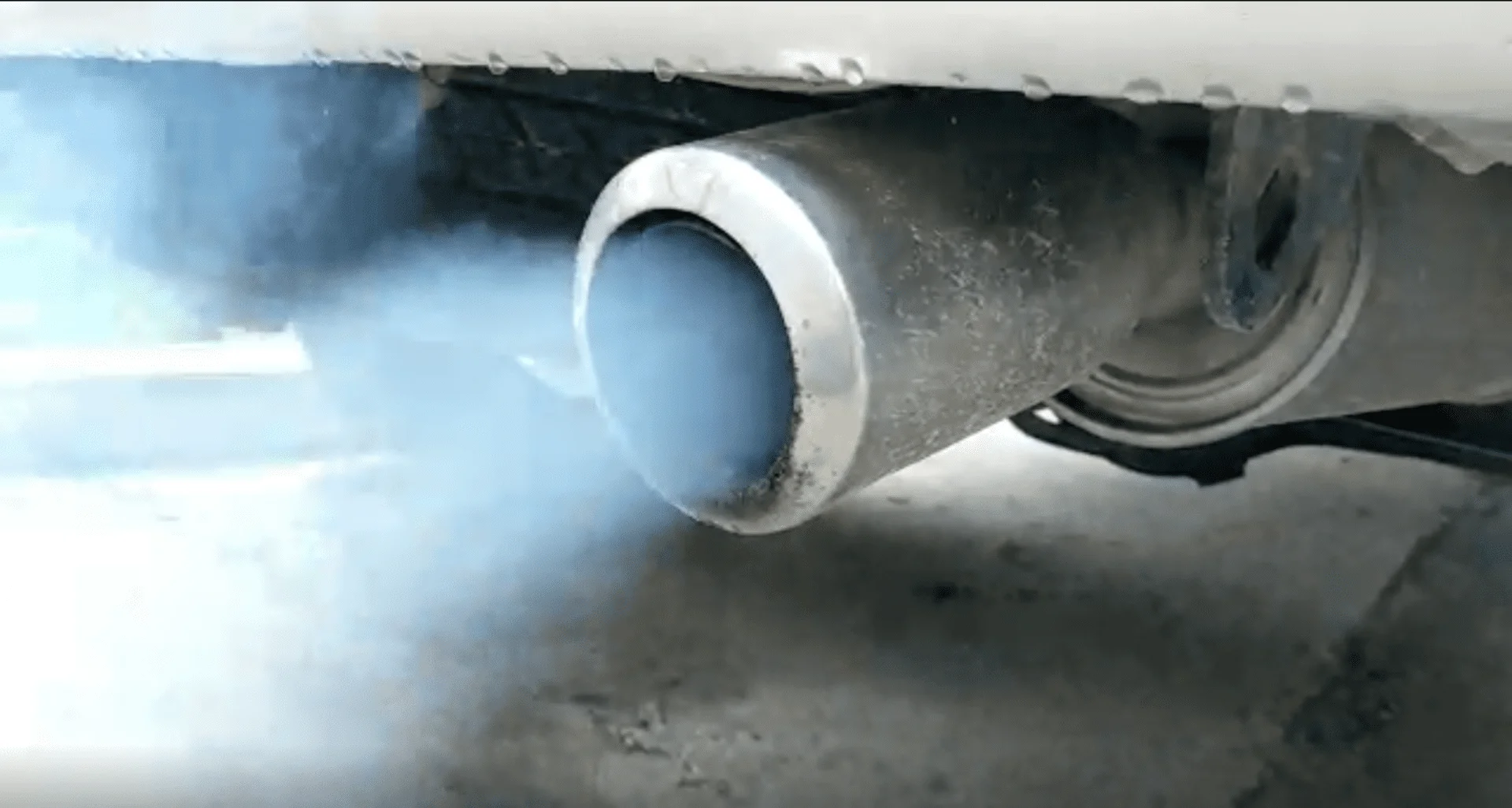

6 - When starting the card after batteries were changed there was a considerable cloud of smoke from the exhaust pipe. Now every time I start the engine, there is smoke at first but after a few seconds it disappears, although not completely.

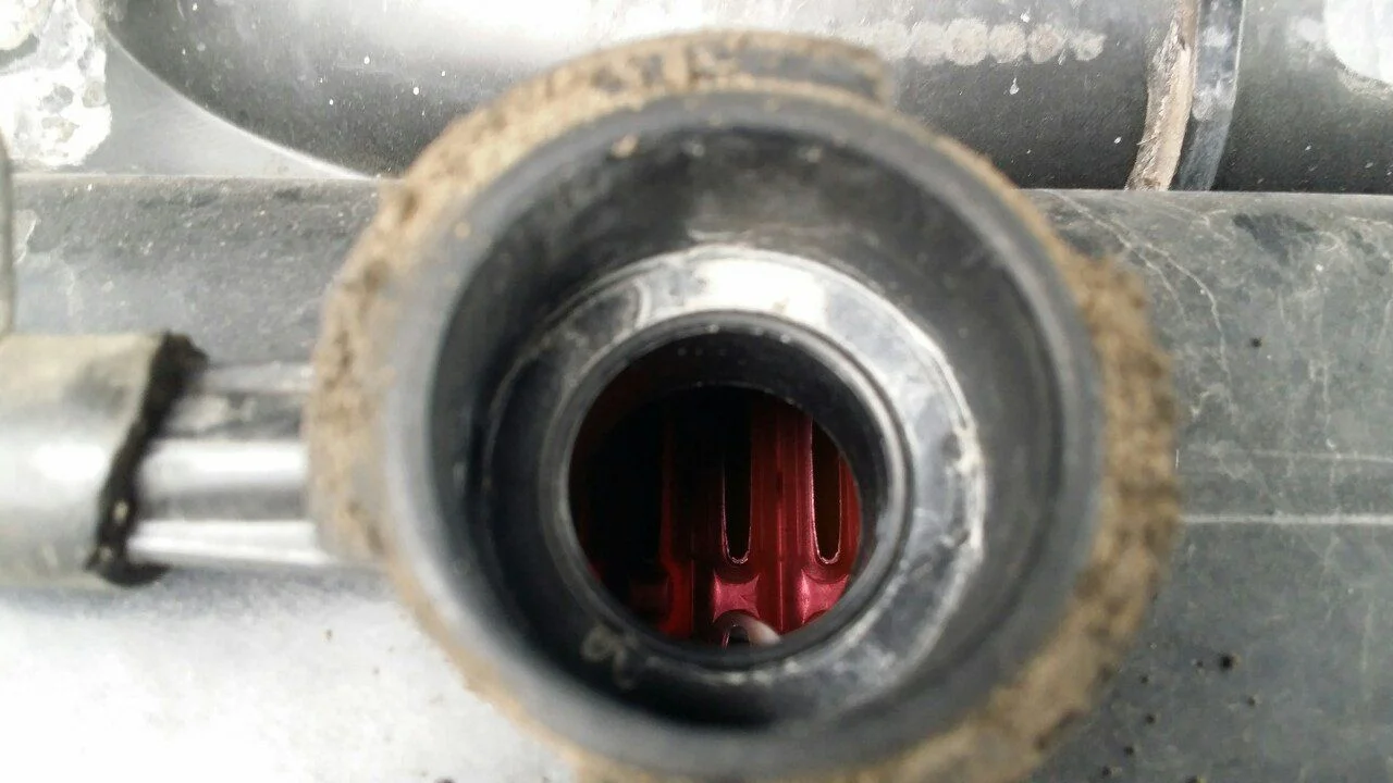

8 - Engine coolant is at the LOW mark and looks reddish in color

The smoky start up of the engine is probably the biggest source of concern. Could be worn valve seals. What is the mileage of the car ?

Replace the PVC valve, I almost can guarantee it's jammed up. That's a normal cause if smoke like that, but not the only possible cause. Be careful of the gasket for it, if it's really old and hard it could break and pieces could fall in the valve cover. If that happens, you HAVE to pull the valve cover and get the bits out. But on that note, a valve cover leak is alsoalso usual culprit for an oil leak.

2) The leak is like transmission fluid. It is coming from the dipstick. Could be too much oil in the trans or a leak on the dip stick tube.
3) Lowering the oil level can be related to the blue smoke at initial startup. Most likely it could be a leaky valve stem seals or PCV valve. If you don't have the history of most recent PCV replacement, get OEM PCV valve ( $ 5.73 at 2000 Toyota Land Cruiser Parts - Camelback Toyota Parts - Genuine OEM Parts - Free Shipping) and the grommet around it.
For leaky valve stem seals, you'll need to replace the seals. For that you need a little bit of experience. No need to remove the heads, just find a good mechanic.

6) Please see (3)

8) Refill the radiator with DI water/Red Coolant and also fill the reserve tank to Max mark. See what happens with time. IF the radiator is old/unknown history, replace the radiator OEM or DENSO with OEM radiator cap. If possible replace at least the upper radiator hose (OEM), both is advised.
