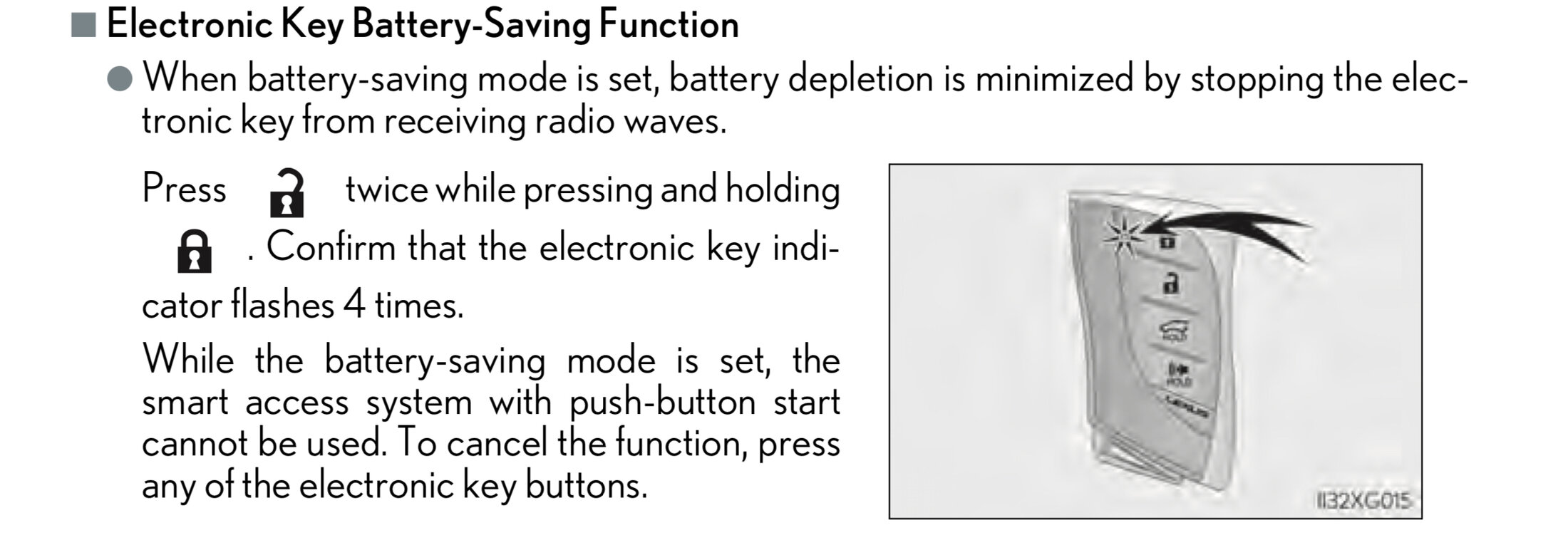

FOBs in battery save mode? Although it sounds like it would defeat push button start too which you stated still works. May be worth a shot anyway.
It does sound like this may be a dealer visit
yeah, i agree. likely a dealer visit considering it's pretty low likelihood i put both transmitters accidentally into battery save mode. thx!
  • Like
Reactions: r2m
Agree, since they should come out of battery save with a key press...
