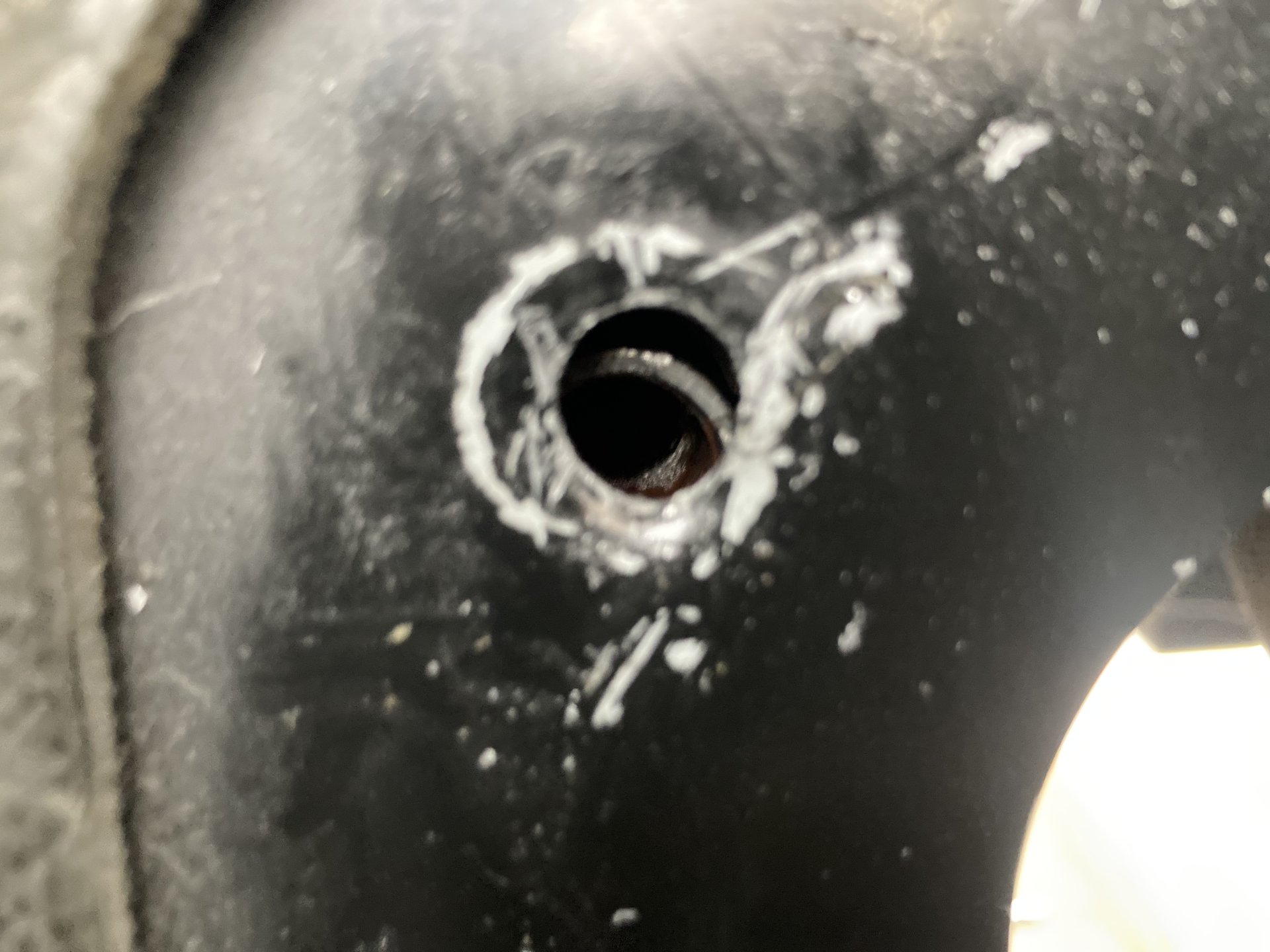

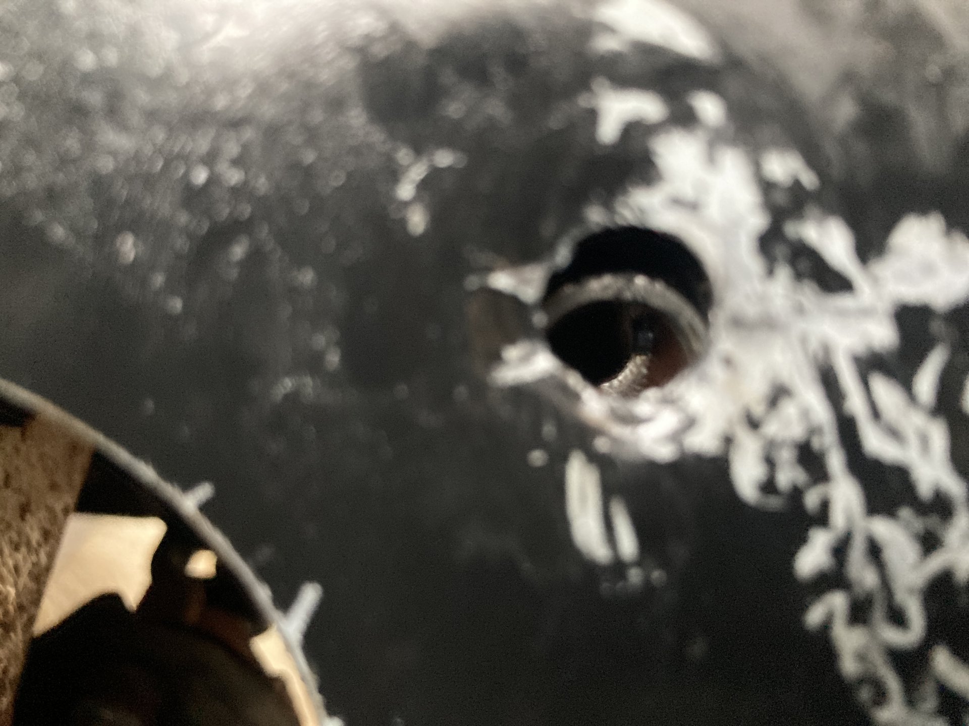

Ok so you need to fix the threads. get someone to drive to you lowes/homedepot or any of the parts stores and get a die to clean up the threads.
I am take your old booster with you so you can match it up, but i think it will be m10 1.25.
probably 7 or 8 dollars though.
yeah realign that back up with as screwdriver or punch or something before you try to put it in again.
So I found that tool @clx16 mentioned for rethreading and was able to adjust the bracket within the firewall to get the studs through and the booster is finally installed.
Sometimes it pays to take a step back and think about what you're doing. I was so hyper-focused on forcing it through the firewall that I didn't even think of the offset bracket blocking the studs.
I feel like a total idiot that I almost let that stop me from finishing the job, and that it took me so long to realize.

I ran into this same issue a few months ago, the cause was the misalignment of the brake pedal bracket against the firewall. That bracket is held in place by the same nuts (using the booster studs) as the booster itself.
So when you remove the nuts on the cabin side of the firewall the brake pedal bracket can slip out of place, when that happens no amount of forcing, wiggling, or kicking will get the studs through; the four holes in that bracket on the inside must line up with the four holes in the firewall and the booster studs. IME
I had my son hold/wiggle the the brake bracket into location over the studs as I wrestled the booster in from the front.
