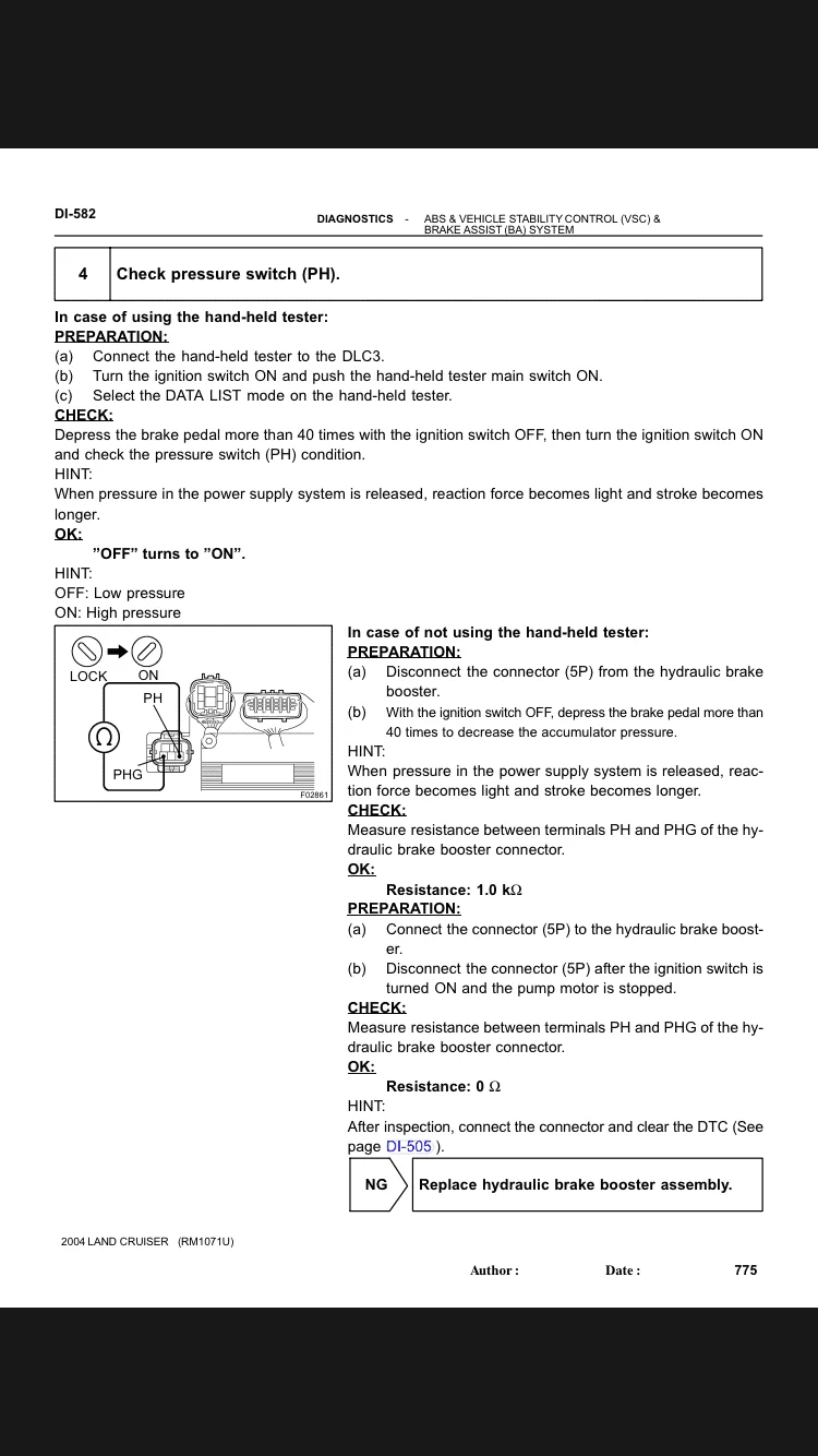

I followed the troubleshooting guide posted in my post to diagnose the problem. The pressure switch that goes bad is inside the ecu(black box on the side of the module. It is not the master cylinder pressure sensor.
Look at the PH pressure switch troubleshooting page:
Use an ohm meter to check the resistance across the pins shown. The pressure switch controls the pump. When the pressure is low, it will be 1kohm. When the pressure is high, it will be 0ohm.
When the switch does not work, it will stay 1kohm. That tell the ecu to keep pumping. Then it starts make the screeching sound. If it pumps for more than 5 min, the warning lights and buzzer turns on. For some reason, when it gets cold, the sensor sticks since it spends hours at high pressure when cold. I have seen some improvement if you pump the brakes a few times after you turn off the truck and remove the key. That reduces the pressure and changes the switch to 0ohms.

Interesting. So replacing the unit is the only way to go eh? Is there a DIY solution or someone I can send the unit off to for rebuild? I'm willing to push my luck opening the system if I'm going to buy a new one anyway.
I do not know of any DIY solution. You could open the ecu and trace the circuit to the pressure switch if you open the black ecu box on the side of the master cylinder. If the solder joint looks bad you could try to reflow it.

The last sentence in the FSM says t replace the hydraulic brake booster assembly. But you’re saying the problem is in the black box on the side of the master cylinder? If it is the pressure switch, wouldn’t the FSM say to replace the box, or whole MC assembly if it isn’t sold separately?
Am I missing something?
Sadly, techs in general are taught to replace things instead of making repairs. It makes sense that the FSM would say to just replace the entire unit. There very well could be a DIY solution

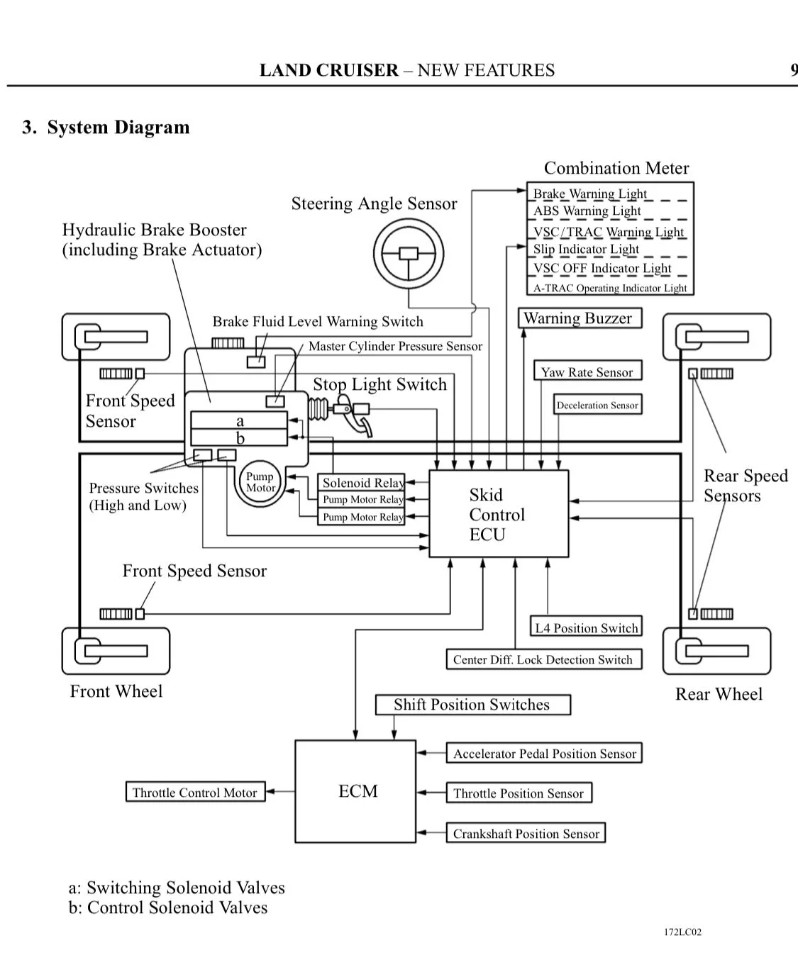

Does anybody have a picture of the actual pump, or can someone explain what type of a pump it is? I know people are replacing/rebuilding the motor and accumulator, but I'm not seeing any rebuild parts for the pump itself. Is it a rotary pump? Is it all metal like an oil pump, and that's why it's not being rebuilt? Sorry if I'm being thick or missed a bunch of posts explaining this, but I just can't picture what's between the motor and accumulator.
I posted a picture of the breakdown a few pages back. It explains everything.

The brake booster is sold as a unit but the black box is not part of the unit. If it said the whole master cylinder assembly, including the booster, that would make more sense. The booster assembly is sold as a unit and then they also list the whole thing including the master cylinder assembly and brake booster assembly as a part number. The FSM just said t replace the brake booster.
a page ago i think it was said it is a sealed pump head. most likely resembling a water pump. does not seem serviceable in any way. someone would have to run one through a band saw, but im sure its just an impeller on a shaft. i would think its the least likely part to fail in the system.
The pump sits under the accumulator. The motor also bolts to the pump.

I bought a booster and accumulator. Put it in tonight and still problems. I've been reading a ton and o think this is the problem. The high/low pressure switchs not working.
Strangely, the new unit does not shut off. Pressure is very high.

Used from eBay. Bleeding didn't help this time. The motor wouldn't shut off and there is crazy pressure. Reading lots of other threads...it sounds like it's the pressure switches in the black box on the side of the master cylinder.
