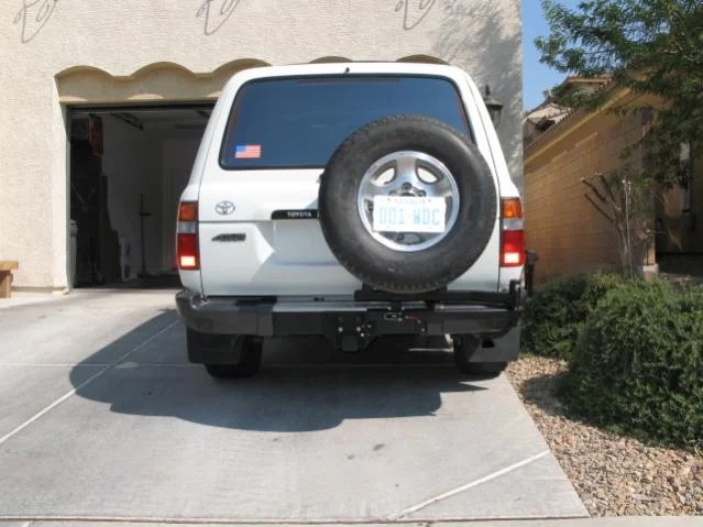

Thought I'd post up final painted pics of the tire carrier project from this build thread.
https://forum.ih8mud.com/80-series-tech/257957-spare-tire-carrier-bolts-bumper.html
I may still look to add a Hi-Jack carrier at some point, but I got impatient and wanted to get paint on it and get it installed. Tire on is small - stock, but have fitted it very nicely with my 305's, and it should accommodate a 35" very nicely.
Upgrades I know I will do is to light the license plate bracket (when I feel like it) and upgrade the latch to a larger one.
And, Open:

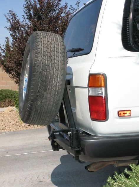

My only concern would be the amount of leverage you could get on the end, as the swivel point is so far away from the bolt on part.
During the build, I sat my 240 lb butt on the extended arm and bounced without any problem. I used grade 8 hardware and realized I did overkill using 1/4" thick steel for the tubing, and 1/2" for the bumper bracket, and the spindle is very strong, rated to 1000lbs. Basically, the thing is overbuilt, I can't see any possible failure points. My steelies with the Procomp X-terrains weigh about 70-80lbs, and it held this fine. Plus, while stowed, the tire rests all weight directly between the two bolt on points, with no stress on the spindle at all.
Ah, didn't know you used 1/4" and 1/2". You should be fine then. :cheers:
