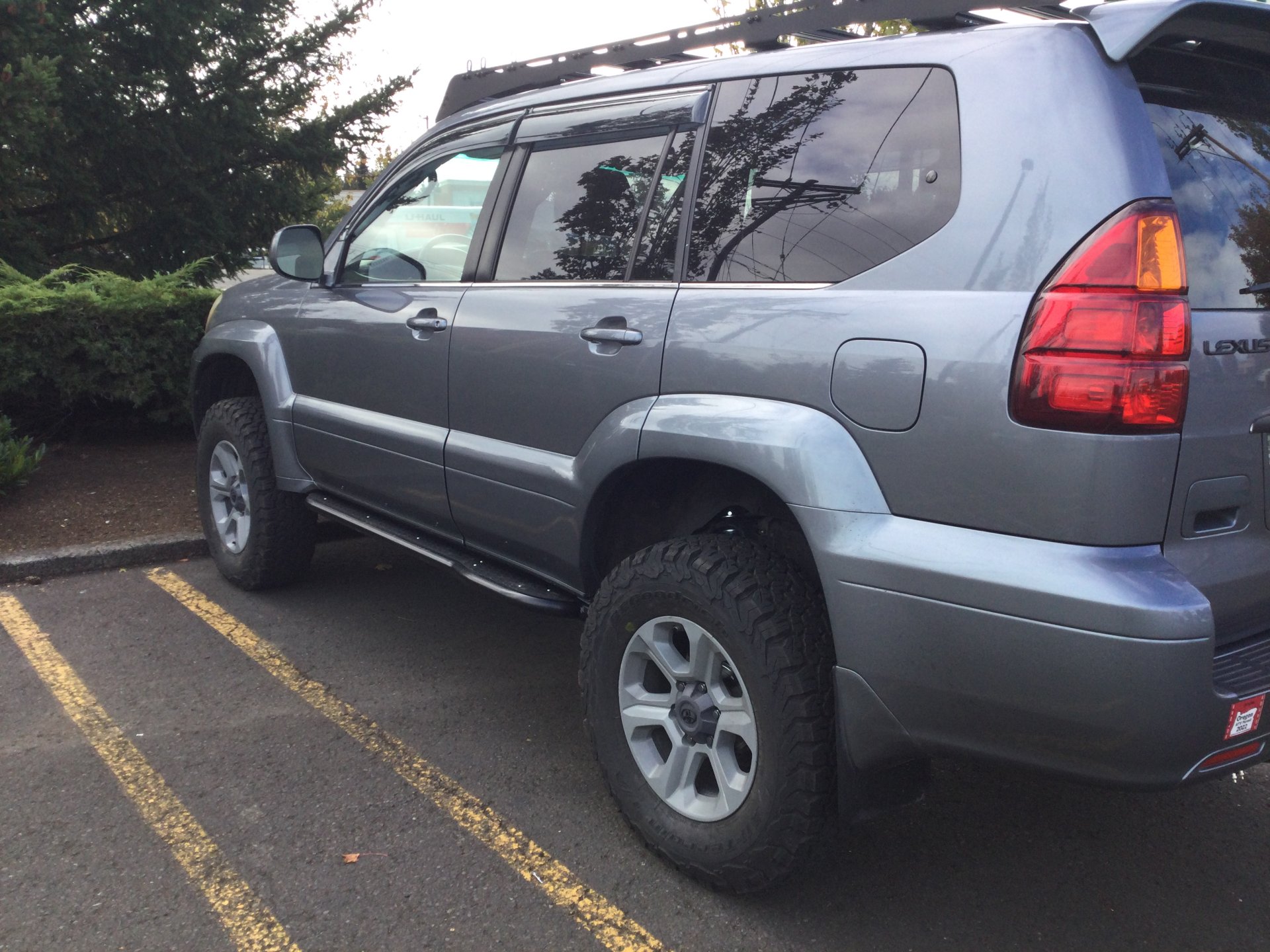

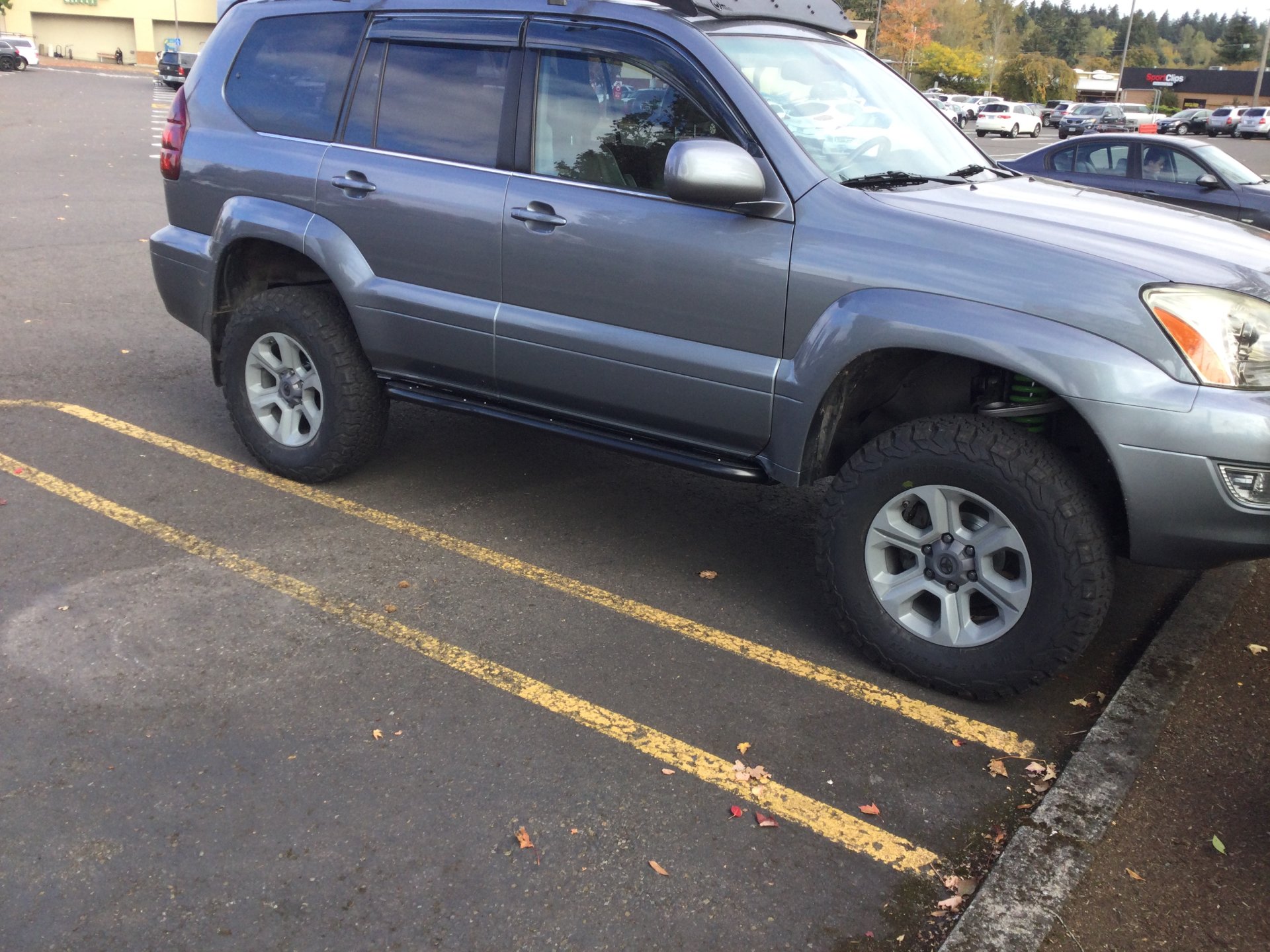

Agree. White Knuckle sliders on my 2005 GX with KDSS as well.
great product, sturdy, look terrific, installed easy and fit perfectly. Price was slightly less than other quality competitors too!
I got the standard 11* angle and would recommend it, but you can choose flat if wanted. The top deck (plate) is nice as well.

It really isn’t an issue… certainly not for me (6’), and not for my 5’6” wife (I just asked her 😂). Small kids might have a bit of a stretch up to the “first step”, but hey, they’re not small forever, right??
I have a moderate lift…2.5” or so.
And, upon exiting the vehicle, there is less of a drop than the OEM boards.
The nice thing is, they tuck up a bit better than flat slider would.

I will say that one needs to be a bit more precise about toe/foot placement when stepping onto the sliders than you would with running boards simply because the boards are lower, flatter and wider…hence an easier target.

Yes, you can still get some (quite a bit actually) purchase.
I use them often to reach items on my roof rack. I can stand on them as long as needed…plenty of platform for that.
And they sit higher than stock boards, so access to the rack is much easier.

My ex was 5’3”, and the angled steps were, at least for her, a huuuge upgrade over the deleted running boards. It’s a really slight angle, and, imo, mostly for aesthetics. As far as using the sliders as a step, I prefer them over the running boards.
