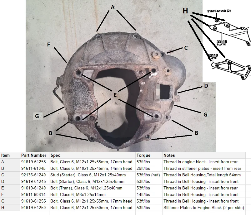

Longer shot, Posted here as diesel folks know the most. Would anyone happen to know the length of the larger bolts which fit h55f bell housing to 2h please? part number 91619-61255
Here you go.. I made this image a while back when I was trying to sort out mine.. also the length is in the part number "55" on the end is a 55mm
91619 - standard bolt with a spring washer
6 - bolt strength (2 lines on the head)
12 - 12 mm bolt (shank size)
55 - 55 mm long.
