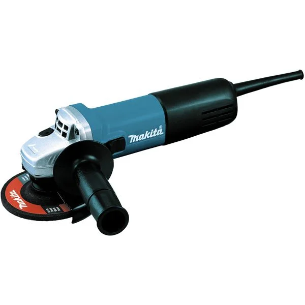

Yea, but did it throw off a shower of molten metal? :hillbilly: I thought not.
