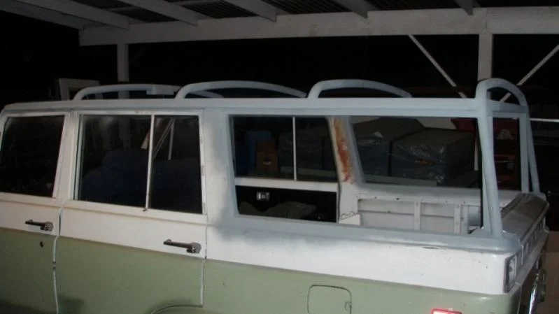

When I chopped the top on my old 55 I used tube to bridge the gap between the inner and outer panels from the rear doors to the gate. I then tied into that tube with the cage. The cage mounts went to the body and frame. I kept my B pillar and roof so I did not need a w/s support or rear support for the front door. If you don't do that you would want to tie the cage into both of those.
Crossbar placement can get tricky if you want to keep the rear seats. On the little pig I didn't keep the rear seat so the hoop behind the front seat is triangulated and has a cross support for the upper part of the seat belt harness.

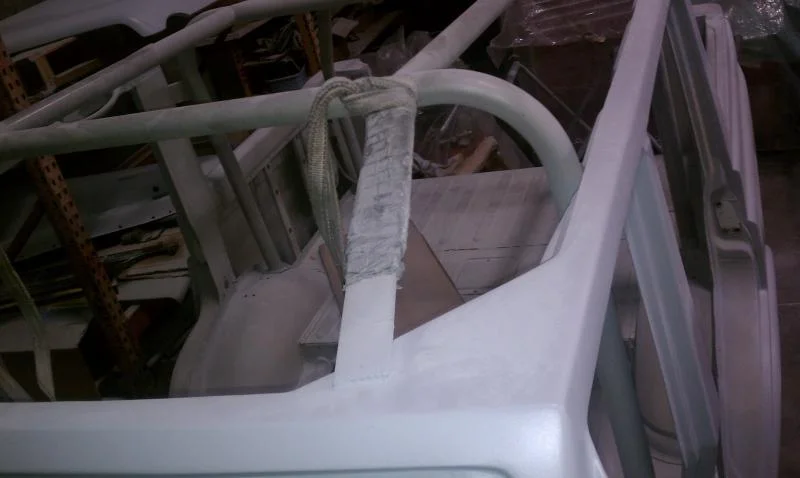

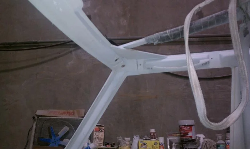

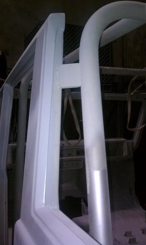

I was saving these for a thread in the new year but here's what I did. It was not intended as a cage by any means.
After removing the roof skin and taking off what was left of the rusted rain gutters. I cut the fore-aft rail between the C and D pillars then cut the D pillars out. Then I cut out just the face and the top of the remaining fore-aft rail from the A pillar to the C pillar. Then I used a 1x3 1/8th wall tube split along the short side to remake a rain gutter and put a 1-1/2x1-1/2 tube to reform the fore-aft rail. The tube used to replace the D pillar is supported in the body by a 5/16" plate shaped to match the contour of the body at the protrusion just above the tail light. everything else is just welded to the body sheet metal.
Roll Cage Body Support
I attached my cage to the body behind the rear door and to the front upper gussets. I did this once before without the gussets and the body cracked pretty bad in those front upper corners.... I'm probably going to change my cage, but I'll attach the body in the same areas. It's held for 20 years.:)
