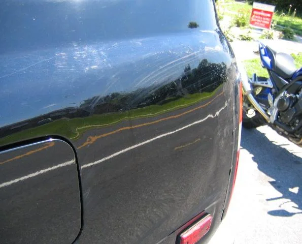

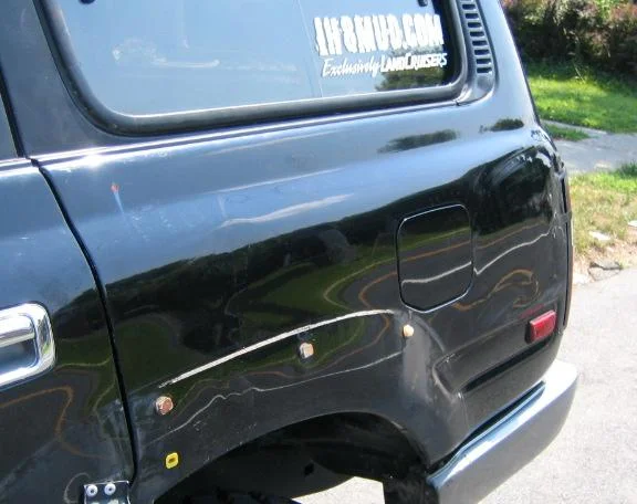

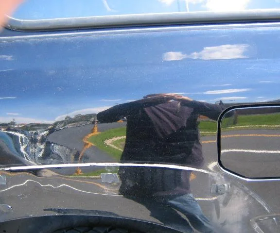

Step 1 so far so good.:bounce: :bounce2: Now for the fun part, try to smooth it out.
Both the rear flares are off and the front ones are soon to follow. Jim and I were talking about shooting bed liner on the body as well as the diamond plate. The repair to the fender is as good as I can get it. I don't think it's too bad for a guy with enough body work knowledge to be dangerous. Anyway here are the pics
How about a little detail. Did you wind up just tapping out the dent gently with dolly(s)? Your paint didn't look bad at all, I imagine you didn't need to spray?
It's a nice feeling knowing that you can fix minor trail bumps! I don't freak anymore over small bumps/scrapes because I know they're fixable. Your body work looks better than mine, though.

I just used hammers and dollies. I tried not to hit very hard and work slowly like every one told me. The pictures look better then the real thing. But after it gets bed liner I dont thimk it will be that noticable at all. Thanks for the tips on the books and video I think I will check them out.
Don't get me wrong, I think you did a great job, just more info to add to the thread.
