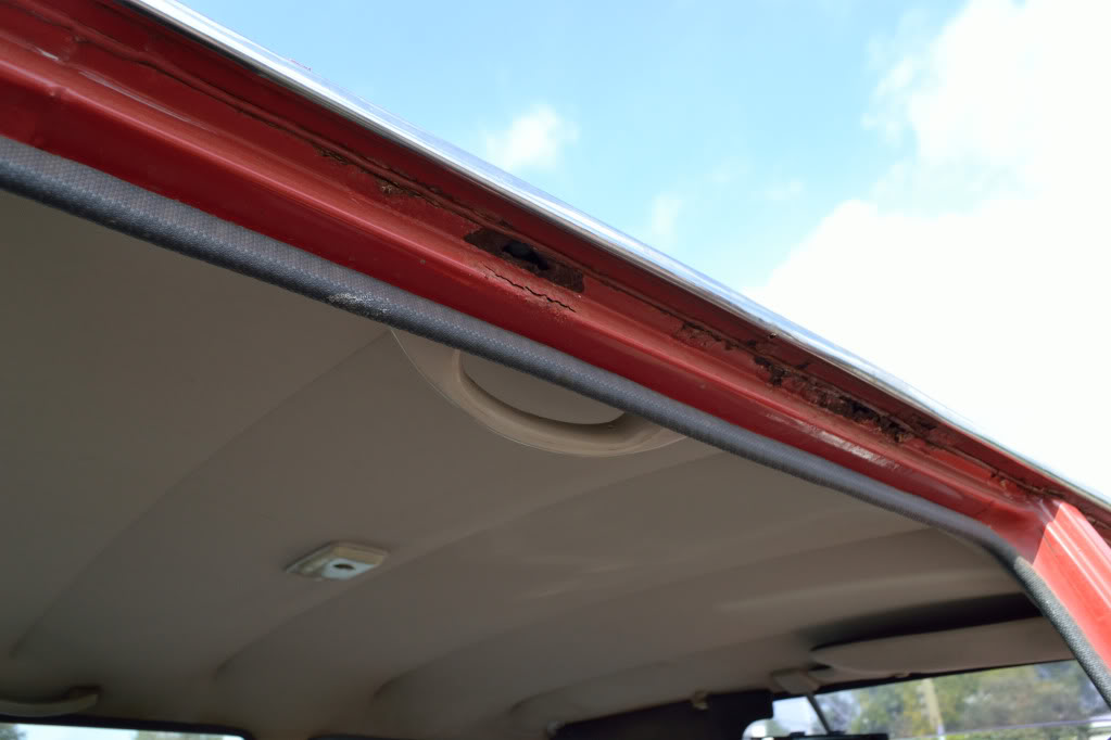

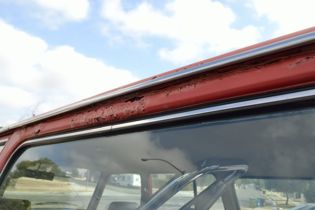

So my relative moved back to his country and left me his 1985 FJ60. By the way this was about 5 years ago. He'd go off-roading when he was here and all but I don't really know much about land cruisers. Anyway, the truck's been sitting in front of my garage for a while now and it's got quite a bit of rust on the sides of the roof. I don't know if it's bad or if I should just leave it. I live in SoCal by the way. The rust has looked like this for years now and it hasn't really spread anywhere.
(or if I'm unable to see it). So what do you guy's think? Is it fine to leave it or should I just sell it? (note: I do not have money for body repairs) If not selling then I plan to drive it to college.

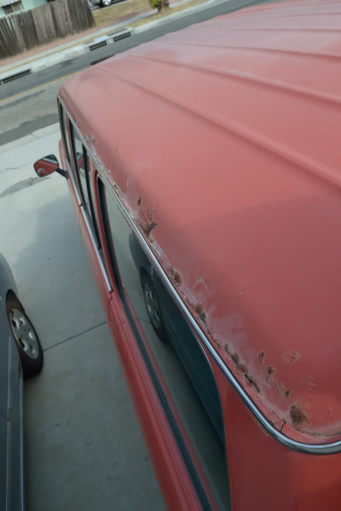

The rust goes all the way to the other end

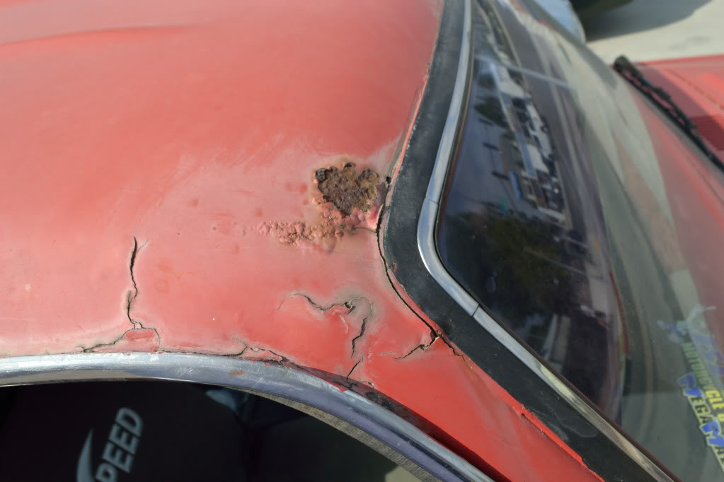

Cracking?
There's holes in that rust...

You have a few spots of cancer there that will eventually need to be replaced. Safety is all what you determine to do with the vehicle. If there are other places, especially in the frame, that look like that then it is better to pass it on to someone that can repair it. It doesn't look incredibly bad but bad enough that you will want to take some prohibitive measures to stop/slow the spread.

Sorry, dude, but you probably need to get rid of it. That cancer in the driver's a-pillar scares the piss out of me. That's a major structural component in a rollover and an important one at any other time. As someone who's dealt with more than his fair share of rust in older vehicles, I can tell you that now is the time to get on that before it gets any worse. Forgive the cliche, but rust is like an iceberg - you can only see a small part. I hate to tell you to get rid of it, but if you don't have the money to fix it then it's best that you cut your losses. Sell it to someone who will hopefully give it some TLC and buy yourself a nicer one after college.

Just saw the pic of the passenger a-pillar (dial-up sucks). Yeah, you definitely need to 86 this one.
Sadly I think you would have a very difficult time selling your cruiser; that rust is pretty bad, especially for CA. Maybe you could sell it if it has an awesome drive train, but I don't think you would get much for it. I would not put a roof rack on, it seems pretty unsafe. Chop the top, put a roll cage in, and wheel it.
