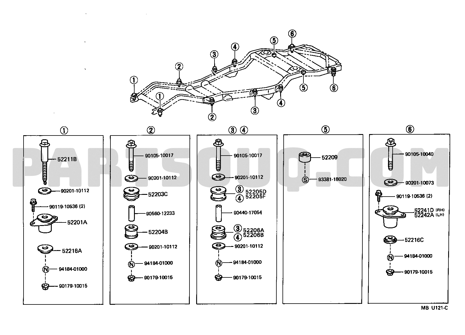

Howdy- 94 80 series. Working on install of a 4Crawler body lift and would like to replace the solid metal “tubes” that run through the rubber cushions on the 2,3,&4 mounts. Can anyone help me out with OEM part numbers, locations, and quantities for the tubes?
I see two part numbers that look like they correspond:
90560-12233 a cheaper “spacer”
90440-17054 a more expensive “tube”
Disassembly gave me the number 2 position on drivers and passengers being shorter while the 3&4 positions on both sides were longer (POs did a few funky things so I don’t always trust disassembly).
Am I correct in guessing that the spacers are for the #2 position while the tubes are for #s 3&4?
Any insights are appreciated- Mike

Think I answered my own question - was able to find diagram at Partsouk:
Thanks Flovaflyer for the link to the parts list.
ordered from PartSouq and it was much less than local or online U.S. cost!
