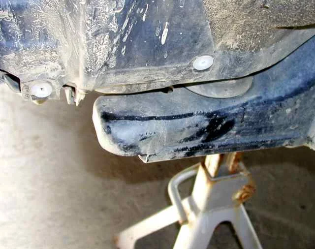

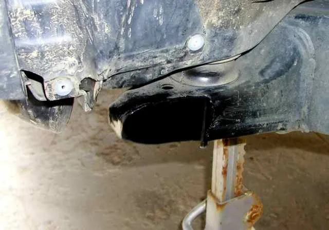

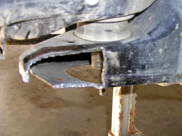

Here's what I did
For the 33s, I only needed about 1/4" chopped.
It helps to have friends with tools and talent.
1) We used a plasma cutter to trim the body mount.
2) We ground the edges flush
3) Welded a piece of plate steel to fill the hole. Wanted to maintain the strength of the frame member and keep tons of crap from being packed into the frame member.
4) Ground the edges down to make it look pretty, sprayed with undercoat and black paint.
5) Voila! No rubbing.
6) :beer:
