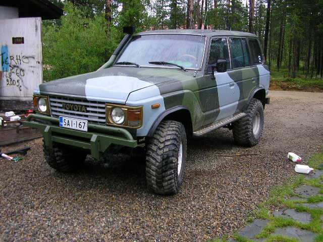

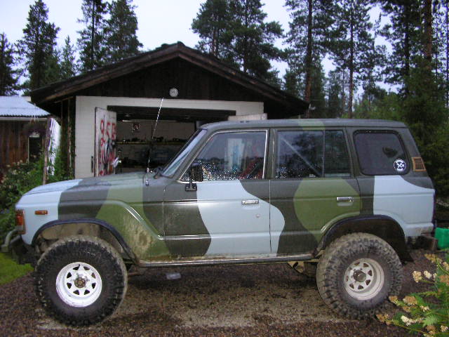

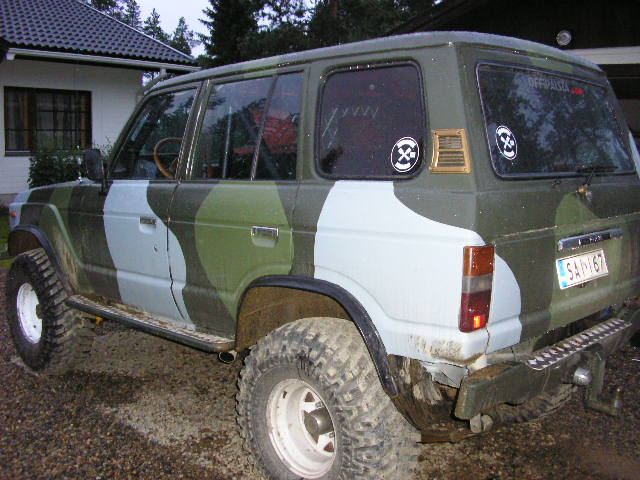

Mine's a 55, but this may work out for 60's too. It's a tank from a '94 Chebby S10 Blazer. The corners are clipped perfectly but I did have to relocate the gas filler to the other side. No biggie cuz I had to cut out the filler anyway since mine is bobbed also. You could just turn the tank 180 deg. & not relocate the filler. I'm currently building a gas tank skid & will post pics on the PIG Preservation Society:
What are the dimensions on that tank?
So it is like a 24 gallon tank then..
Right on..
I need one of them..
Filler is even on the Passengers side already?
Here is also at least one which is taken 37 cm (14.5") off:
