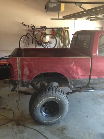

The only pic I got of the other day. Got alot of grinding to do now :)

I like it. How much did you end up chopping all total?
Took out roughly12". You can do 13" on these but we went with 12" so we had a lil extra metal to play with to get the gaps lined up...so maybe 12.25-12.5".
Still gotta finish the hundreds of tack welds left. We got the outside panels about half done and haven't touched the the inside of the bed yet. We could get it done in a good 8 he work day once we get another hood. I will buy one come the 30th so I'll have a good one so I'll have it when I get my new welder. Im borrowing the Lincoln135 were using and a Western Supply Harbor Freight hood. It lasted 10 years so got the money worth. Looking at one from Northern tool thats bout $50 that has 5 star reviews. Has a 1/25000 switch to darkening. I also like the Save face hoods for $100-150. They have some cool looking designs I like. Well see..probably end up with the $50 one.
12" came out and I think it's perfect. I love it.

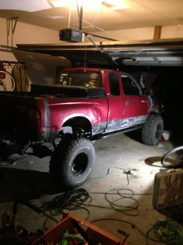

Well the 3 year bob is about finished. Maybe a Lil more grinding, some more welding on a few spots and done. By the time we monstaline the rockers and over the weld area it won't be noticeable at all. The new tube with receiver should be in soon and we can mount it and cut off the extra frame and be some other than the cosmetic portion but hopefully next pay day he will get the bed liner and we can finish and touch up a few other neglected areas.
A little pic b4 the monster liner
