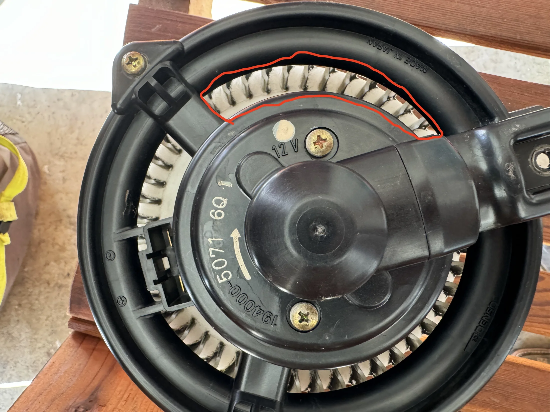

I've been chasing down a chirping noise in my front blower motor and decided to take the fan apart to clean it. Unfortunately I busted the motor housing while tapping (ok, smashing) the shaft with a set pin to remove the cage.... ooops.

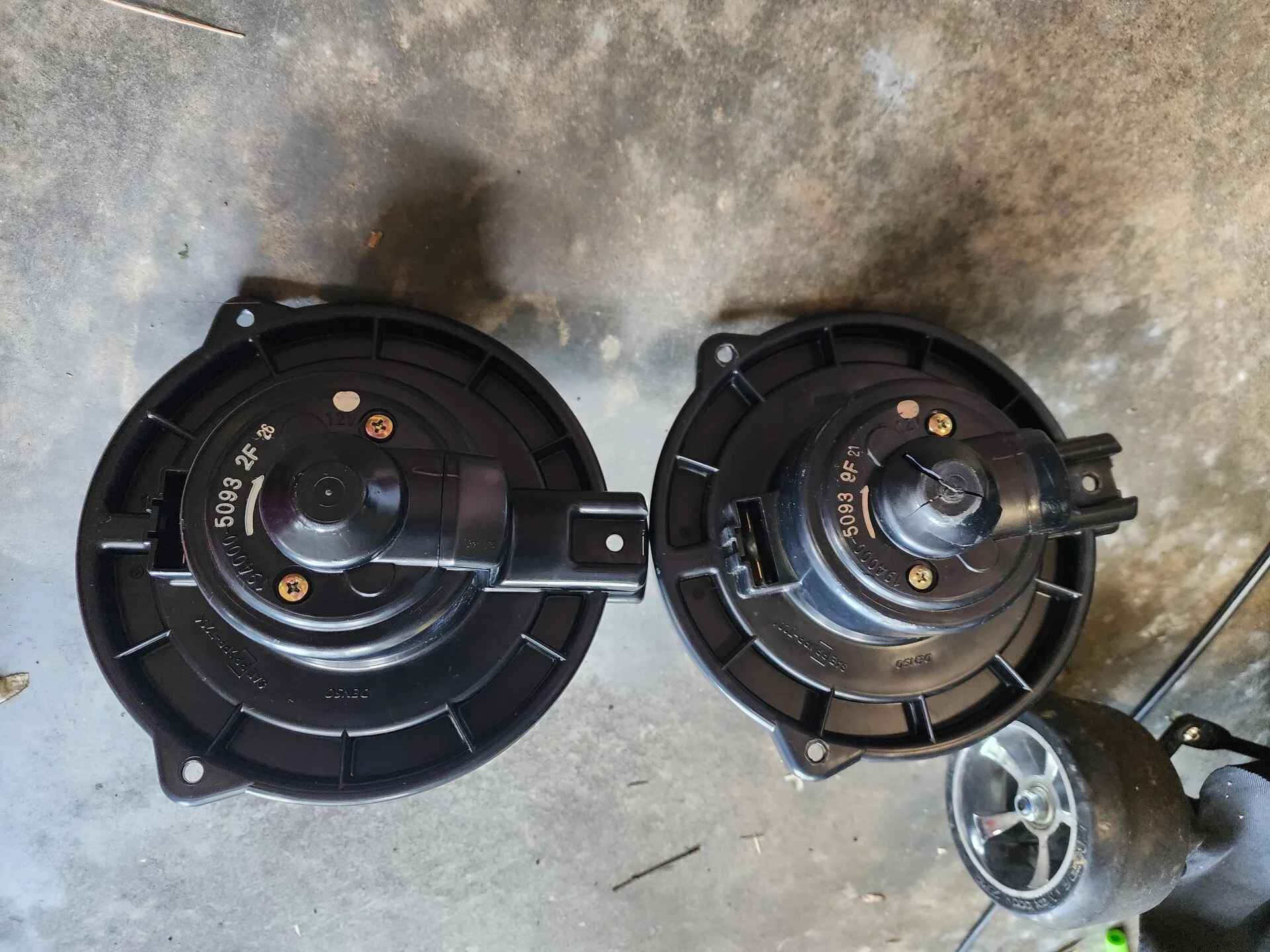

That's a good find. Does it say Denso anywhere? Looks NON-Chinesium (from the two golden bolts with a dimple on its face: only seen in Japanese bolts). I have also knoncked off the bottom part of the housing while trying to remove the cage. I ended up pulling a used fan from a junked car for $10, still the old one works and makes a small sound at low speeds. For $35 shipped is not a bad deal.
I ordered one last week, will post side by sides when I pull it out.
Yes, made in Japan Denso motor.
Perfect replacement.

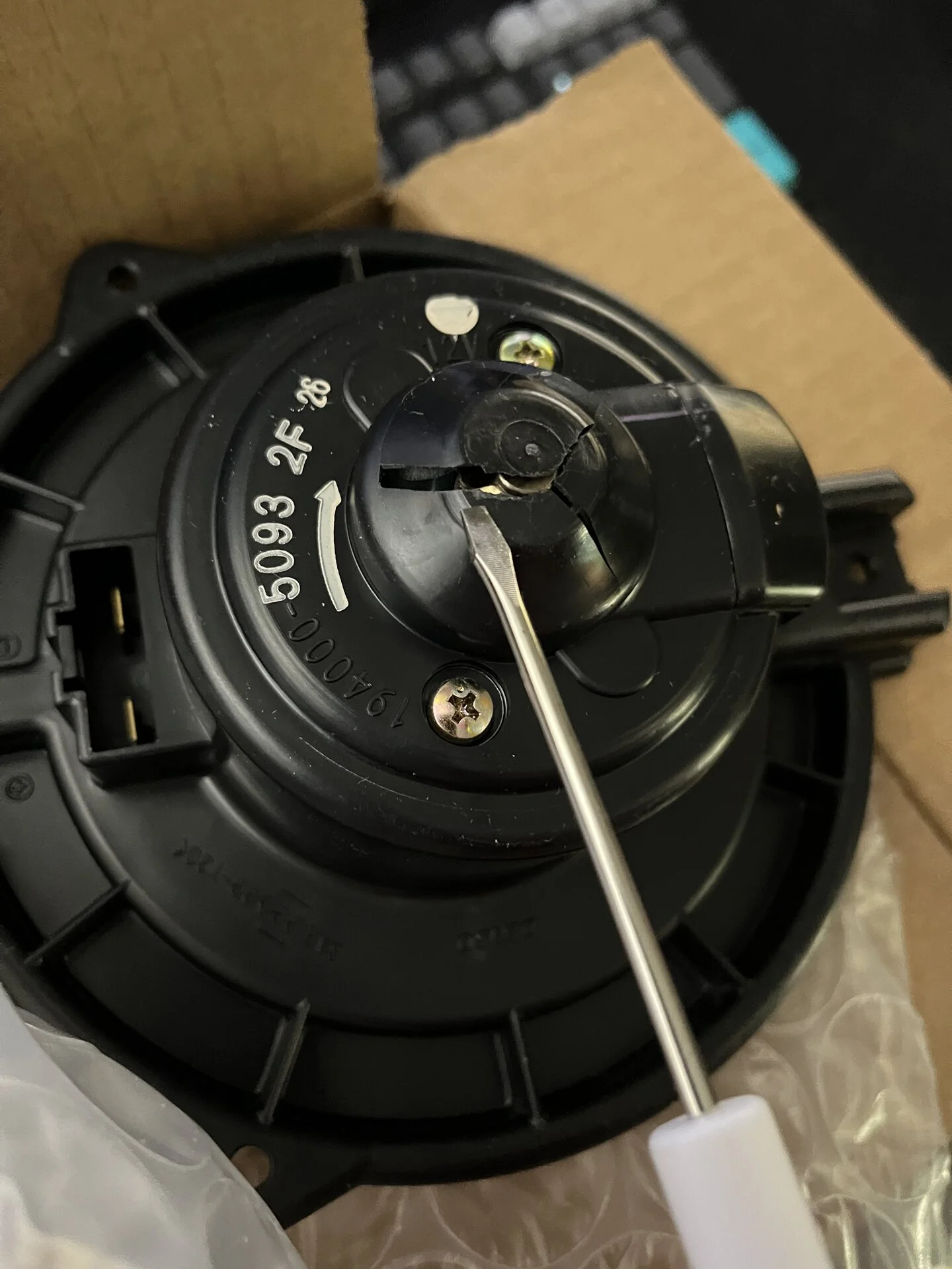

It was a bitch, and I ended up destroying the old motor doing it, but it was being replaced anyway... First you remove the small clamp (easy) and then I used a mechanic's pick to pull back the lock tab on the wheel that attaches to the shaft. While it was lifted up, I lifted the wheel by putting two long screwdrivers between the motor casing in opposite directions of the wheel and pried it by pulling on the handles of the screw driver.
Once the wheel was past the groove on the shaft, I tapped on the motor shaft with a hammer and set punch to finish the job. This "tapping" cracked the back of the motor casing (and that can be seen in the first picture above).

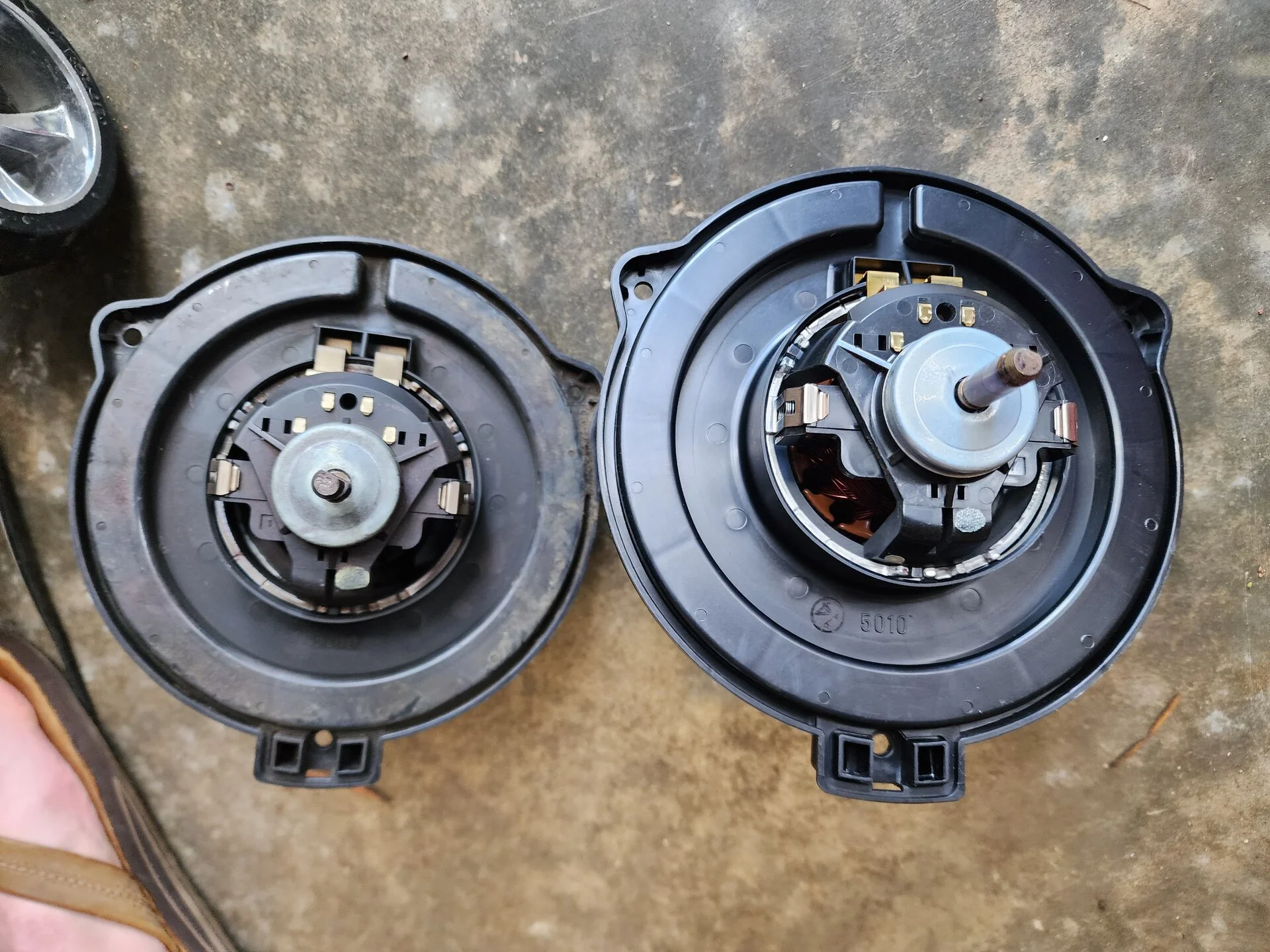

Well my new one looks like your old one upon delivery…sad day.
It looks like shipping dropped it and the needle side hit the ground and pushed back up through the plastic.
That's totally what happened. I say that because I was beating the crap out of the shaft on my old one with a hammer and that's what mine looked like. Sad, that's 1 less good motor.

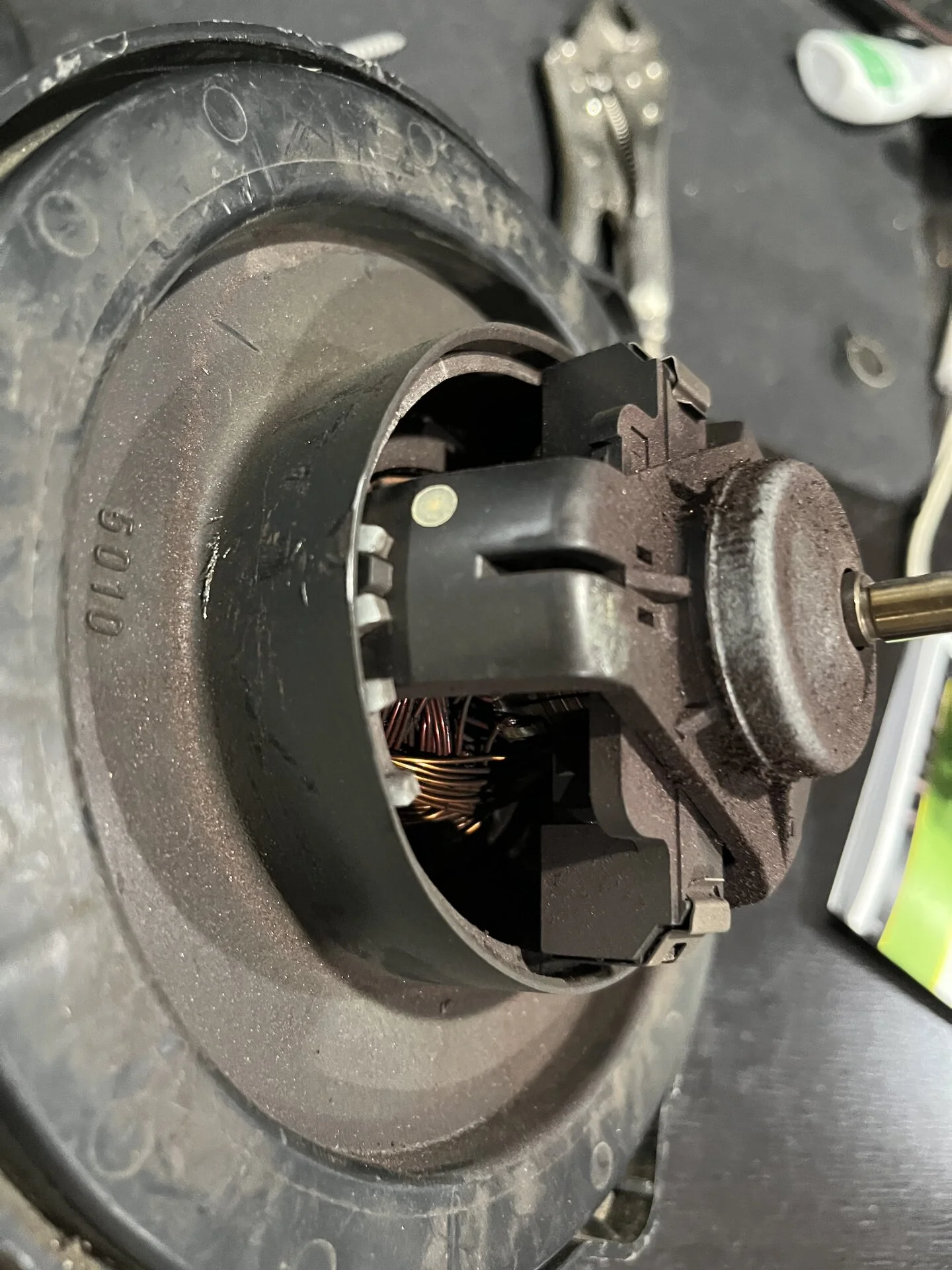

Edit: Installed new unit tonight. Here’s what the old one looks like, carbon like an abrasive saw.
To remove the cage I took my die grinder with a small bit and put a small mark on the top, after that I grabbed a small hammer and pin and slide the cage off.
Another person or two skinny metal plates would be helpful to support the cage and let the motor hang below.
