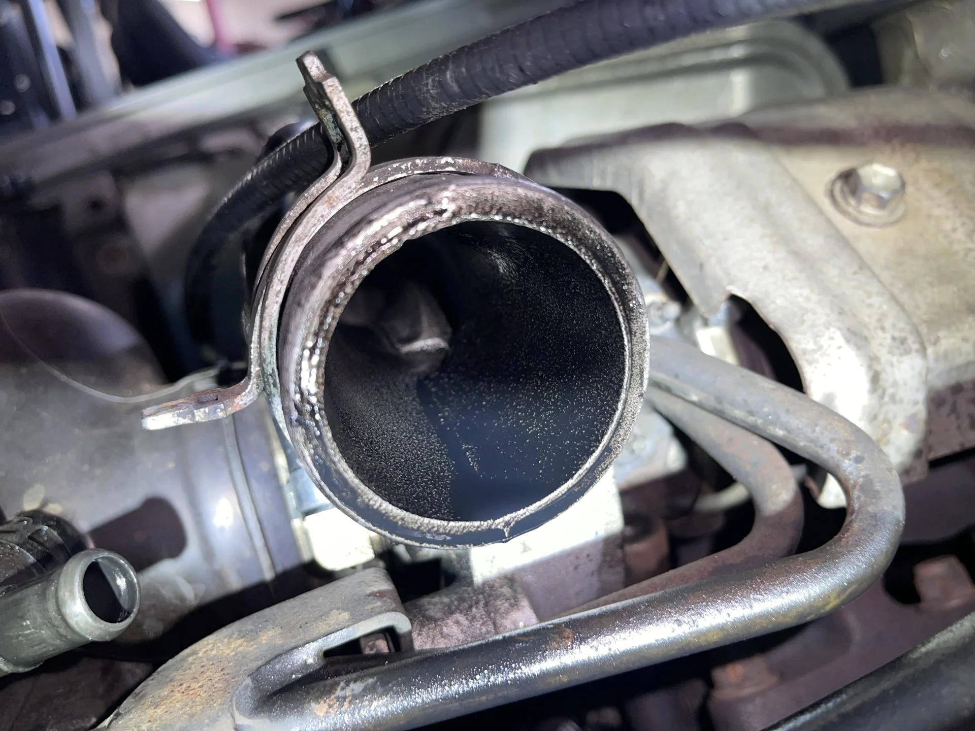

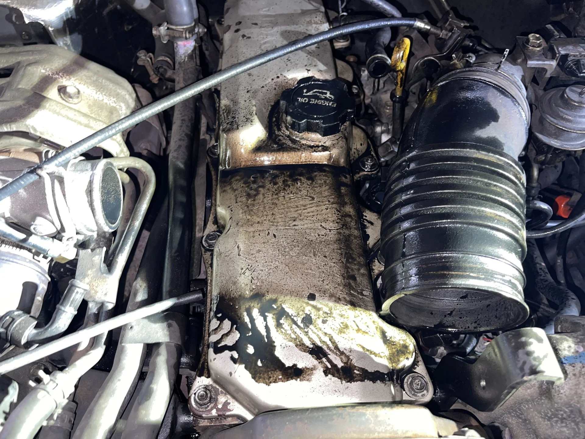

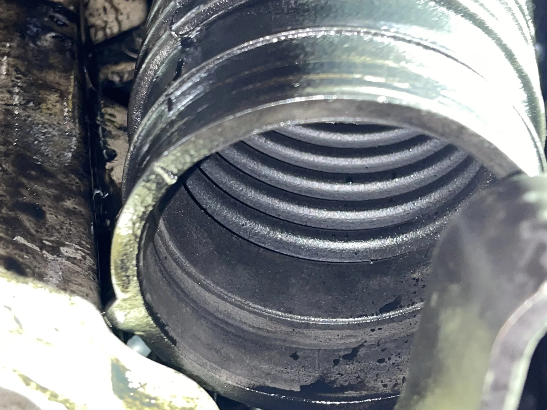

LJ78 2LTE in CA purchased back in 2019. EGR delete done at home and smoke was minimal. Drove great aside from an oil leak and would die after a long hill when letting off the throttle. 3rd and current mechanic traced oil leak to the fuel pump which was resealed. Car now smokes worse (blue gray) and has zero power. Current images of blow by in turbo. Mechanic is suggesting new turbo or rebuilding, however previous owner has confirmed new upgraded heads, turbo and timing belt were all replaced. Have a lead on another mechanic in Burbank but was wondering any thoughts or recommendations?

I'm not too familiar with the 2LTE and the exact symptoms of what happens when the 2LTE head overheats, but this probably is one of the symptoms of that very common problem with the 2LTE.
But, If I were you, I'd ahead and pull the engine out (it's not super hard to do and I find it much easier to work on the engine with it out anyways), strip the accessories off of it (AC/Power steering etc), check the timing belt, then take the whole head off to see head gasket and check for cracks. While you're doing that, I would probably go deep into the abyss of IH8MUD to see what other people have done to fix a 2LTE, but I would probably also get a 3L head, full engine rebuild kit from Australia, timing and h2o pump kit, and a mechanical boost compensated injector from Australia and some how ditch the whole ECU system. While you're waiting for parts, try and find a machine shop that's willing to work on it.
