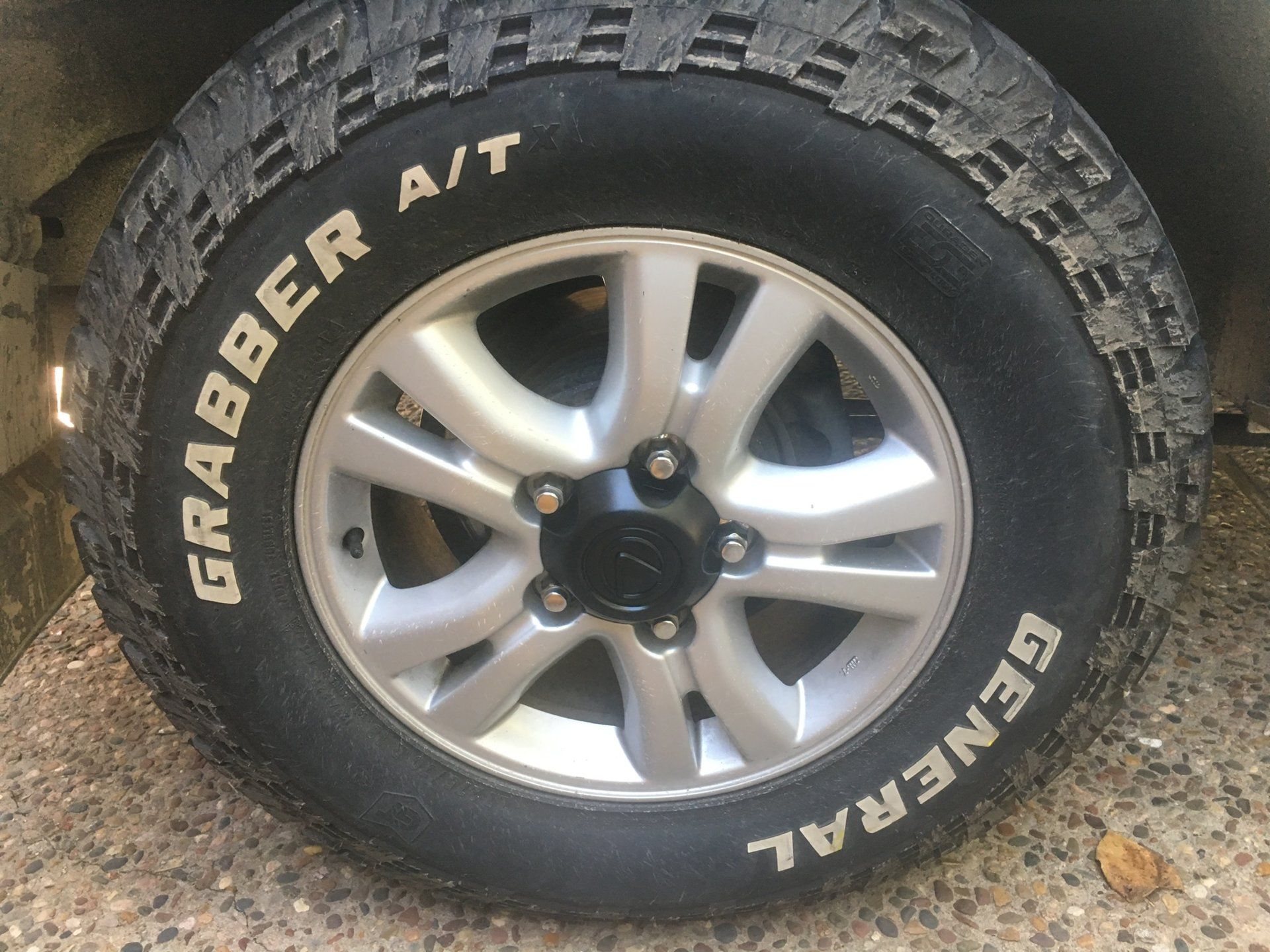

Finally (a year later) upgraded the tires to 275/70r18 General Grabber ATX. I purchased five with the intent of doing a five tire rotation. Haven’t had them off road yet- probably will be a while for that. They are real quiet on the road, just a tad louder than the stock tires that were on it. Great looking tires. Really helps delete the soccer mom look!
View attachment 1892480 View attachment 1892481 View attachment 1892482 Finally (a year later) upgraded the tires to 275/70r18 General Grabber ATX. I purchased five with the intent of doing a five tire rotation. Haven’t had them off road yet- probably will be a while for that. They are real quiet on the road, just a tad louder than the stock tires that were on it. Great looking tires. Really helps delete the soccer mom look!

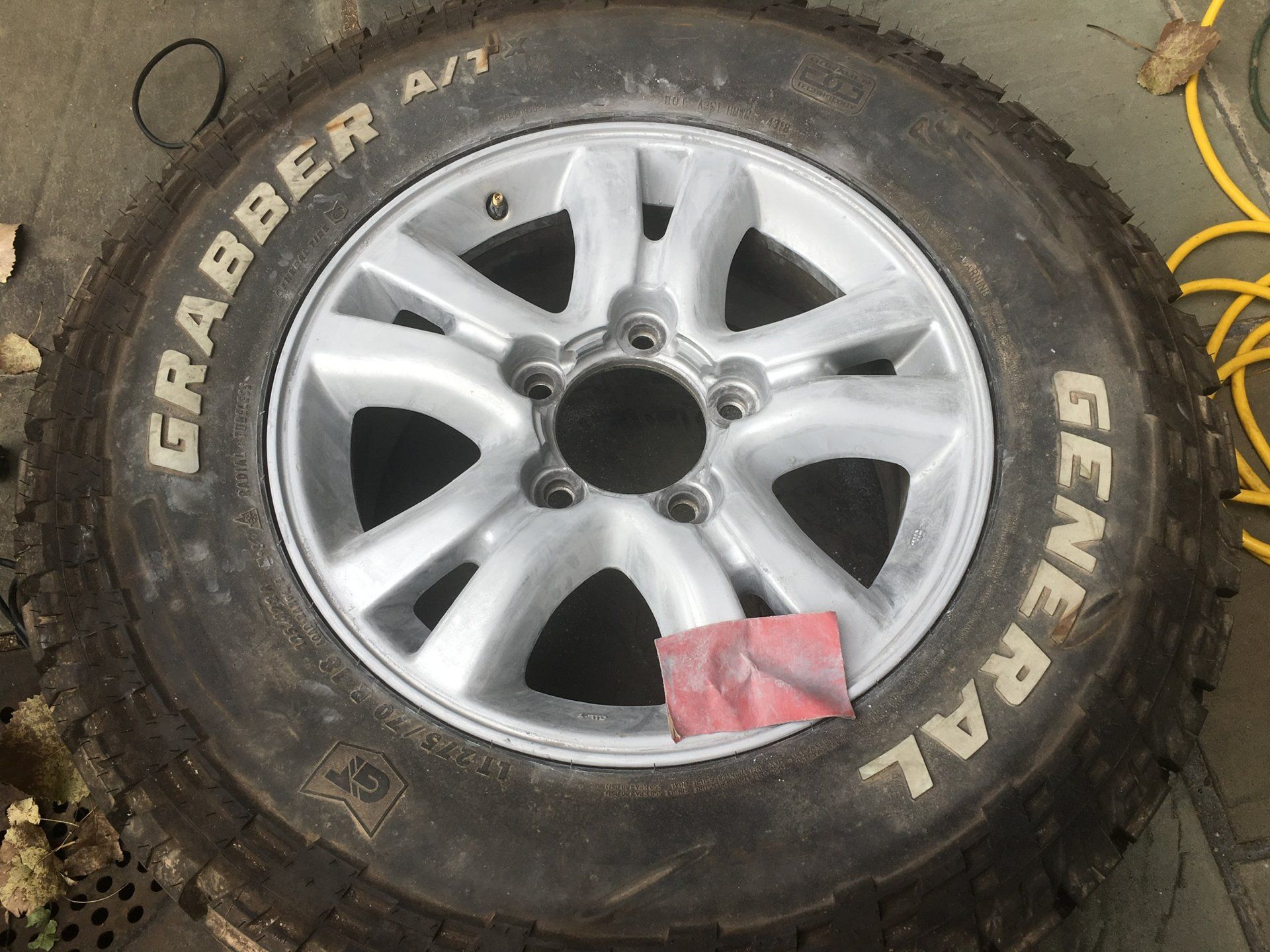

Painted the wheels over the last couple weeks. The plasti-dip I’ve trailed for a while on some emblems has started to peel and have a cheap appearance. Also I wanted a semi-gloss black to match (as close as possible) the existing OEM black trim. Based on results, I’ll be painting all the trim and chrome, including the front grill that was plasti-dipped and the chrome stripe down the side.
Sanded with 400 dry.

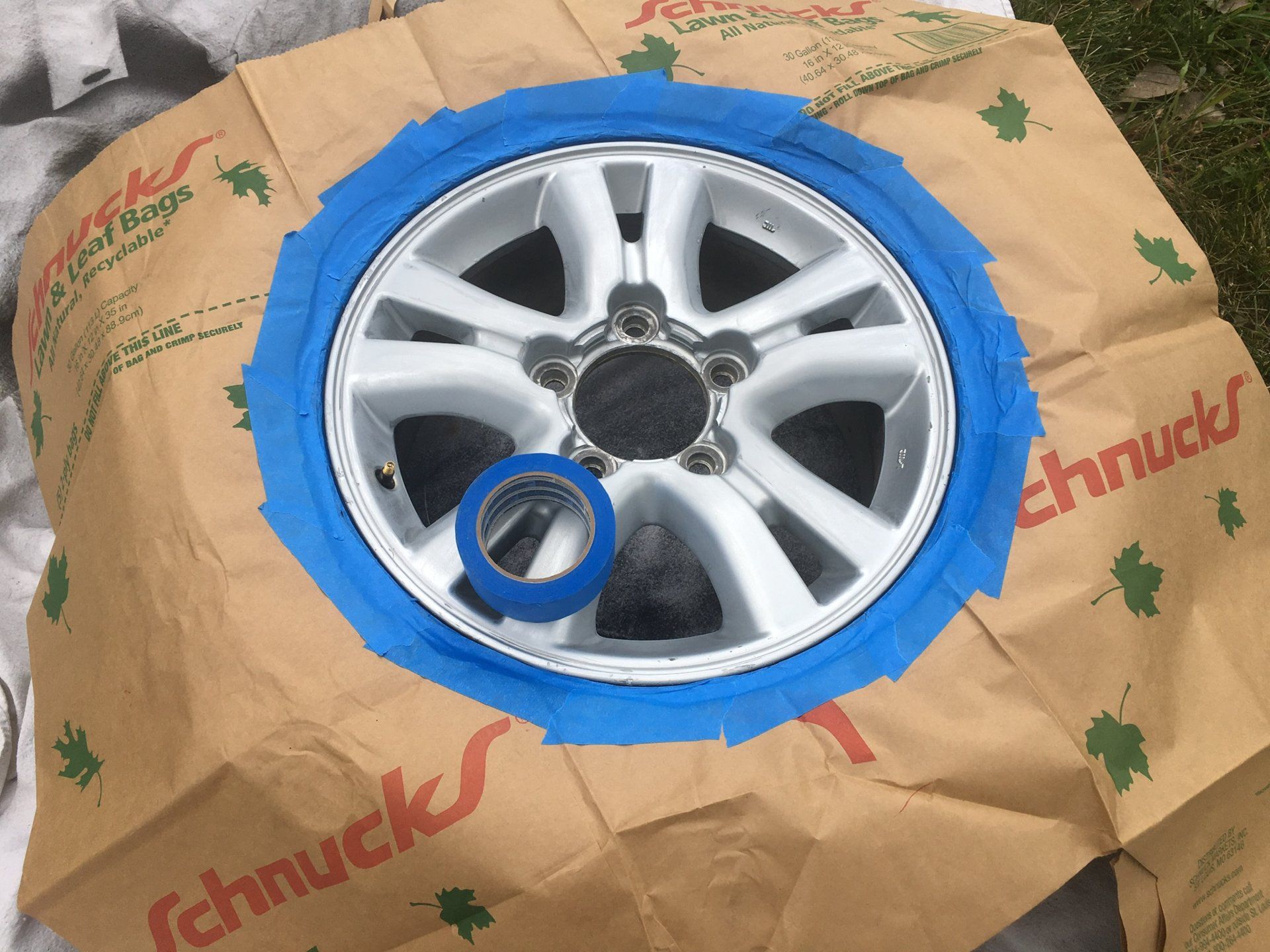

Masked off and about 5 coats of Rustoleum self etching primer. We‘ll see how it holds up.
Wrong order but prior to primer obviously.

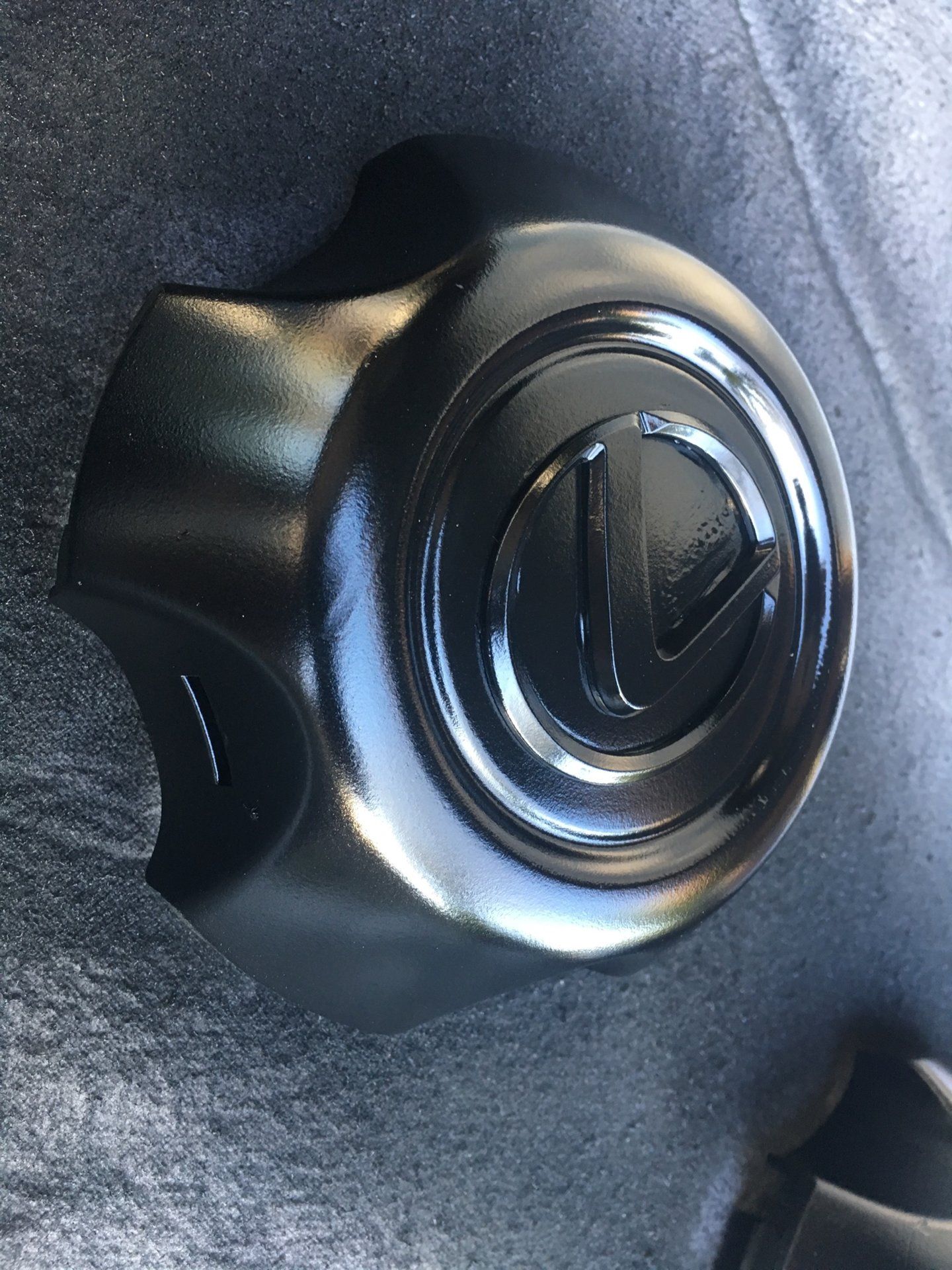

The topcoat was Rustoleum semi gloss black enamel. About 5 coats all said and done.. No clear so I can theoretically touch up if needed.

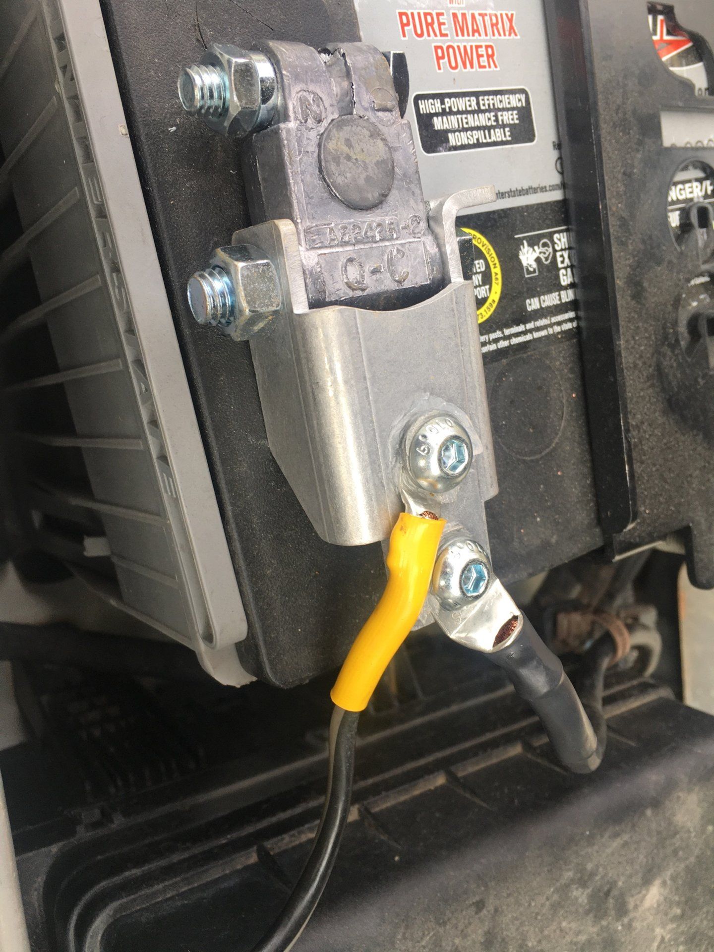

Replaced connectors on cables for negative terminal with military terminal provided in Slee Group 31 battery tray. Bought the connectors and tool off Amazon, then loaned to my daughter for her van build.

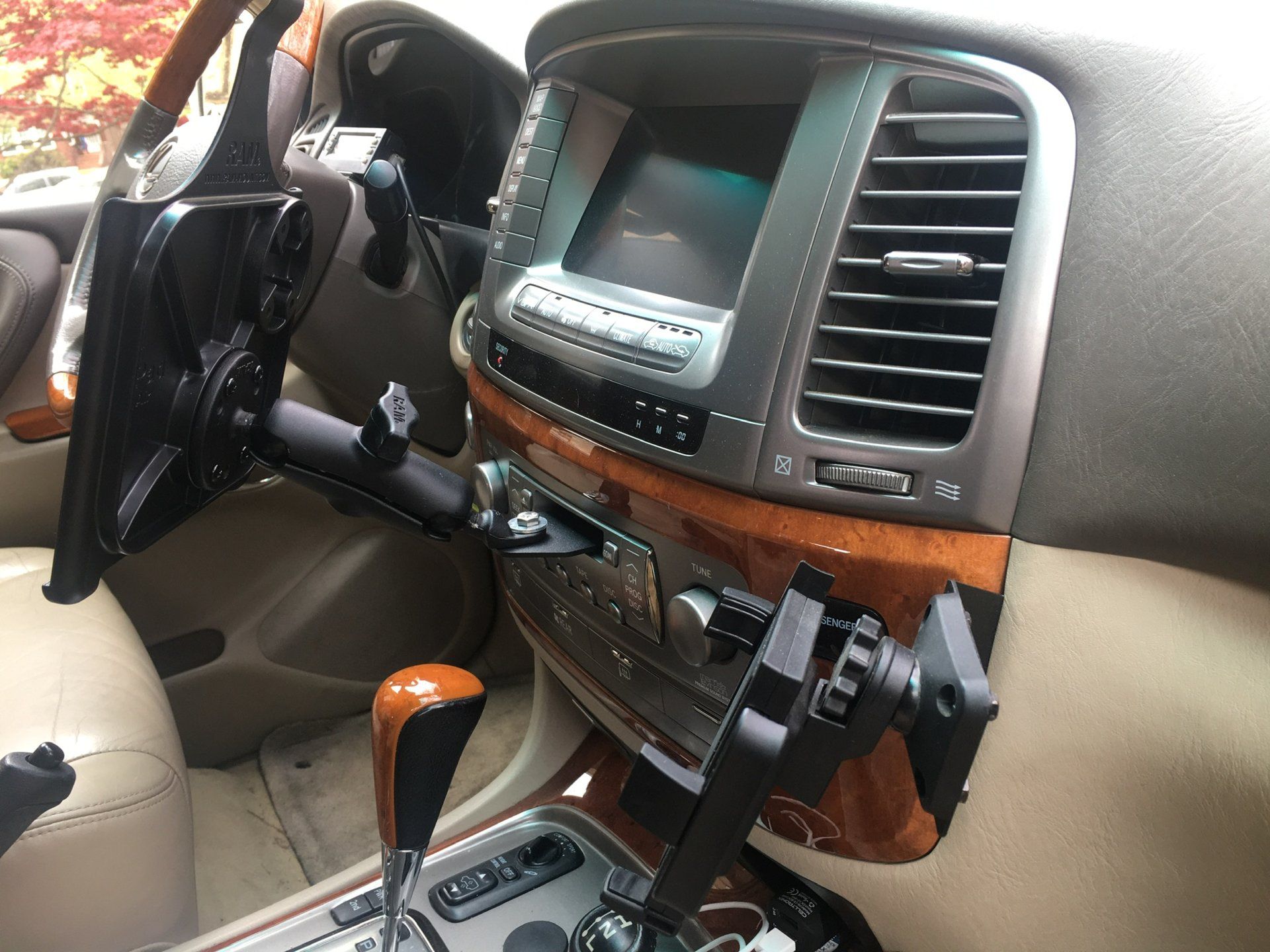

Got the RAM iPad (Air 2) mount to use with the Owl Expedition mount from Amazon.
This was an easy :banana: job. Just pull the trim pieces (I use the plastic trim panel tools), then remove and partially disassemble the console / stereo / nav. Don’t lose one of the screws down a vent...:bang:
Install complete with RAM adjustable arm.
The iPad Air 2 up and running GAIA GPS (there is no better).
Closeup of the Owl Expedition mount.
View attachment 2283359Replaced connectors on cables for negative terminal with military terminal provided in Slee Group 31 battery tray. Bought the connectors and tool off Amazon, then loaned to my daughter for her van build.
What is the piece bolted to the military clamp? Do you have a link? Thanks!
Slee makes aluminum extensions and sells them with their battery upgrade kits here: Slee Offroad
Not sure that they sell the extensions alone but they do come with the military terminals that they sell.
