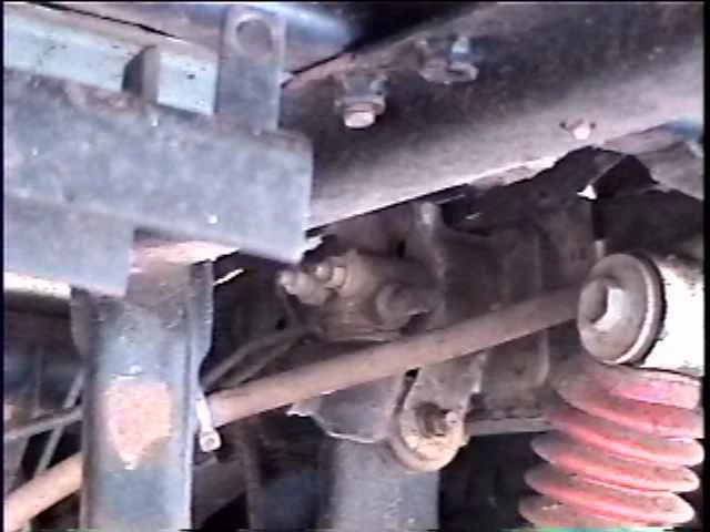

can someone post a picture of this setup? i bought my truck with a flatbed and was wondering what that looked like. right now, i just have a rod sticking out of the valve.
thanks.

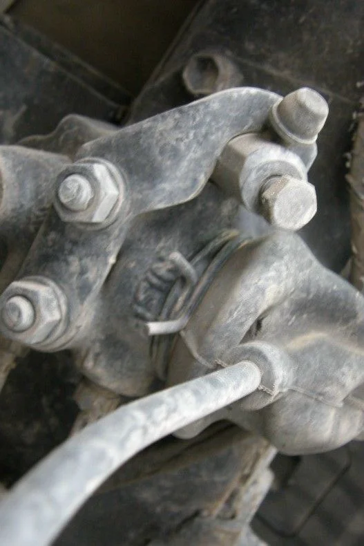

Mine's slightly different for the year but I've got my bleeder by that part of the LSPV. Both year LSPV's seem to have the other lines running the same. It looks sort of like the red circled part used to be the nipple.
Yup, mines the same.
Looks like the red circle in the photo is the bleeder.
Maybe yours broke and someone simply replaced it with a bolt.
Hard to tell from the photo.
Fred
The metal is pretty clean, like what you see when a bolt breaks. Tiny rocks pepper the hell out of parts down there.
Howdy! Mine looks pretty close to that. The red circle should be the bleeder, and the other one is just a nut/plug fitting, maybe for a pressure bleeder, or a check valve? Mine's a long bed, if that might make a difference. John
Loosening the bolt lets you bleed out the nipple which should be right next to it, under a rubber cap. This is unlike other bleeders, where the nipple itself unscrews.

Howdy! Hmm, well so much for that idea. The block you are describing sounds like it could just be a "T" junction box. Does it have anything else on it like a set screw or adjuster in the middle? Does your rig have the valve under the rear end like the pics earlier in this thread? Check all the hard line to the right front, looking for crimps or bends that were not originally there. Like something that has been moved to make access easier for maintenance. Good chance it would be at a mounting bracket, and that would be hard to see without removing the rubber grommets that hold the lines. Braking pressure in the line is much greater that the return pressure after you release the pedal. Are your calipers "hard" mounted to the knuckle like earlier trucks, or are they "floaters" like Chevies where they can move lefty righty on two large pins. If floaters, then pull the pins and buff them up with some fine sandpaper in case they are dragging. John
