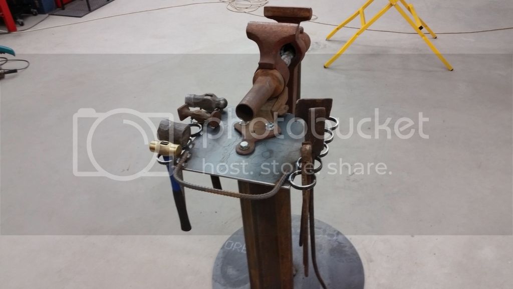

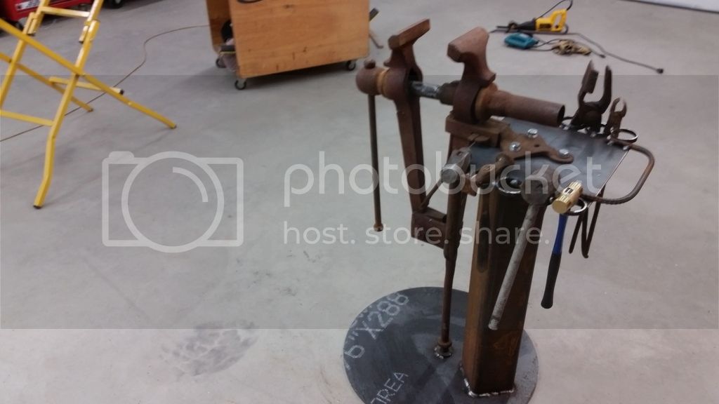

I just finished making a stand for my post vise:
I used 1/2" plate on the floor and decided to cut it round so that I can roll the vise from location to location. The pedestal is made from 5.5" 1/4 wall square tubing (box tubing). If the vise moves around lots when I start using it, I'll fill the pedestal with sand. I mounted the pedestal further back so that my own weight standing on the plate will keep it stationary when I'm working. Worst case I drill holes in the plate and insert some anchors into my floor.
I also used some left over pipe to cut the rounds for my various hammers and tongs to hang from etc. The rebar at the back also serves to hang tongs but is a convenient handle to help move the vice.
The vise is interesting itself. Its spring is in good shape and the 5.5" jaws look like they have never been worked. However the box on the back is modified. It has a section of pipe welded to a massive nut. This pipe protects the threads of the screw. Most that I have seen have a fancy finished box - not a piece of pipe - works great though and has about a 6 inch opening.

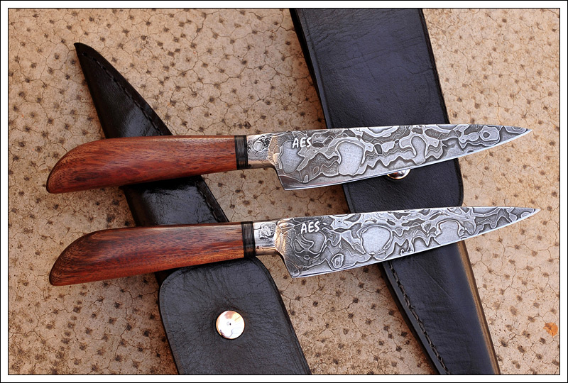

Great idea - I also want old timing chains
These were made from timing chains
Wow, that is beautiful. If you can pull that off I'm on the waiting list ;)
