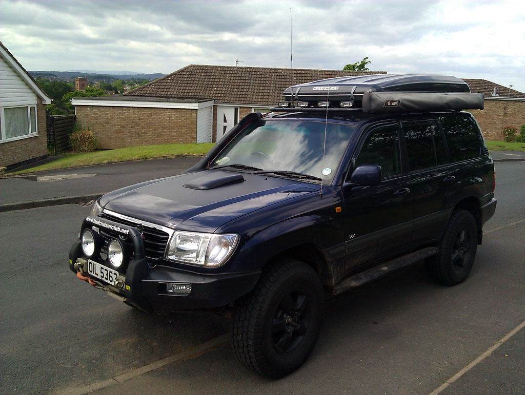

Fits RHD trucks as well :rolleyes:
I can't get my truck in the garage and it's windy here at the moment so I had to make do with a tarp for shelter and at times it was a bit stressful when the vinyl would start flapping about and bits of dandilion sead were somehow still getting under the tarp! When I was peeling the backing off I kept stopping to spray what I'd uncovered so far and it paid off because it did fold over on itself a couple of times :frown: Turned out ok but I don't know how :D Oh and don't forget to reconnect your windscreen squinters when you're done :o
jon/wildsmith...i'd still prefer it to cover a bit more forward of the bonnet/hood than it does in your pic. yes yes personal preference and all that. I've already seen isotels pic where it makes it look silver thus doing its job! Even with postage his is cheaper than local here by far!
Anyway. Whats that scoop for? Intercooler?
cheers
peter
I like that it isn't any longer, first because it's a handful at its current size and I don't think bigger would be a diy job and second I sometimes have an event organizers sticker in that remaining space that comes off after the event which would be a problem if it were on top of that vinyl.
The scoop is for cooling, has a 10" fan under there and there's another one in front of theATF cooler. When the rad is clean no extra cooling is needed but on some trips you can't help but get the rad clogged up with mud and it always seems to be hot when that happens and you have to sit with the heater on to keep the engine from overheating, no thanks!
jon i drive mine to work in Melbourne and sit in traffic for f'ing many many minutes where i am sitting there in neutral, and just listening to the radio and mine never overheats. Even in Melbournes horrible 40C + temps...
Stock everything except the highly modified exhaust and the exterior mods of course. Why would you need the scoop and the fan ???
just curious
pm me if you want
peter
aaah EDIT....radiator clogged with mud.....got it. Mines a daily driver and a "weekend offroad warrior"....although i've been stuck at 7pm on a Sunday in the dark and needing to go to work Monday. I get what you mean.
Although, can you post on here what you did re: the scoop and fan? thx - different thread maybe? if you have already slap me around with a trout and point me to it? ta.

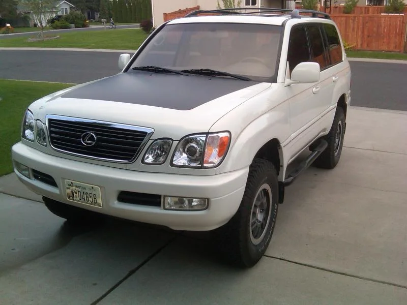

Finally got mine!!!!!!
After much deliberation and research on getting the compas added to mine, I gave up and went with the standard one. I think it looks great and makes the LX look sharp.
Looks great - did you have any trouble removing the wiper nozzles?
Take your time with a pocket size screwdriver, and it will pop right out, two tabs front and rear, get one side out just slightly, then pop the other out. make sure the DS goes back on that side so you dont have to re-aim them
up5799,
they were easy. A small flat blade screwdriver and a little wood wedge 1/2 the thickness of a pencil to pry against. A little in the front then a little in the back. Don't disconnect the hose at the nozle, Go to the next junction and disconnect them there as they are almost impossible to re-attach at the nozle. Not enough play.
Go for it, as it is easy. The vinyl is a little challenging to work with and it takes two to do it right. After i got mine on, i put it in the sun and it started to bubble. I ran some errands and at each stop (10 minutes) i would take a soft cloth and work out the bubbles. Now it is on there to stay.
