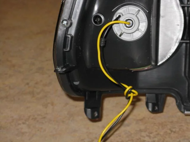

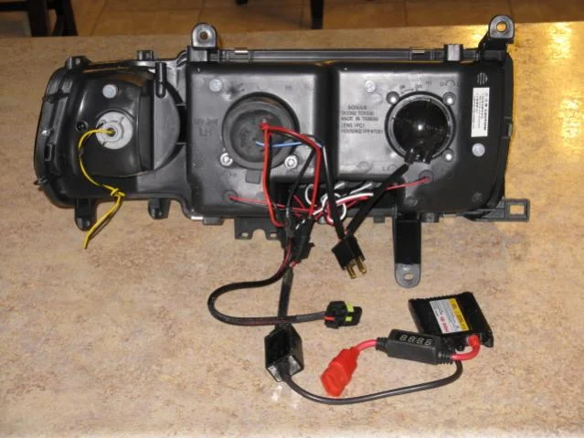

I have seen on here a write-up of wiring these.... I searched and can't find it.... Any help???
I assume the black and yellow wires get tied into the factory side marker lights?
The small gauge black and red wires that light up the Halos get wired to??? Tied into the front marker lights?

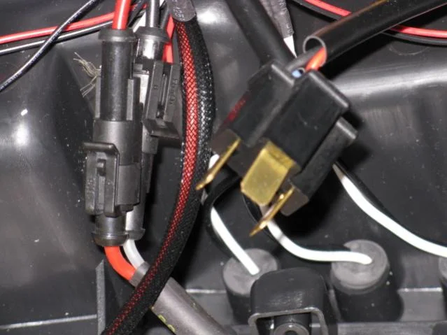

The three sets of black and white wires that light up the three lower "Cat Eye" lights???
Does the three prong plug plug into the stock headlight harness???

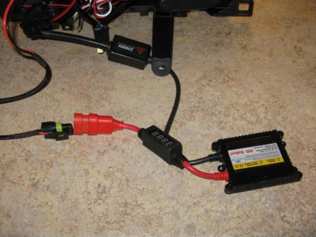

Does the red plug on the ballast plug into the black plug that I have next to it in the below photo?

Those ballasts are pretty dang small!!
