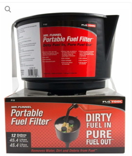

I use Black diesel, filter well and lots of gravity waiting time mix with 50/50 diesel
Most my bulk oil is settled then I run it thru a Mr Funnel it claims to be a 50 micron and also separates water and derbies.
Then I run it thru an old toyota fuel filter off the cruiser.
I’m not doing large quantities of oil so this works for me. I do plan to upgrade to a centrifuge. But so far everything’s been good.
I’m not doing large quantities of oil so this works for me. I do plan to upgrade to a centrifuge. But so far everything’s been good.View attachment 3338007
Interesting contraption! Thanks!
