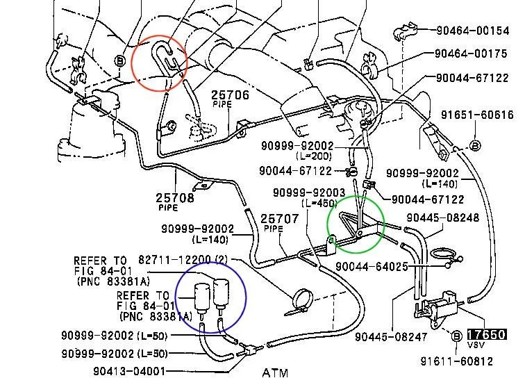

Check your hoses. There are two pressure switches that connect to crossover tube between the butterfly and the turbo. They turn on the green and red lights when they get the appropriate pressure. You probably have a leak. Cody is right. You'd know if you had no boost.

Anyone found a NA supplier for small vacuum hose clamps that actually fit?
I have been using small zip ties on the hoses - but they do not work very well.
I would like to put small clamps on my maze of vacuum hoses as they often fall off when working on the engine.
Toyota part 90044-67122 as shown on the diagram in message #5
That part number does not cross with anything North American - that is why I am looking for after-market.
