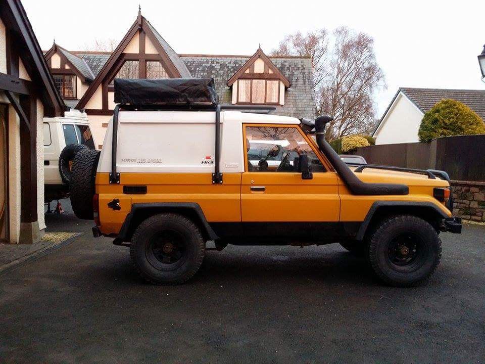

In my opinion, the best way to run a tent up top would be to do a mini exo-cage and put it to the body like this. Maybe triangulate it a little better but then you aren't dealing with old fiberglass.
Other options are a mix of that that may work.
lc70widefender6-jpg.342999
24-home-away-from-home-jpg.69760
