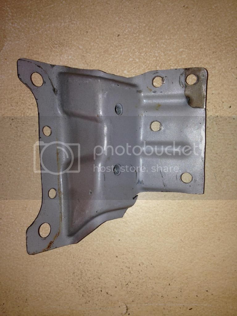

Any one here knows where i can find this bracket the one i circle in red? its a bracket for the accelerator pedal. I need one for my conversion from RHD to LHD.
Says on your profile that you are from the philippines. Have you tried WAS autoshop? Its in banaue, quezon city near Dr. Fe del Mundo medical center. That's where i normally get my parts. By any chance are you that guy riding a green sports bike near merville? The one that asked about converting from RHD to LHD?
Im from Bacolod city. I dont know if thats the the pedal assy? I jneed the base i think the part is bolted to the bottom of the steering column and welded to the transmission hump. So that you can bolt the accelerator pedal properly.
From memory when I rebuilt a 70 of mine that bracket doesn't exist. There is a smaller bracket that bolts up to the firewall but nothing of that size. I have many spare accelerator pedals if you can't find one give me a buzz
Thanks NZcruiser for the offer, But i have the accelerator pedal. My problem is because i converted my PZJ70 to LHD and without that bracket there is not enough space between the brake pedal and accelerator.
Check the throttle from a 62 series LandCruiser. I used one for my diesel swap into my 60. I looks close and the 62 part has the hand throttle cable mount also. The 62 throttle cable end fits many diesel pump arms.
Check the part out section. I bought the pedal assembly with throttle cable and the hand throttle with cable for $25.00.
