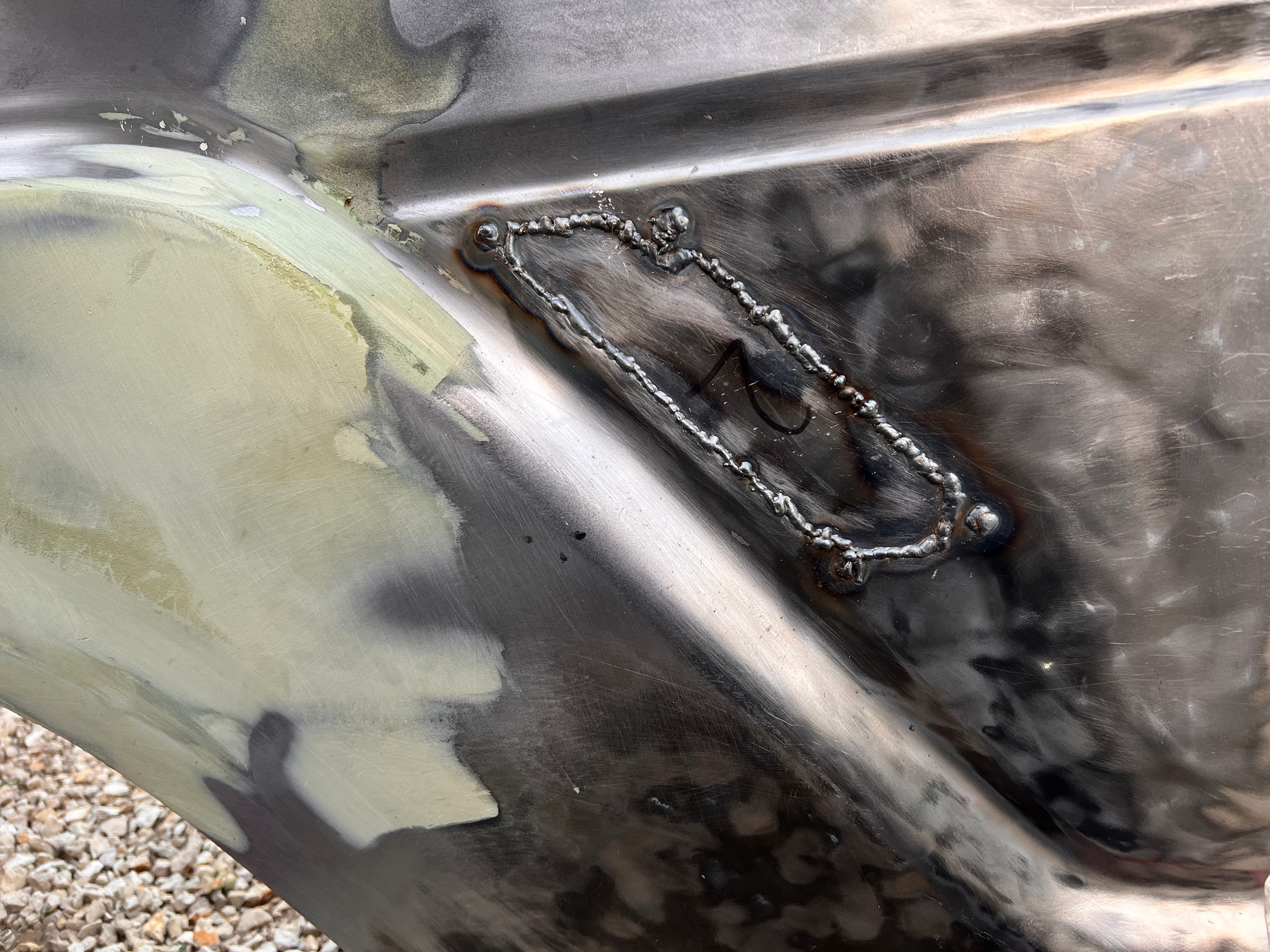

Lastly, I "converted" my fj60 replacement fenders to bj60 fenders--no more vent. I prefer the no-vent look, but they all look good ;)
