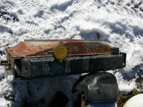

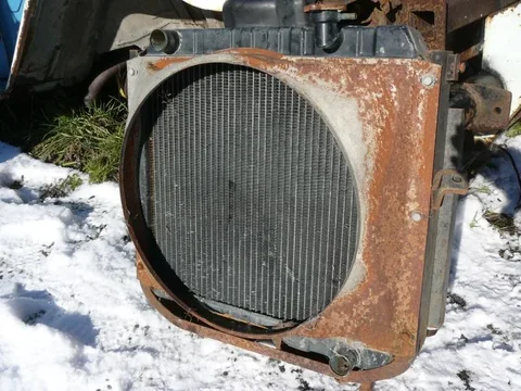

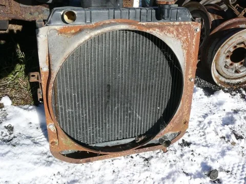

Here is what I have. It's not deep, but it is well centered.
