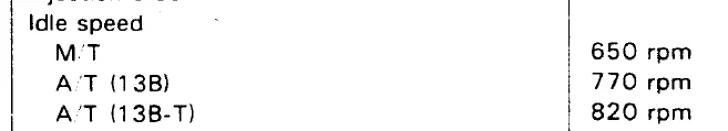

Thanks guys for the response. Fedtime, yes it smooths out when the rpm increases. I will try to increase the idle...though what rpm should it read on idle?
650RPM
From the Factory Service Manual
