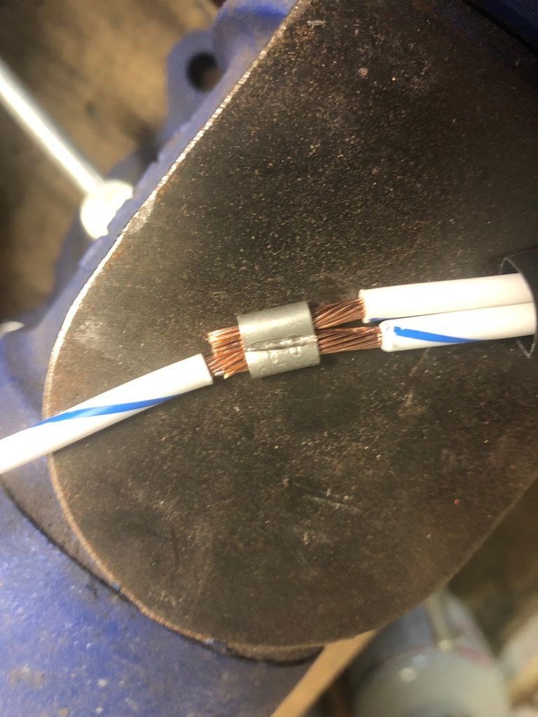

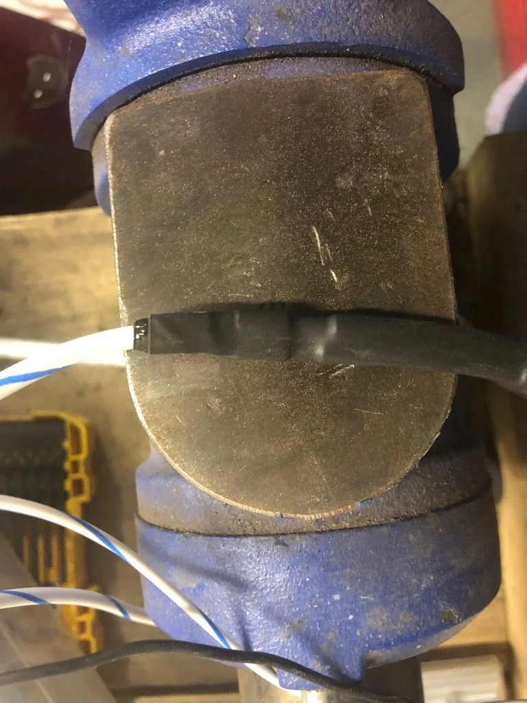

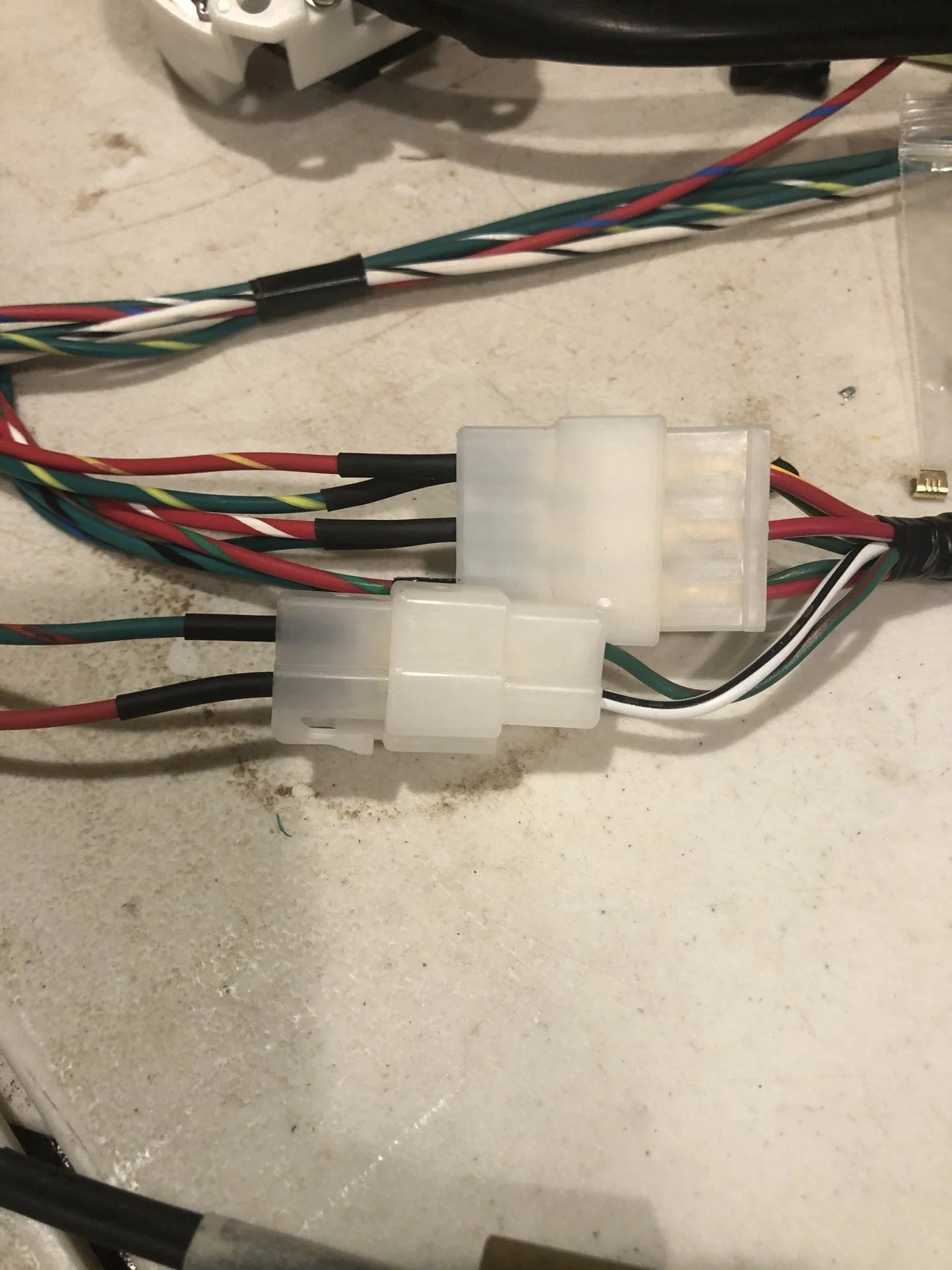

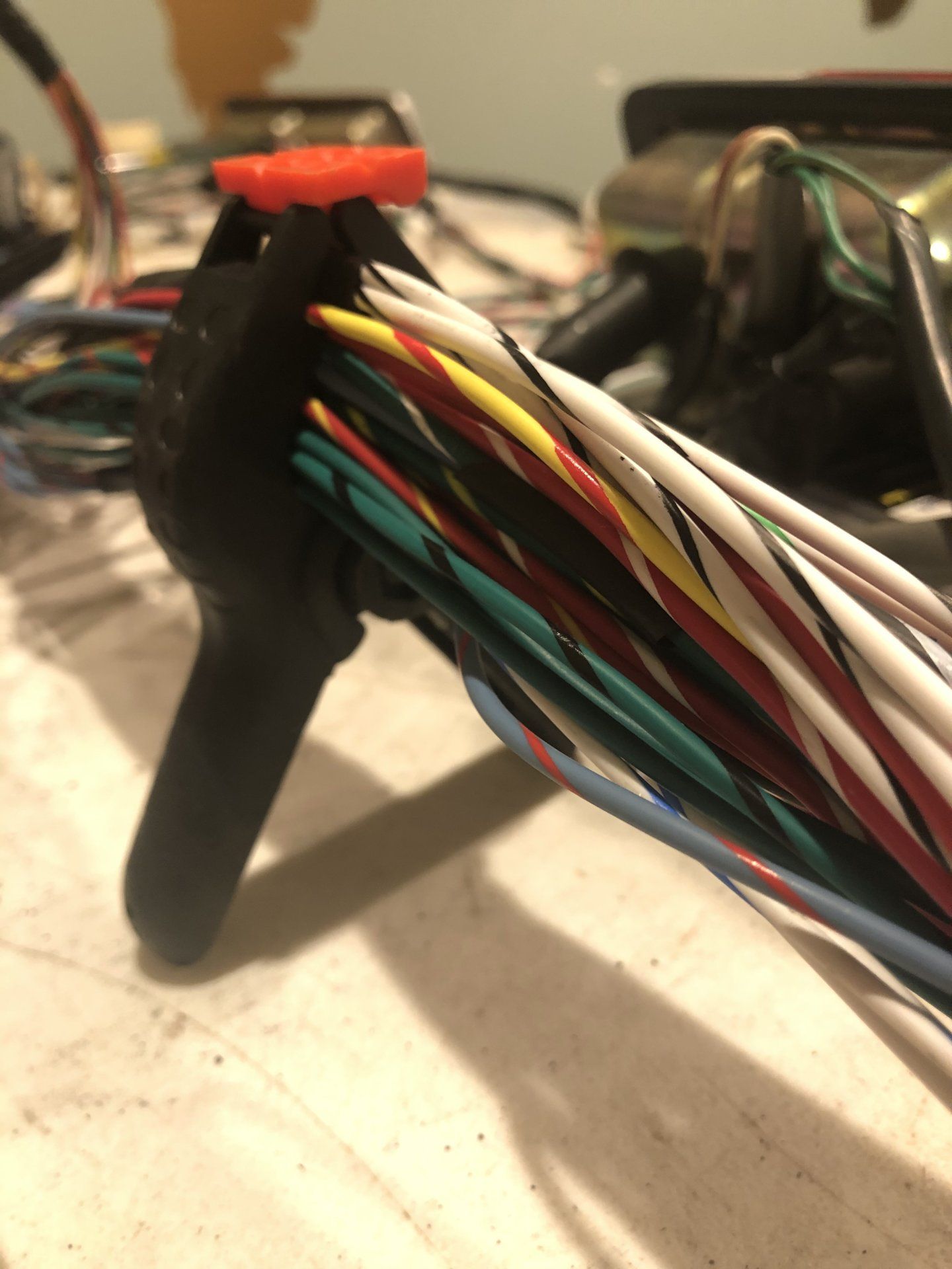

Lots and lots and lots of wiring - and everything connected to the wiring (good excuse to get new turn signals and etc....)
Many thanks to @Coolerman, @bj40green, @lostmarbles, @ToyotaMatt, @offkilter, @crawlin cruiser, @Aloha Jen
A couple pics.
ALL NEW WIRES and TERMINALS and CONNECTORS
It will be a shame to wrap all this up.... haha

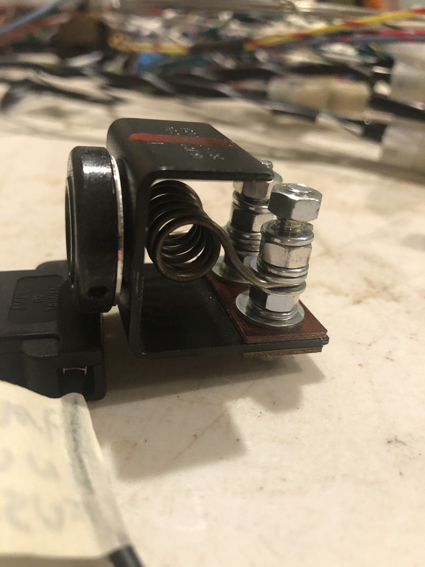

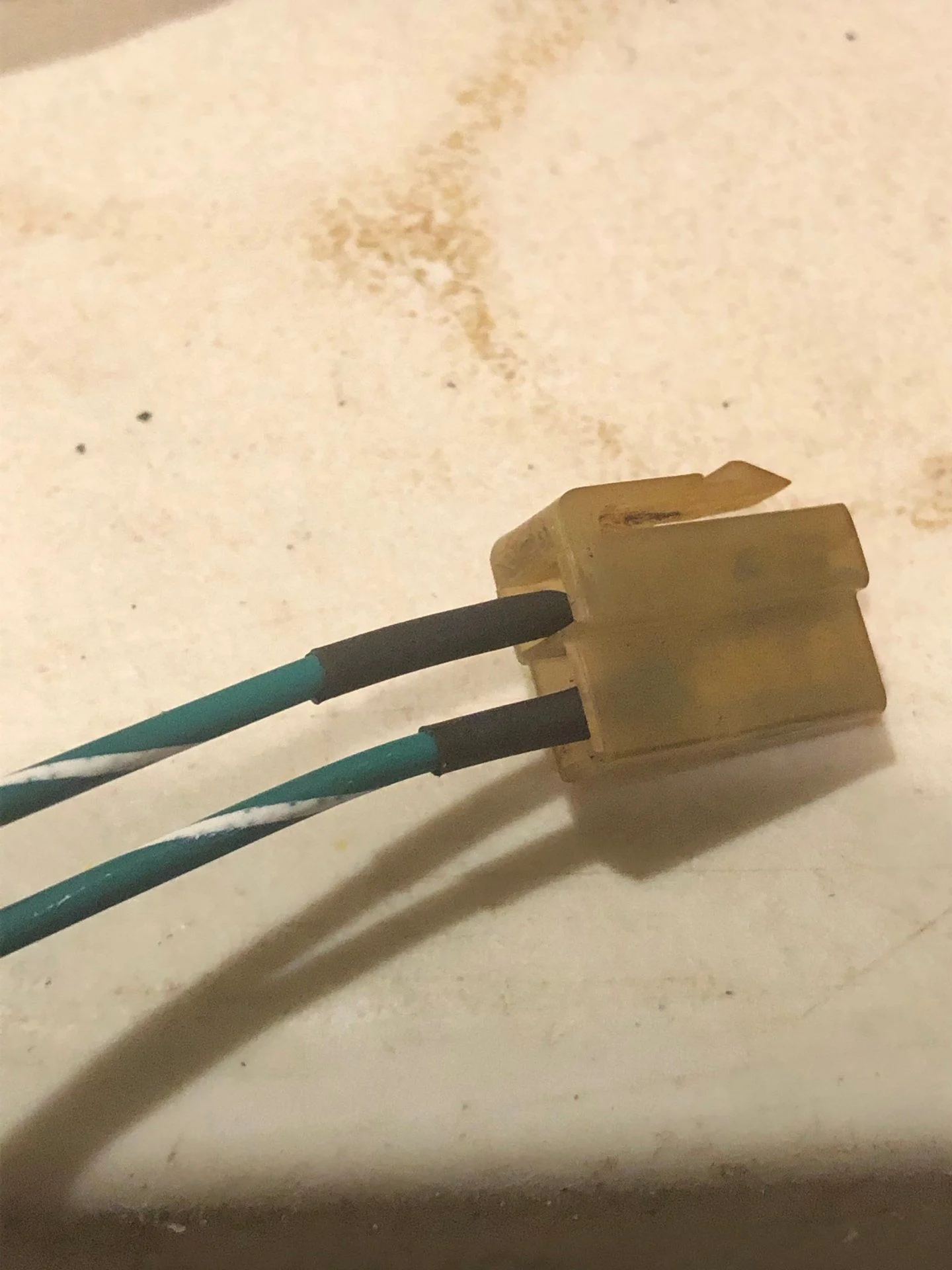

That last picture shows a real oddity though, and something that bothered me until Rudy and Mark were able to point me in the right direction.
On the wiring diagram there's a red wire that goes into the DIMMER S/W (84310-60072). That red wire provides power to the HI FLASH circuit to flash the high beams even when the headlights are off. The challenge was that I didn't see where on the DIMMER S/W, pigtail, side to hook the red wire; If indeed the W/B is a ground, there isn't a terminal to hook the R wire to. All the other wires (like in most of the rest of the harness) matched as the circuit transitioned from the harness to a switch or lamp or whatever. BUT, in this case, there is a W/B wire that feeds the power to the switch. Why in the WORLD Toyota decided to use the ground wire color (W/B) to feed 12V(+) power TO a switch is beyond me. But, as you can see, I hooked it up, and it all works as designed... so clearly that's where the red wire goes in.

The wiring harness has been the better part of two months to rebuild, but it'll last *at least* another 40 years.
A couple pics.
