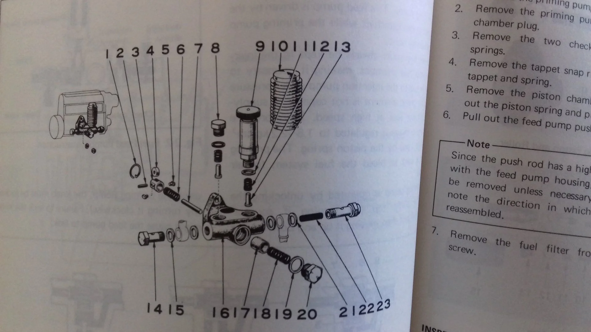

at the input of the manuel fuel pump (feed pump), you have also a filter number 22

  • Remove the lift pump from the side of the injection pump and check that when its pressed in that it springs back. Disassemble and clean whilst you have it off and replace the 4 crush washers when reinstalling

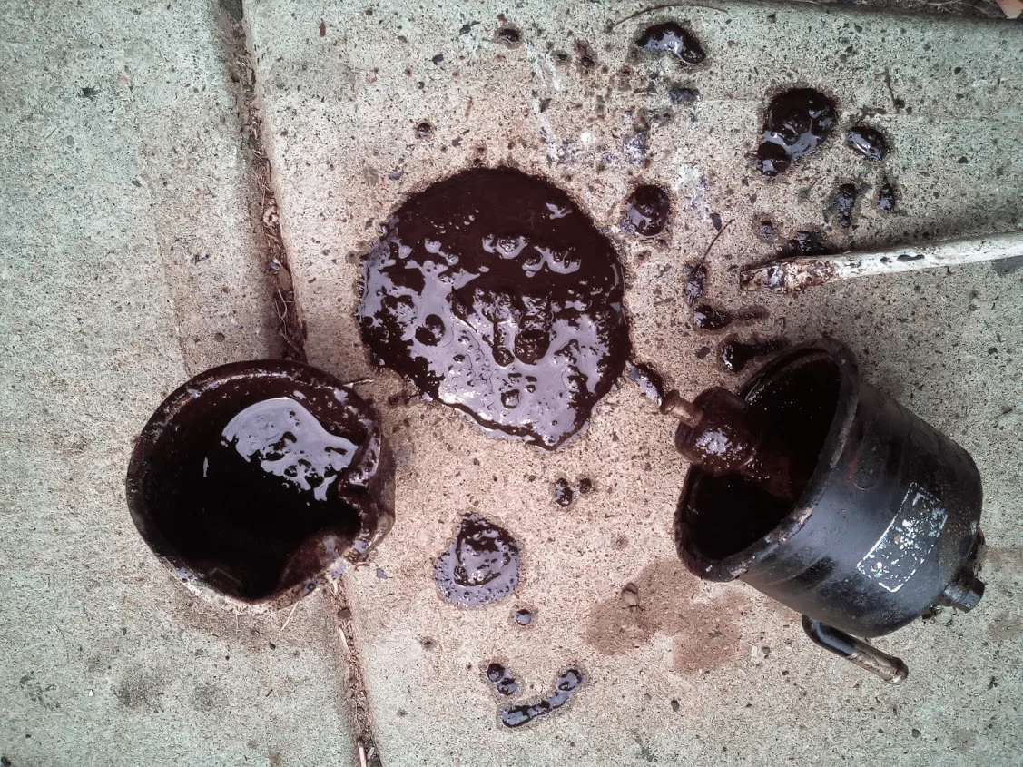

Here's what is often found inside the factory sedimenter..

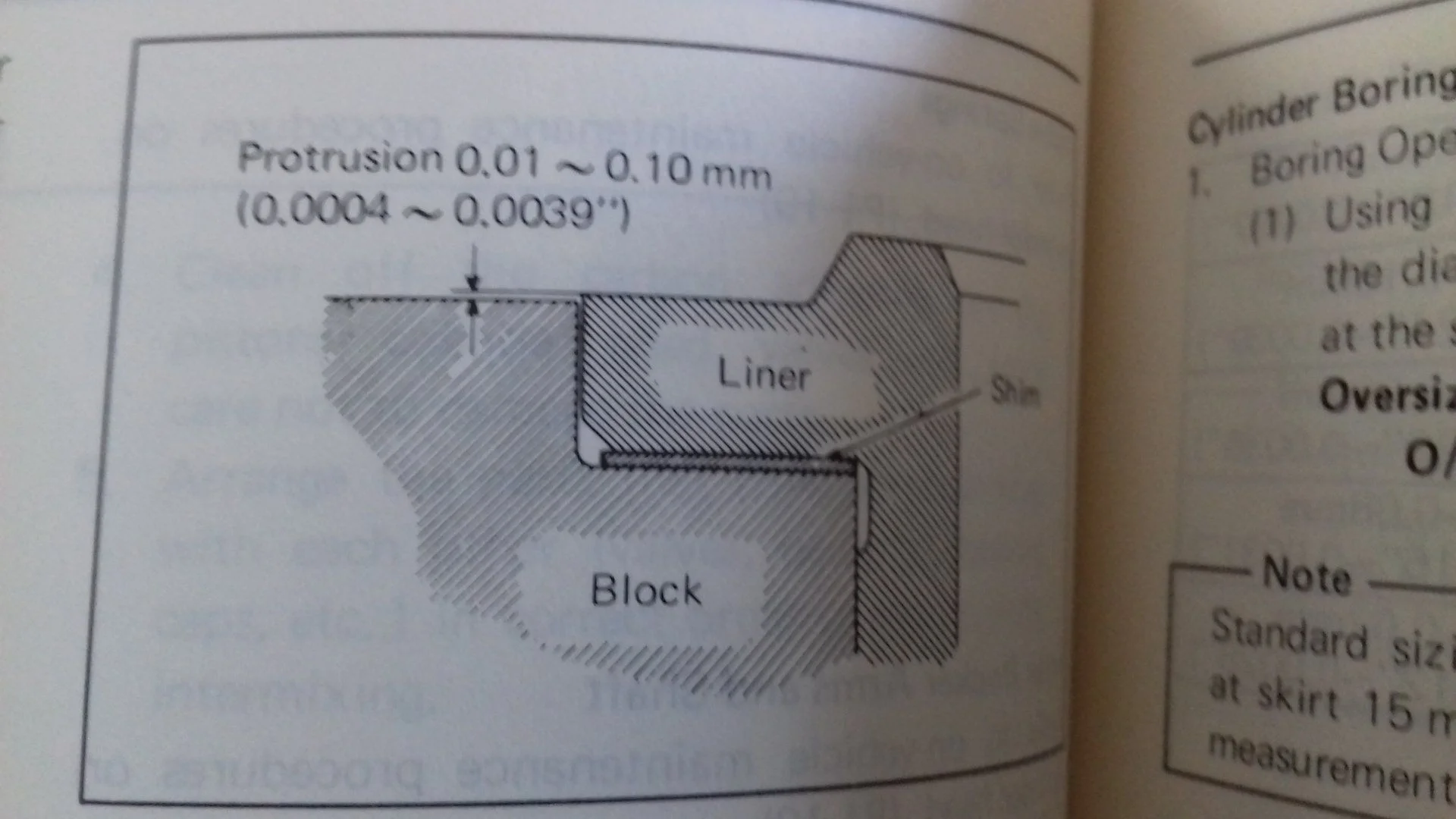

when this engine has been rebuilt is that the rating of the overtaking on the 4 engine liner has been properly controll ?
