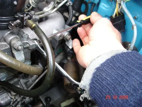

Here's a pic of where the adjustment is (in support of what Magnus_heydoc has written):
Mine's set around the FSM recommendation (625-675rpm) and it's still pretty smooth.
(Too fast and it may make it harder to shift from neutral into 1st.)

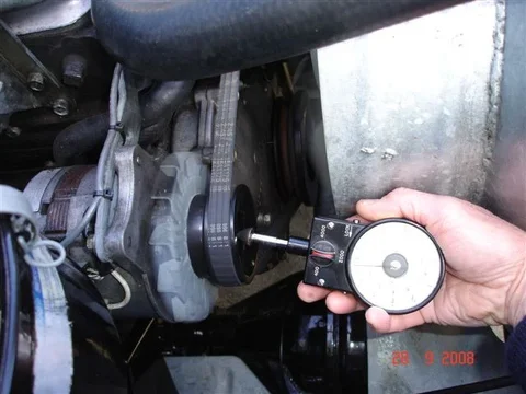

PPS. I checked my RPM by using this old Smiths Tachometer on my alternator and doing some mathematics with the results:

In the pic it's the yellow arrow, forget the red circle (not my engine)

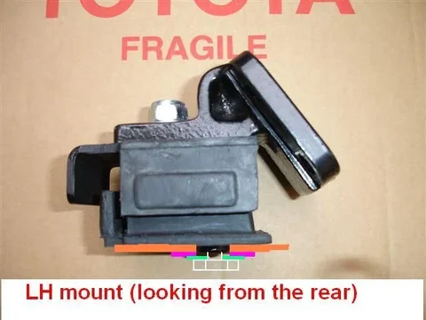

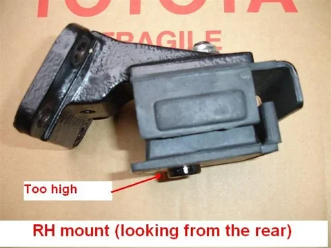

I bought some aftermarket mounts myself and found that the dimension arrowed was too large:
This meant that when you tightened the securing bolt from below, the shock-absorbing-mount wasn't gripping the chassis-mount.
I solved the problem either with a washer or by grinding ... I can't remember which.
But if your mounts have the same dimension error GoboFongo then they could be rattling from normal engine vibration making your engine idling appear noisy and rough.

Thank you so much for all the input.
I found that same thing with my mounts, and will try adding a washer there.
I'm glad I'm not the only one. These mounts were from SOR. You can see the shiny washer that I added. That sure helped with my shaking when I added the washer. I didn't notice it at first. It wasn't until I started driving that I realized how much shaking was going on.

.....I found that same thing with my mounts, and will try adding a washer there.
I've tried to show here how the washers need to be to get the mount properly clamped up:
