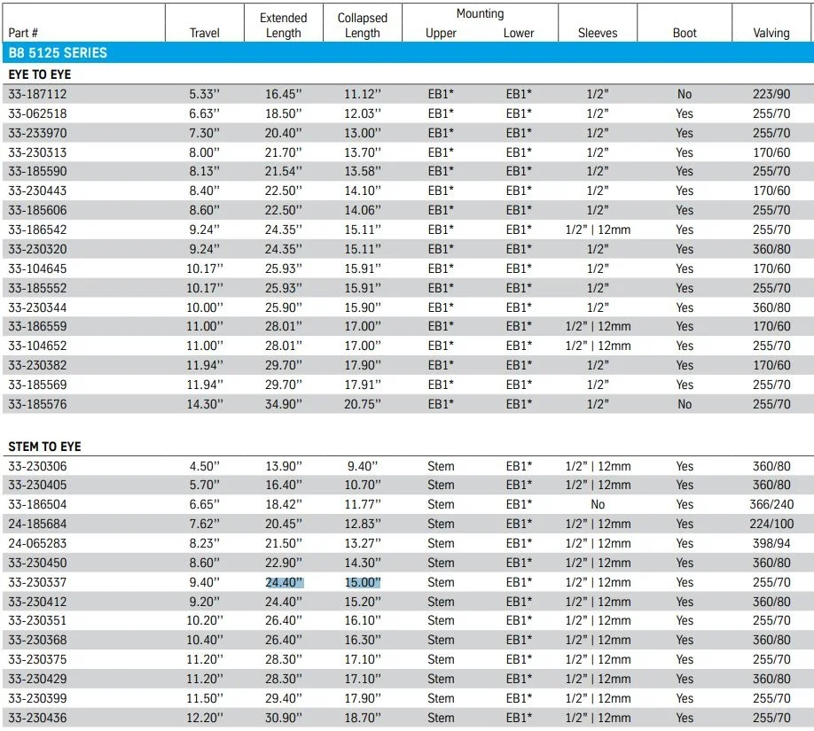

Looking for advice on Bilstein 5125 shocks to pair with iron man 2'' lift on 1987 HJ61. I have heard good things about the 5125s and they are in my budget so I am pressing with these.
Rear shocks (part number 12650GR) that come with the Ironman 2'' suspension package travel is 23.4'' to 14.3'' ... makes me think Bilstein 33-185606 is a good fit.
I am more concerned about front shocks with the heavier engine (12HT weighs around 380 kgs/830 lbs).. Front shocks (Part number 12637GR) that come with the Ironman 2'' suspension package travel 22.7'' to 13.7''... So which Bilstein would be the better fit... 33-230337 or another?
Also, are the end styles on these shocks gonna play nicely with my existing mounts?
Mind you I am thinking no aftermarket bumpers for the time being. Details came from their respective catalogue below.
Thanks for any insight.
I used Bilstein 33-230368 for the fronts and 33-185606 for the rears. I measured my suspension travel through the whole range and these neither top out or bottom out, that's with the Ironman lift I have which is 2 - 3". Fyi you also need to replace the eyelet bushings to Energy Suspension 9.8108G 3/4" shock eye bushings to fit the studs on the cruiser.
Ok, thanks for the info. I wasn't looking at those. Should only need these bushings to do the trick then?

I ended up going with the two I listed above. Fit great with the bushings mentioned. Night and day difference from what it was before with both tired shocks and flat springs replaced. I would still like to ride in someone elses 60 and compare my ride to theirs to have a gauge.
