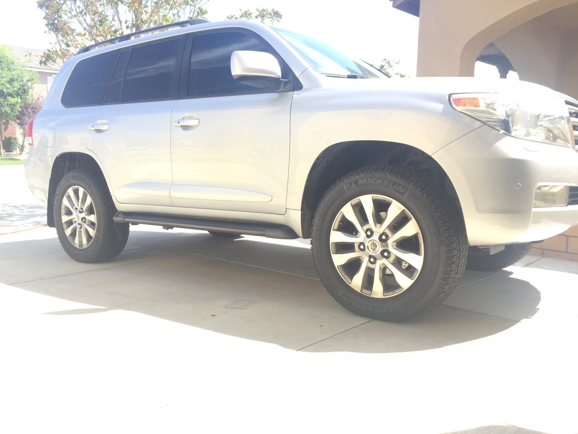

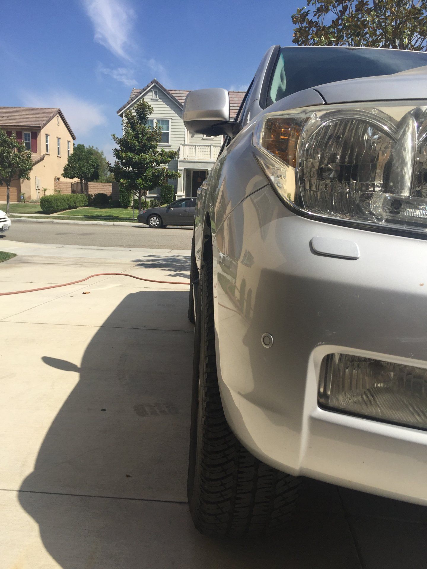

Installed the set up, along with new Mich LTX A/2 275/60/20 with 1.25 hub centric spacers on Tundra Limited rims. Slight rubbing after removing front mud guards, but will trim down the inner splash plastic.
I could not be any happier with the set up. The truck looks great and has a smooth ride. over large bumps. Tires are quiet too. The tires not the ideal off road solution but they meet our needs. 90% highway/10% desert or gravel.
The 6112 is truly a great coil over set up.. the control of the front end is amazing. The 5100 are great option compared to the OEM shocks but I think the rears need just a bigger shock overall. Maybe down the line, I will swap them out. For now, with new tires and 5100 is just about perfect.
The hub centric spacers are smooth and no vibrations. The OEM rim 60mm offset is too pushed in, with spacers makes rims look around 28mm. To me is spot on and gives an even look from a side profile view. Maybe down the line i'll switch to 18x9 with 25mm 275/70/18 Ko2.. but for now wife is happy and I'm happy.

Any pictures?
first picture I increased lighting to see the tire thread and wheel well.. Next up I plan to wrap in dark grey the door guards and part of the front bumper between the fog lights. Also in the rear between the license plate.
