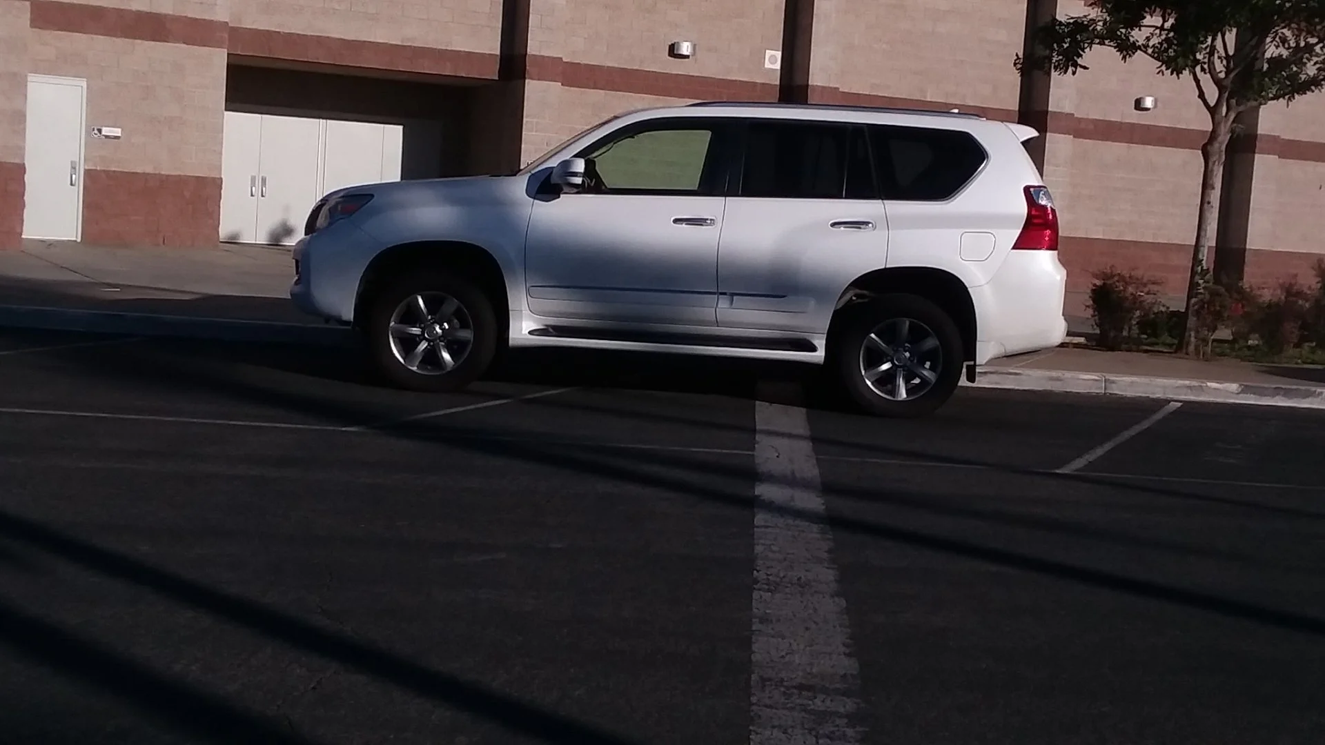

I recently installed them on 3rd ring, didnt want to get uca. I forgot to accurately measure before but I think about 1.5 was achieved. Nothing wild. Ride is a little more responsive and small bumps are transmitted more but large bumps are better dampened.
Awesome! What did you do for the rear?
Tricked the bags.

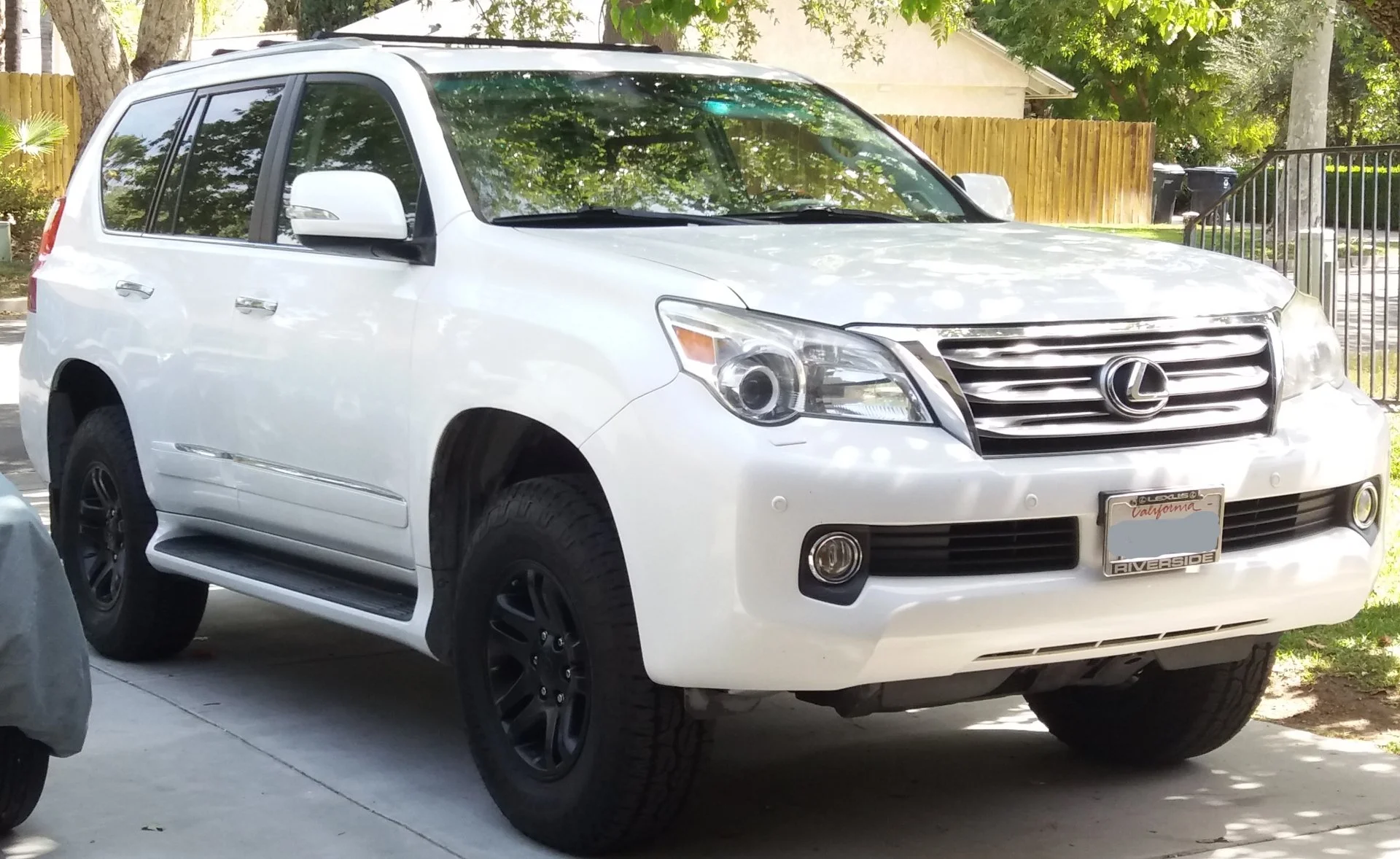

Fairly Subtle. I'll put on sequoia wheels with AT tires this weekend. Should really take off the steps too. I'll be working on the sliders.
Looks perfect and similar to what I am working on as well. No airbags on mine, but all I am going for is a mild 1.5" - 2" lift and all-terrains for casual overlanding.
Update here with pictures after tires!

Are you going to cut the steps or replace them with the Prado rockers?
