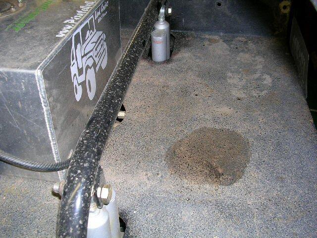

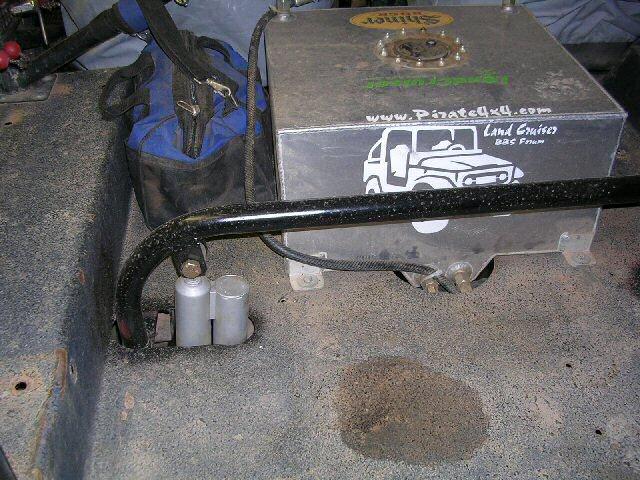

Bilstein pics from this morning...first, the rear mounting...

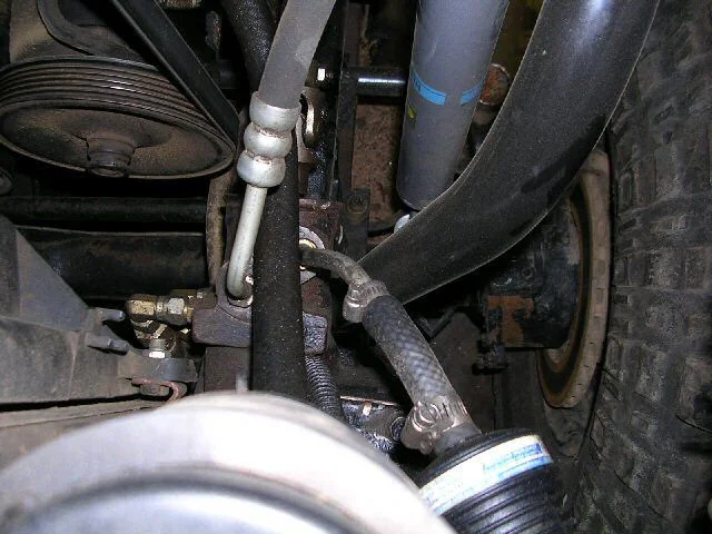

oops....first one was a straight down shot of the front towers....but ya get the idea...
These three are the front tower setups...MetalTech (helocat on the forum) bent these up and will be adding something like this to his product line. 1-1/2" DOM, .120 wall, full 180 bend. I then made the frame side mounts myself, used a 1/2" grade 8 clear thru the frame, and sleeved the frame for strength. These will also be getting tied together over the engine for additional rollover protection.

I especially like the auxillary (sp?) Shiner tank mounted by the rear shock hoop.
