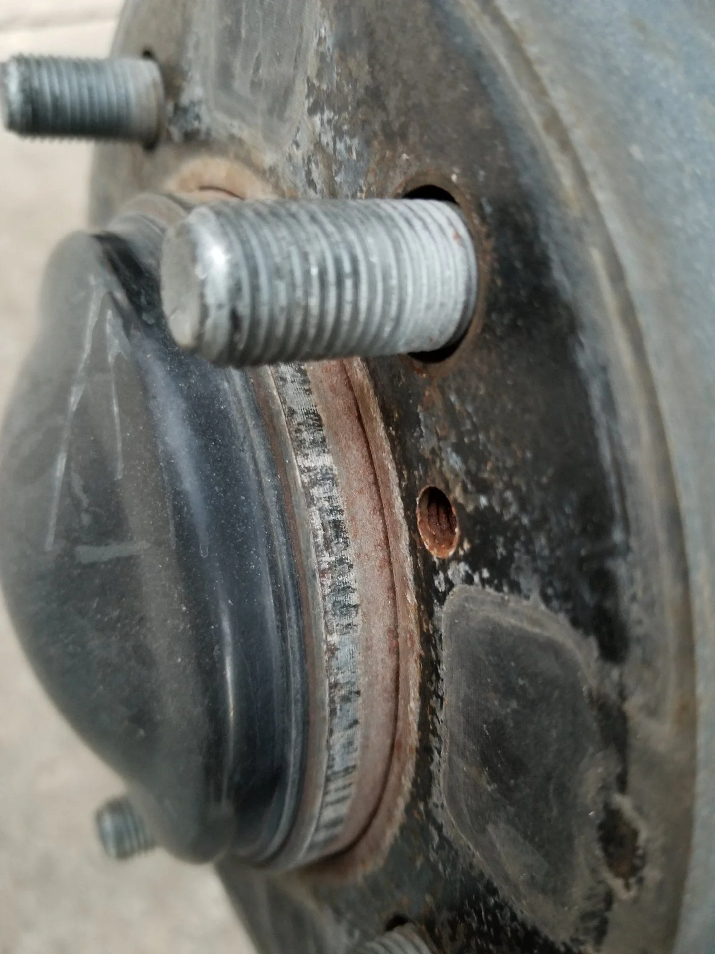

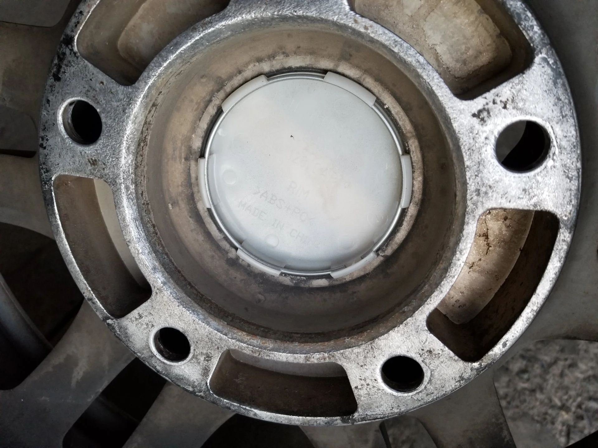

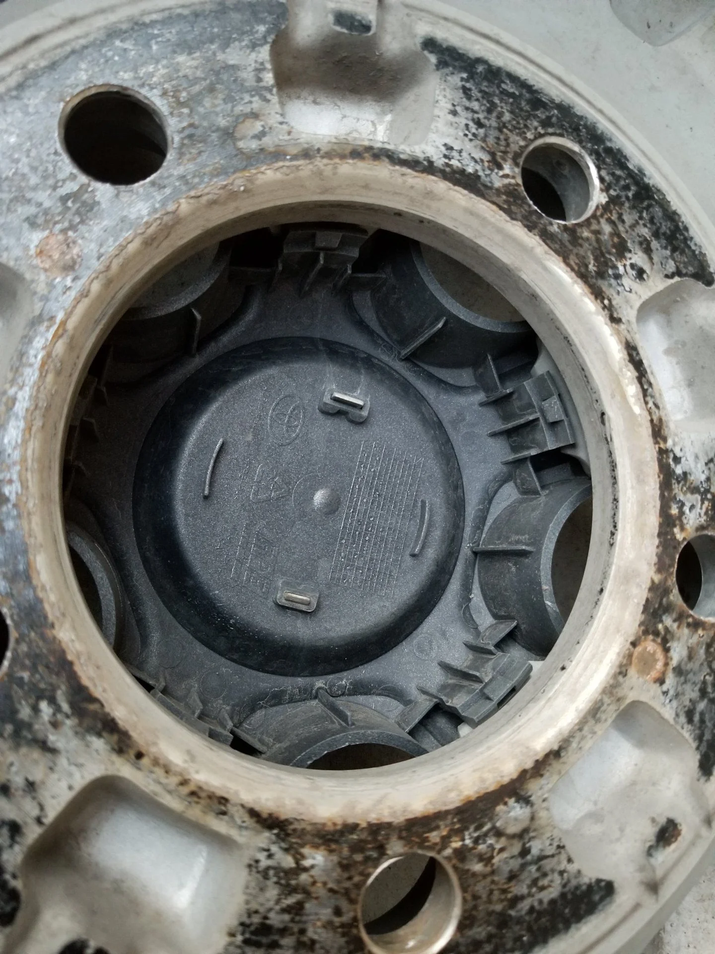

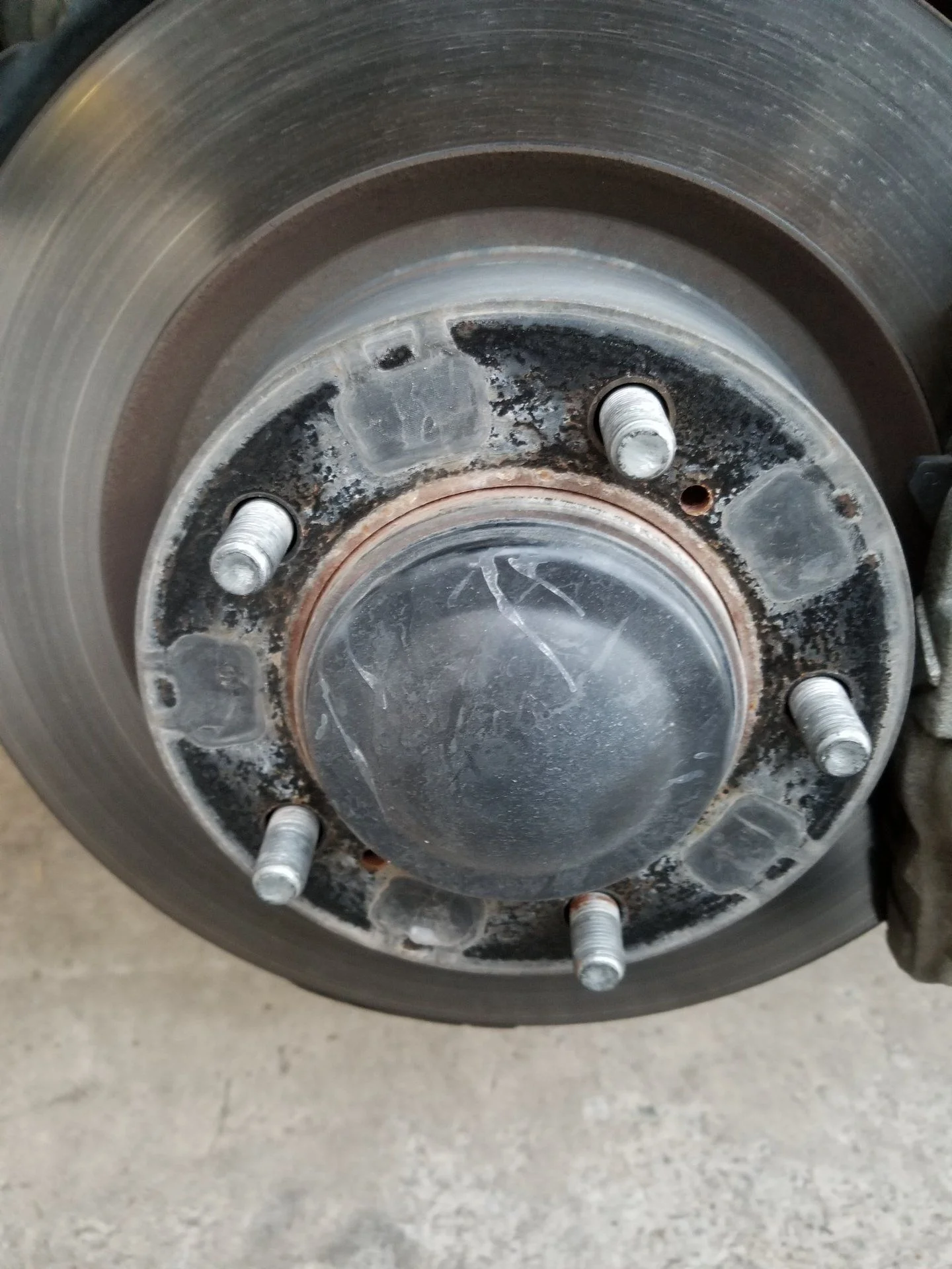

I did find an unexpected issue with the Rock Warrior fitment not related to tire size at all. When I was trying to remove the RWs, they were really stuck and I had to use a mallet to drive them off the hub. It seems this little lip sticks out just enough for the RWs to get hung on it and the factory Sequoia wheels have a little more of a bevel to accommodate this lip. Maybe this is something slightly different on the later 2nd gen Sequoia (mine is a 2018) since I've not read about anyone having fitment issues before...
I'm going to try a belt sander to open the bevel a little more and see if that solves the hub clearance issue.
