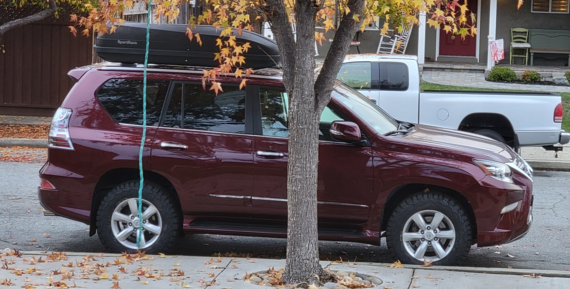

Another issue is the spare tire. You want to have the same size spare or it can cause problems. I also have 265/70/17 and a stock tow hitch. The spare would not fit without KDSS spacers.

The spacer moves the KDSS just enough to squeeze a larger tire in that space.
Going from OEM up to a 265/70/17 won't cause any issues with gearing/transmission feel. My speedometer was a little slow on the OEM tires and is now accurate per GPS after I switched to 265/70/17s. You may have to do some trimming on the back of the front fenders where the side skirt attaches to stop rubbing while turning.
If you have the OEM hitch receiver, your upsized spare tire likely will not fit in the factory tub so plan for an alternate solution like KDSS spacers, a swingout carrier, etc.
Same - it seems like my speedo is actually more accurate as well after switching.
As for fitting a spare, mine fits without modification (with Class IV OEM hitch), but your mileage may vary based on the tire you choose.
I have a 265/70/17 spare tire on an FJ Cruiser rim that fits with the IV hitch. The tire is a street tire without chunky tread, a tire with taller treads or a wider rim may not fit as well.

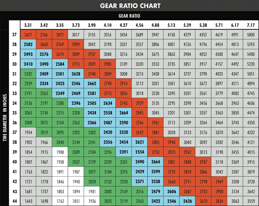

So I used the calculator @Washingtontaco provided and the difference in gear ratio is 0.141. Stock is 3.909 and with the new tires size it’s 4.05. Seems minor to me, but I’m not a mechanical engineer or expert. When is a regear needed? Is there a certain threshold in which you need one. Or once you are out of spec you should get one?
That is not much and probably negligible. Beware of tire creep!
I have OEM hitch and a brand new Wildpeak AT3W in 265/70 that fits in the spare location.
You don’t need to regear… for whatever this is worth:
Edit - just for reference, this assumes 65 mph in drive ratio (1.00, which would be 4th gear).
