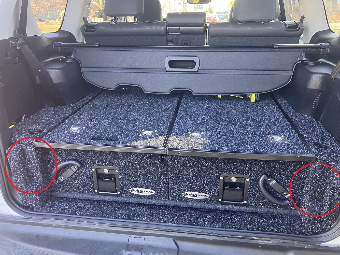

Wanted to revive this thread to say definitively that the Bison Gear table (Large) and the Dobinsons drawer system will not work together. Installed my drawers today and was disappointed to find the incompatibility. I am going to leave off the end caps on the wing kit for now and have a metal fabricator chop them down a little so there is enough clearance, I need the drawers and I am not willing to give up on the Bison Gear table because it's so good! Overall I am pleased with the Dobinsons drawers. A couple of the wing brackets had to be cut down to fit but overall it's pretty decent for $1600 shipped to my door (Thanks Camp Lolo)

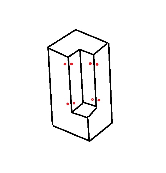

Here's how I wound up doing it, cut a notch out of both sides that were exactly the same, flipped the cutout to the opposite side and reversed it and installed it with some angled aluminum and rivets, Works perfect and now the dobinson's drawers work with the bison gear table. Very happy with the setup.
I did have to cut the carpeting in those corners and rework it to fit the new form, I used some liquid nails construction adhesive and it's holding up really well.

That's EXACTLY what I needed to see! Thank you so much!
