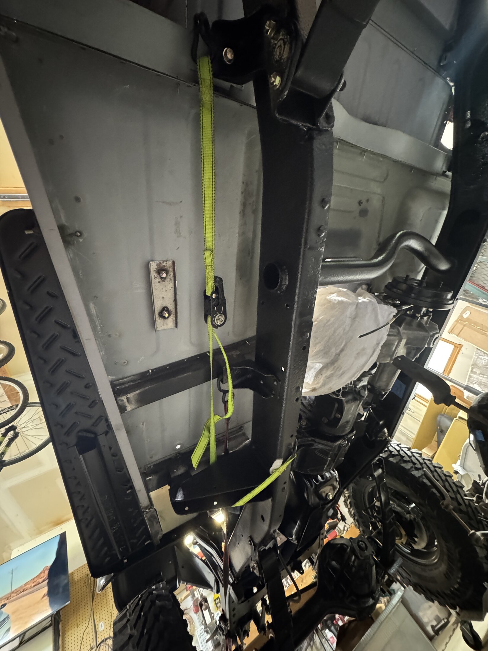

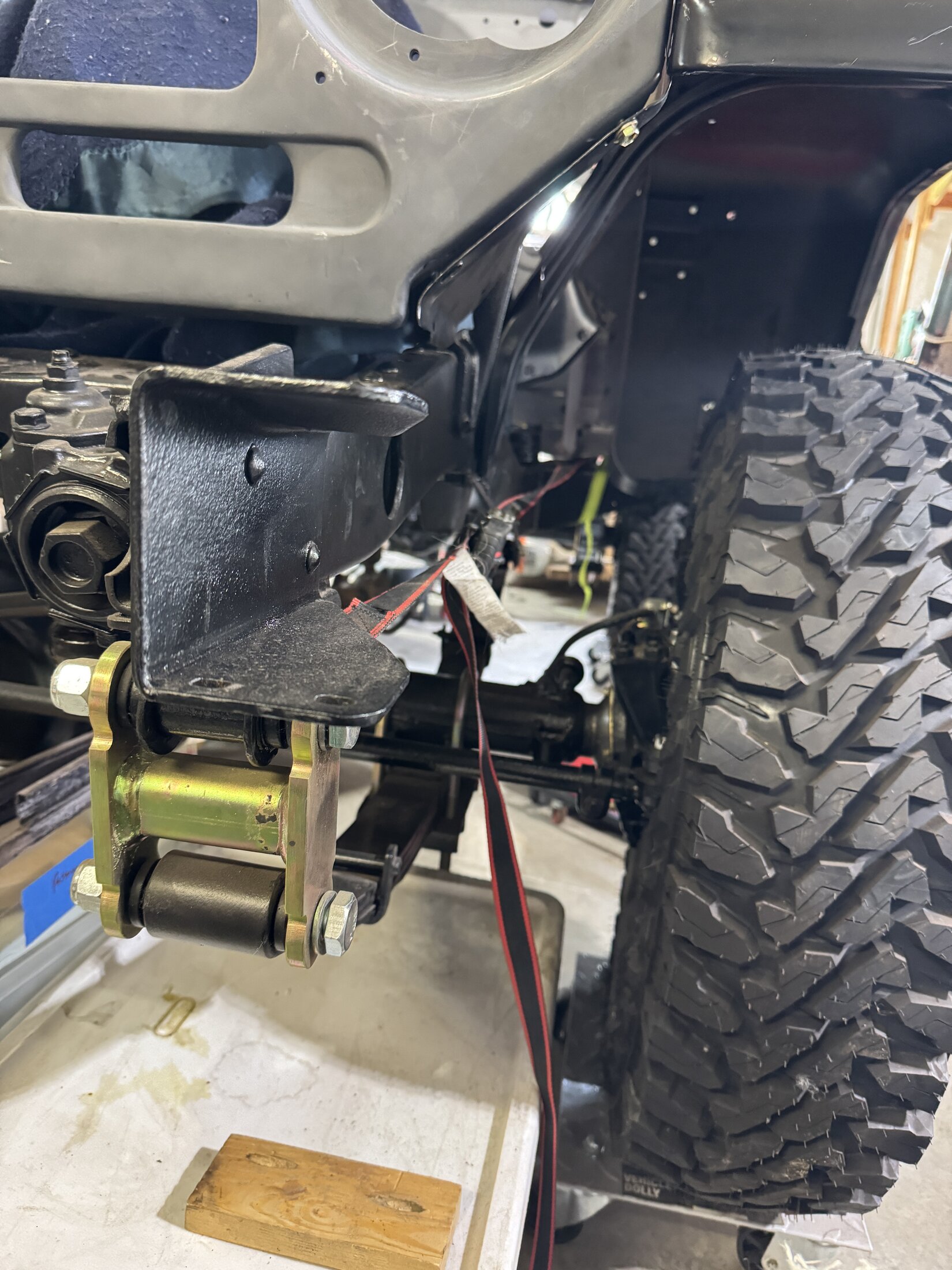

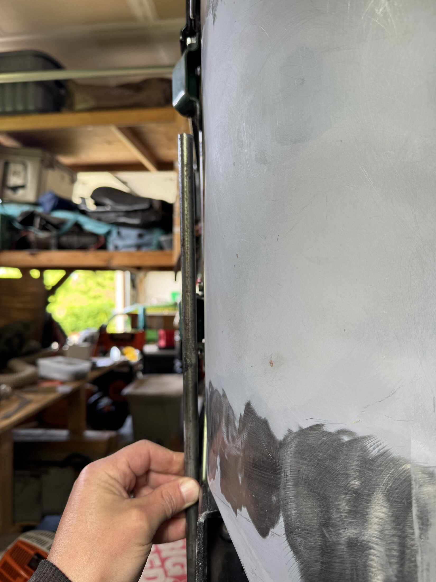

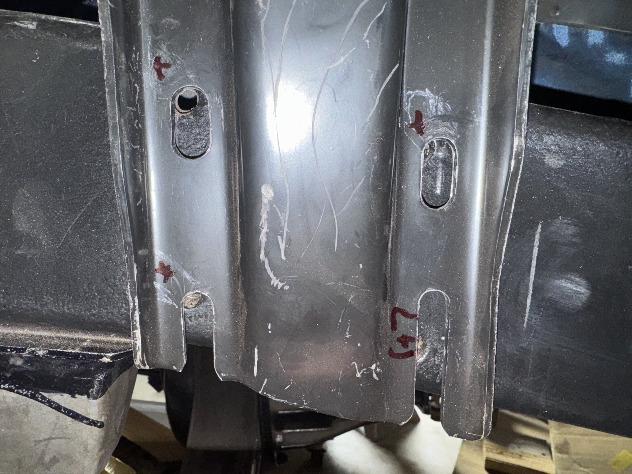

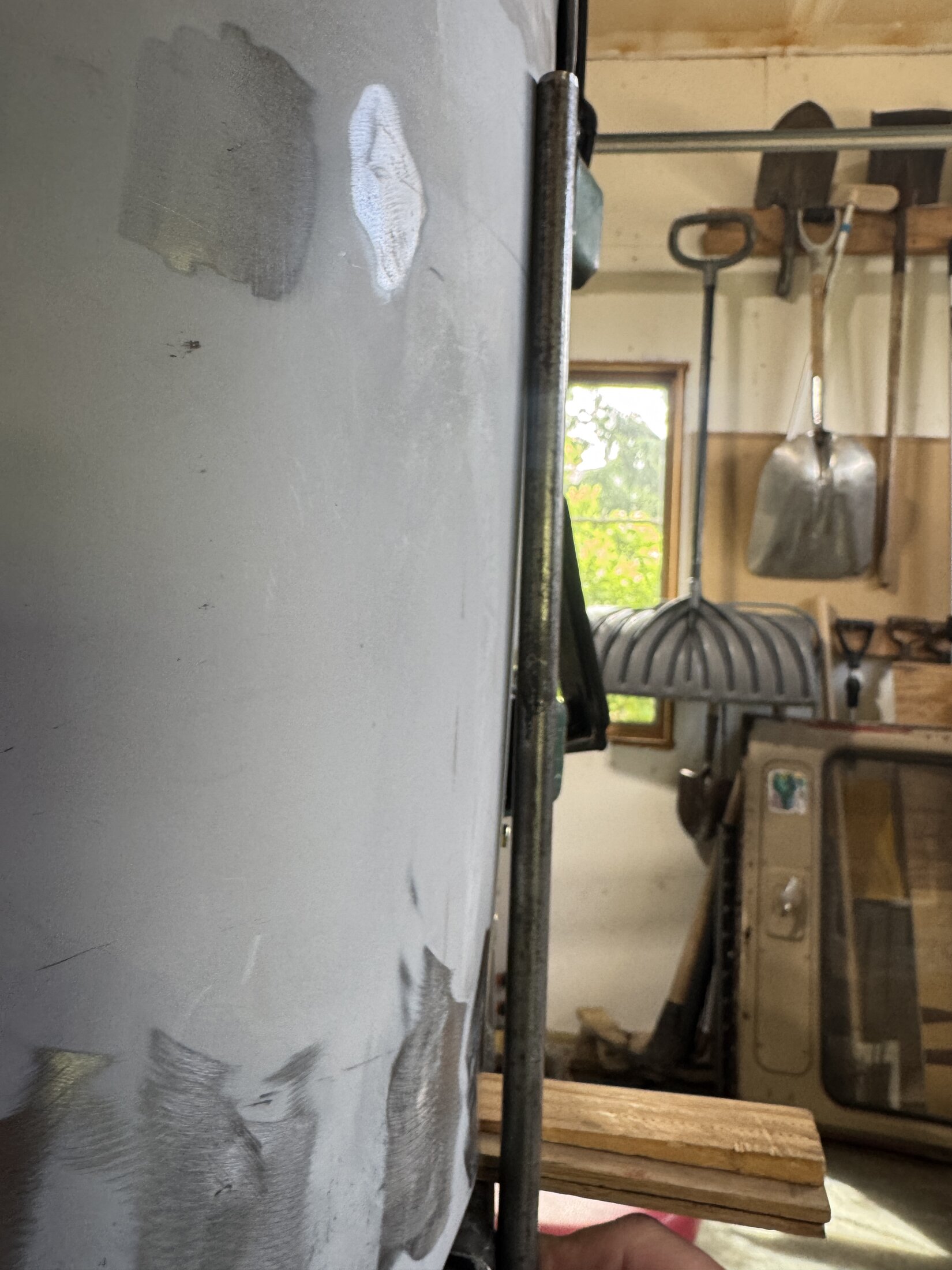

Here’s another trick I figured out today. Lots of measuring as I reworked the entire body, just not the front firewall.
Figured out rear body line was off by eyeball, measured and sure enough needs to go forward on driver side.
Measurement front frame diagonal to body also off 1/4”… at one point this had to be square as its engineered vs full custom.
SO, employed some persuaders to help me position.
This got me close enough that I’m not drilling spot welds or hogging out slots.
Rear still slightly goofy but I’ll accept that due to my handiwork.
