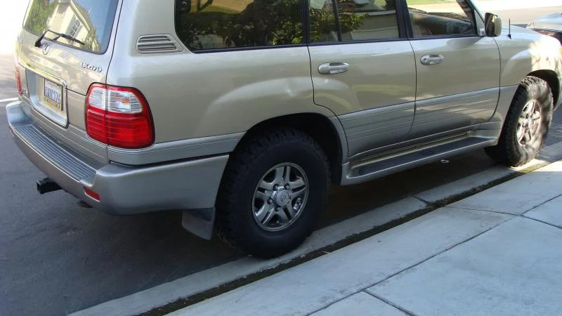

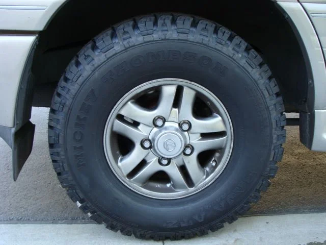

I recently purchased a set of Baja ATZs for my 2002 LX470. Tough, good looking tires.
