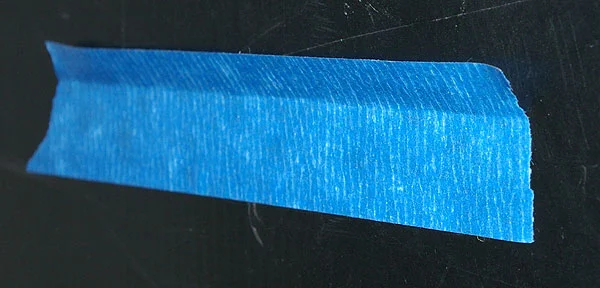

If I were to to do it, I would use a technique called back taping. Fold about a 1/4" of the masking over on it's self so that the adhesive is up, mask the area with the folded side towards the damage, then fold the tape back over, but leave it sticking up about 30 degrees (see pic). If it's just a small spot, you can just rip, tear, cut a hole about the size/shape of the damaged spot in a sheet of paper, hold it about 1/4" from the surface and spray through the hole.
If you mask to the surface, the paint will have a hard line, bump at the edge. By using one of these techniques, the line will be much softer and my not need any or much less blending.

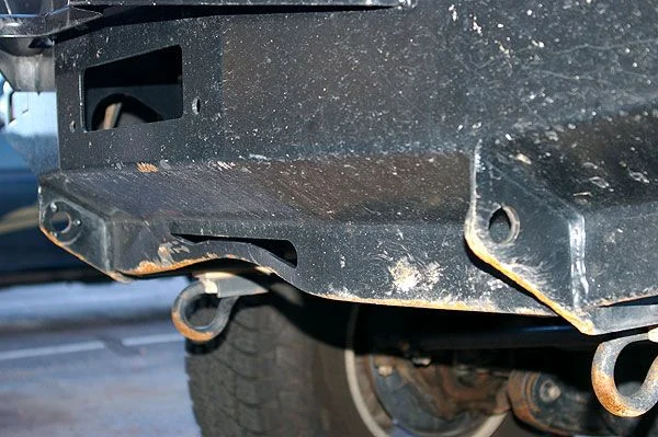

For my big ol' POS ARB bumper, after each wheeling trip it gets careful detailing. Here is a pic to show off my handy work!:o:hillbilly:
