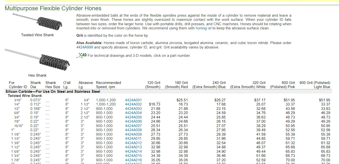

McMaster Carr has these honing things, what do you think? Buy two or three diff grits? Do I use any kind of abrasive media for this process given how hard SS can be?

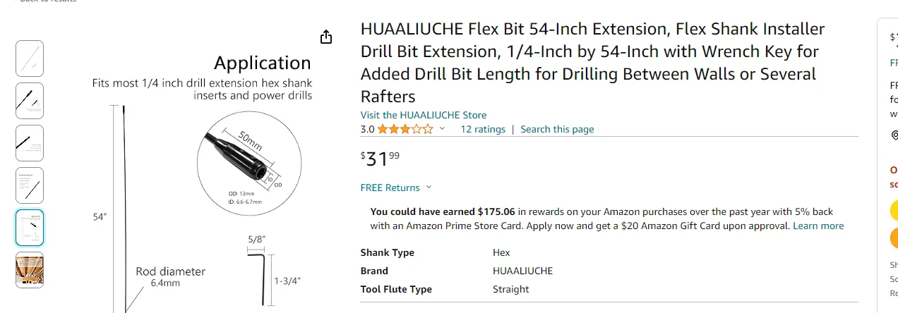

The pipes are 36" long and I found a drill bit extension that might work with the shank diameter of the hone from McMaster Carr.

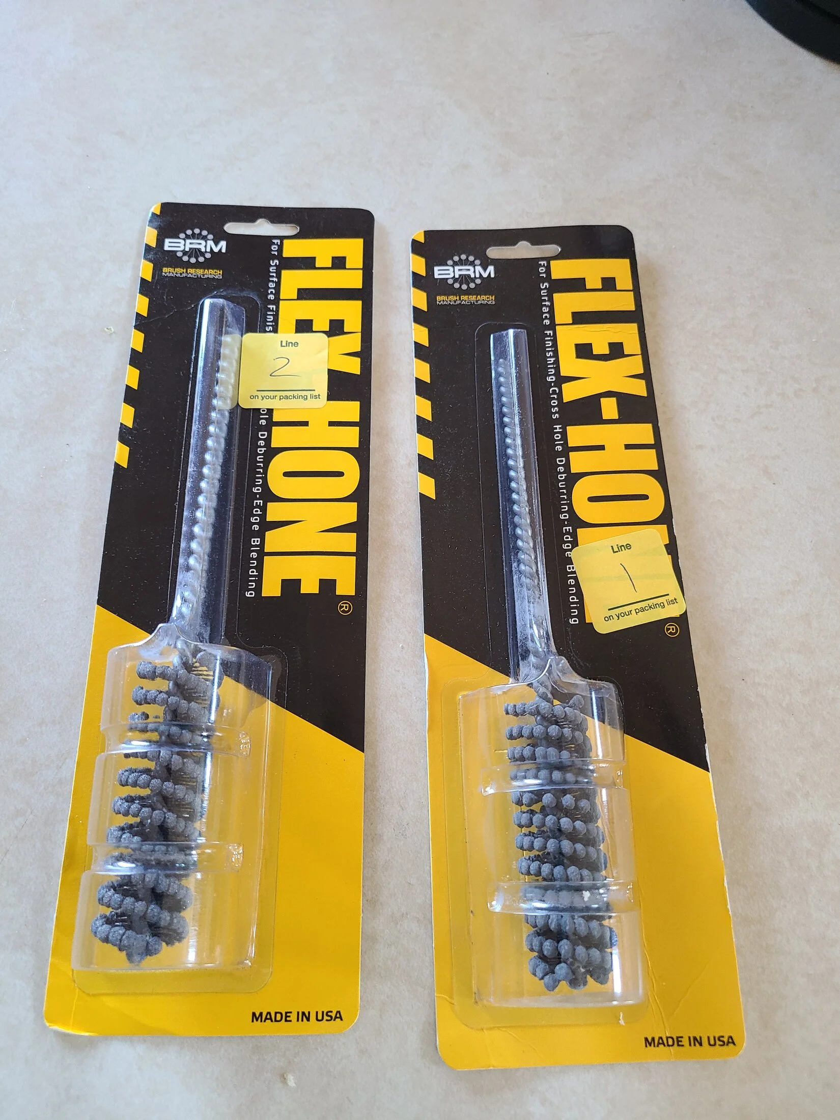

Cool, I got some and will try them out with cutting oil. Thx!!
